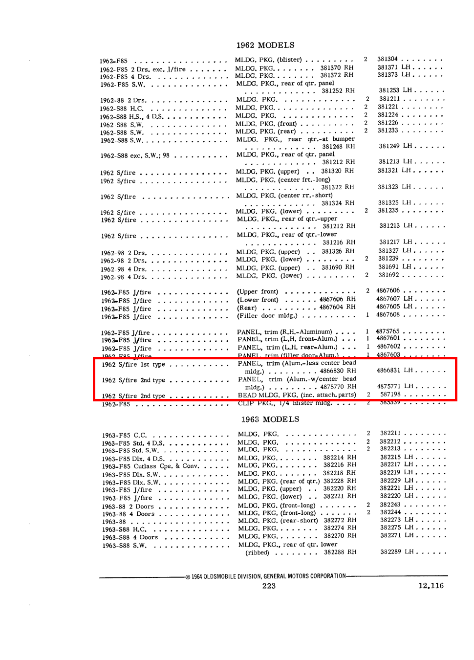

The center bead was a mid-year addition. The factory parts book shows the aluminum side panels as "first type, less center bead" and "second type w/center bead". Yours must be an earlier build car.

The first run 1962 Starfires came with panels that had no bump strip. After Olds replaced many panels under warranty they installed the bump strip. You have a pretty rare car there. Need a pic of the hood posted.
