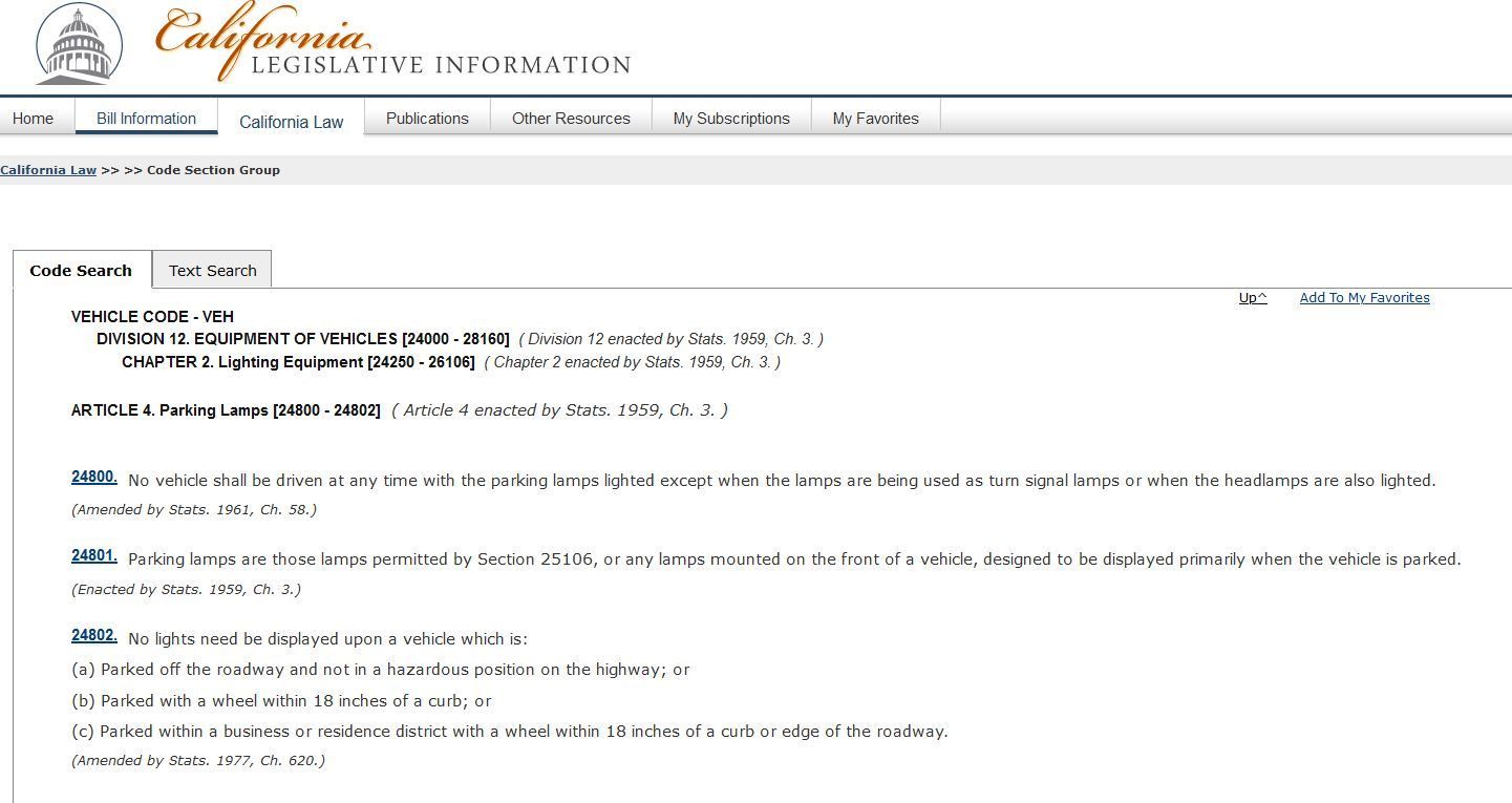

Check out the very last entry on this page.
https://driversed.com/driving-inform...le/lights.aspx
Parking lights are located at the front and back of your vehicles; they are white or amber in the front and red on the back. All of them must be visible for 500 ft. It is never legal to drive with your parking lights on; they are only to be used during parking.
Old Dec 9, 2020 | 09:02 AM
jaunty75's Avatar
Posts: 15,200
From: southeastern Michigan
It's illegal in California. My guess is that it's illegal in most states. Not that it's enforced much if it is illegal in a particular state.
https://leginfo.legislature.ca.gov/f...=2.&article=4.
