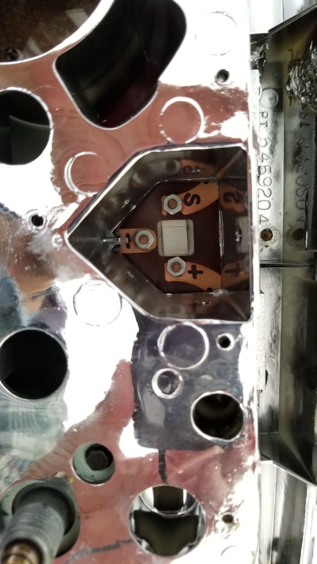

What connects the fuel gauge pins to the circuit board?
I don't remember how it went together. I don't seem to have any extra parts that could fit the task. Is there some kind of socket that connects directly to the wiring harness?

The screw in the second picture is used to hold the board on at the fuel gauge. they connect the board to the three metal pieces that the fuel gauge is attached to from the front side.

Thanks. Someone bent one of the... connectors?... that connects the screw to the gauge. I tried to straighten it out as best I could. I hope it makes contact. You wouldn't happen to have photos of all the screws in place in the back of the instrument bezel, would you?
