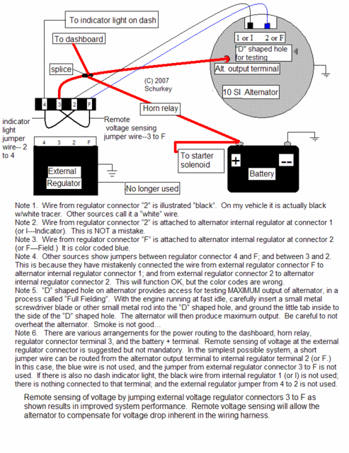

Scrap the external-regulator alternator. Install a 10- or 12-SI internally-regulated alternator. You'll get better charging especially at idle and the newer alternator looks very much like the old one. An internally-regulated alternator from a '73--80-ish car should be OK as long as it's clocked properly and not one of the huge-case 27-SI units used on high-amperage applications. Something in the 60--80 amperage range should be suitable.
The swap couldn't be easier. Make two, three-inch jumper wires with female blade terminals, buy an alternator pigtail with the alternator. The old alternator plastic wiring connector has two blades side-by-side, parallel, like this " | | ". The newer, internally-regulated alternator has two blades, side-by-side, in-line, like this " _ _ ". therefore you need an updated molded-plastic connector which gets soldered into the wire harness.
I understand that sourcing parts will be more difficult for you.
If the internally-regulated alternator you buy isn't clocked properly for your application, four bolts can be removed, the alternator re-clocked, and then reinstall the four bolts. SOMETIMES you'll need to pull the rear housing completely off to re-position the brushes (use a toothpick or an aerosol-can "straw" to hold the brushes, reassemble, then pull the toothpick or straw out of the brushholder from the rear.
