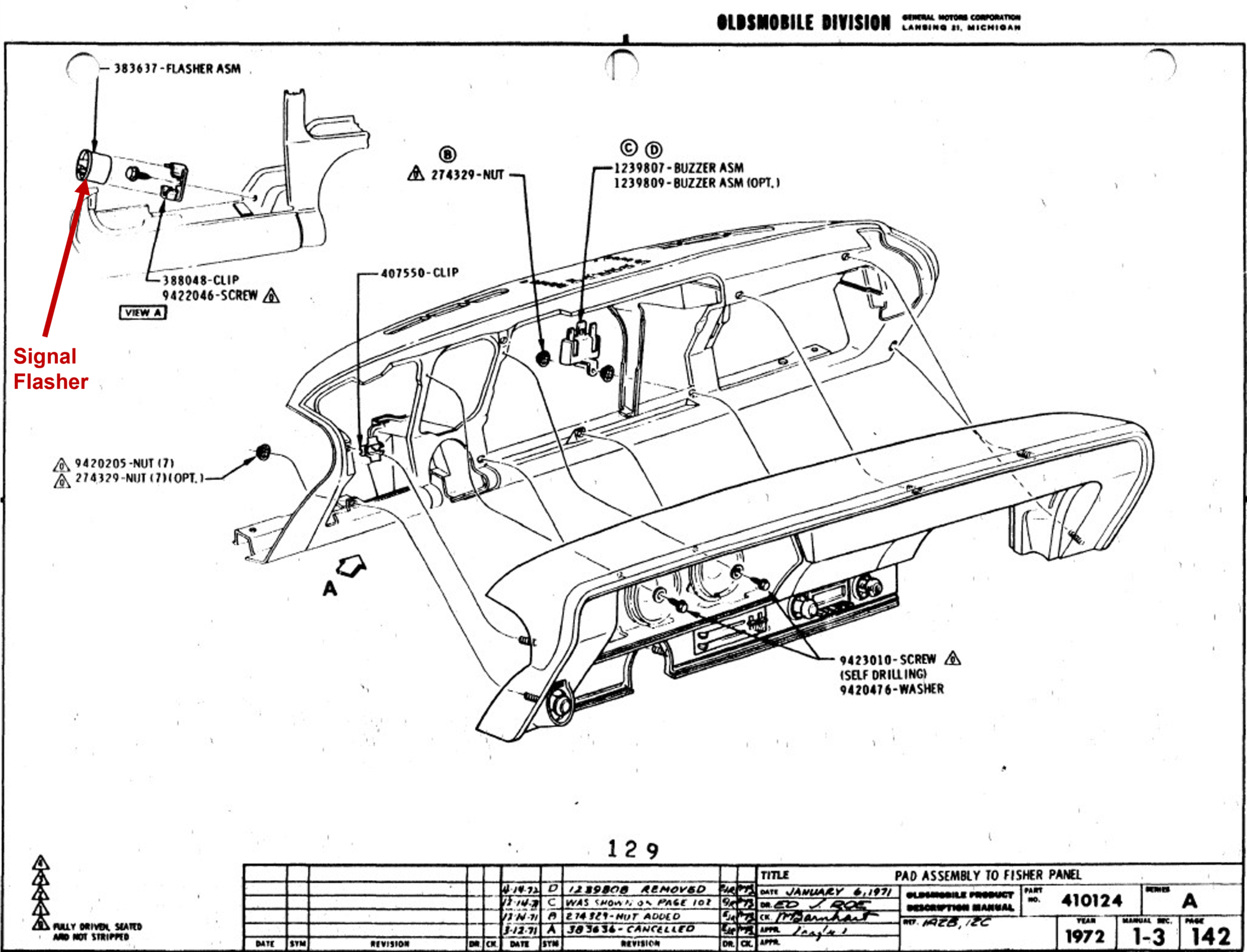

Which flasher did you replace? The one in the fuse block or the one under the dash beside the steering column?
Fuse block = 4-way hazard flasher
Under dash Steering column = turn signals

I replaced the one in the fuse block
Old Jun 15, 2022 | 05:36 PM
Posts: 26,049
Wrong one

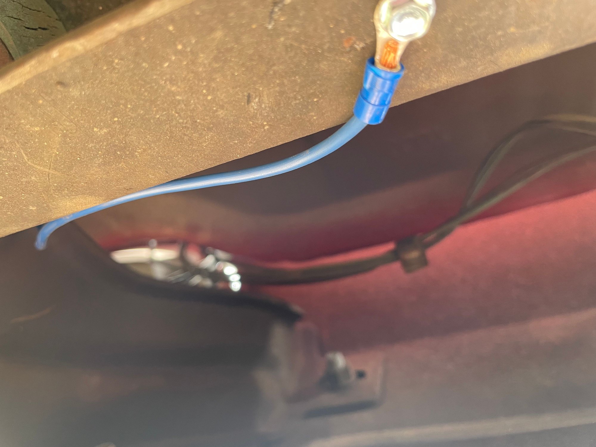

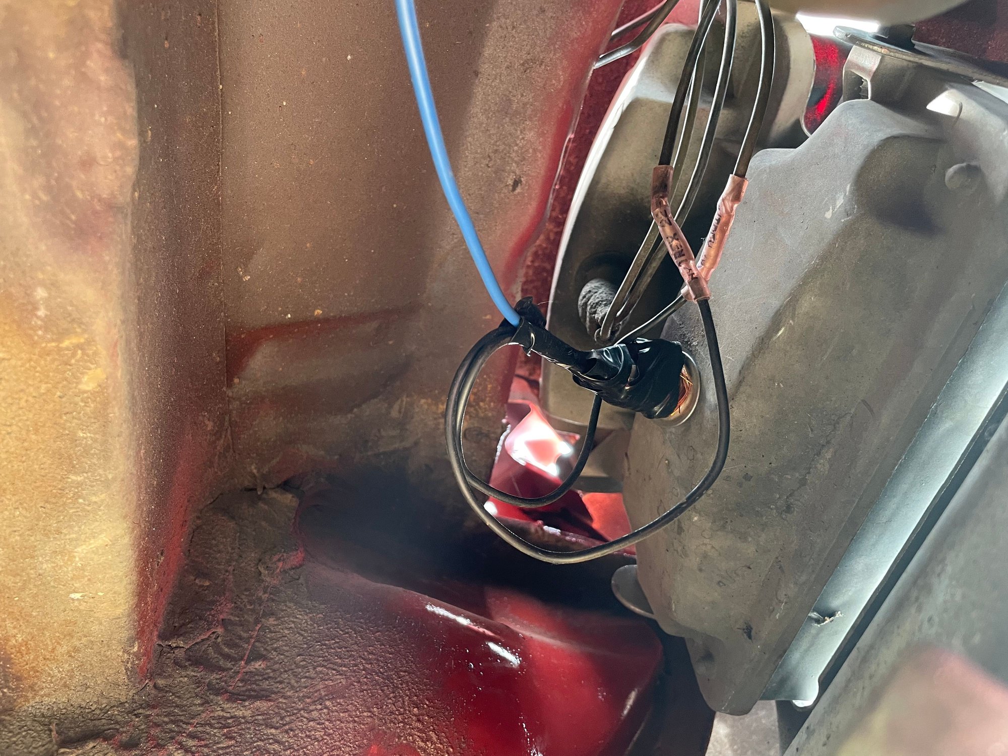

Old Jun 30, 2022 | 11:55 AM
bobs72's Avatar
Joined: Jun 2019
Posts: 232
From: Spring, summer South Dakota otherwise Texas
My buddy added this additional ground and solved the issue. I tried and it didn’t work, tells you all you need to know about my skills
