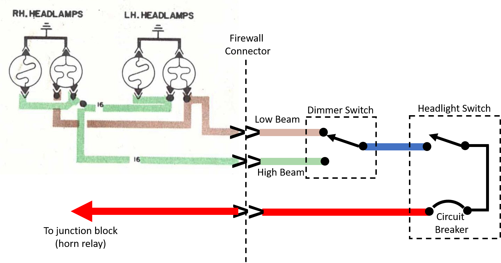

If the high beam filaments in the low beam bulbs are working, chances are both high beam bulbs are burned out. There's one wire that runs from the firewall connector to the LH low beam bulb. That wire is spliced at the plug with one wire running to the LH high beam and one to the RH low beam. The RH low beam feeds the RH high beam. If that splice were bad, the high beam filament in the RH low beam bulb would not work. Each high beam bulb has a ground wire that runs to the core support, but again the ground point for the high beam and low beam bulb on each side is common, so it is very unlikely that the ground would be bad (but not impossible). My money is on the bulbs.
