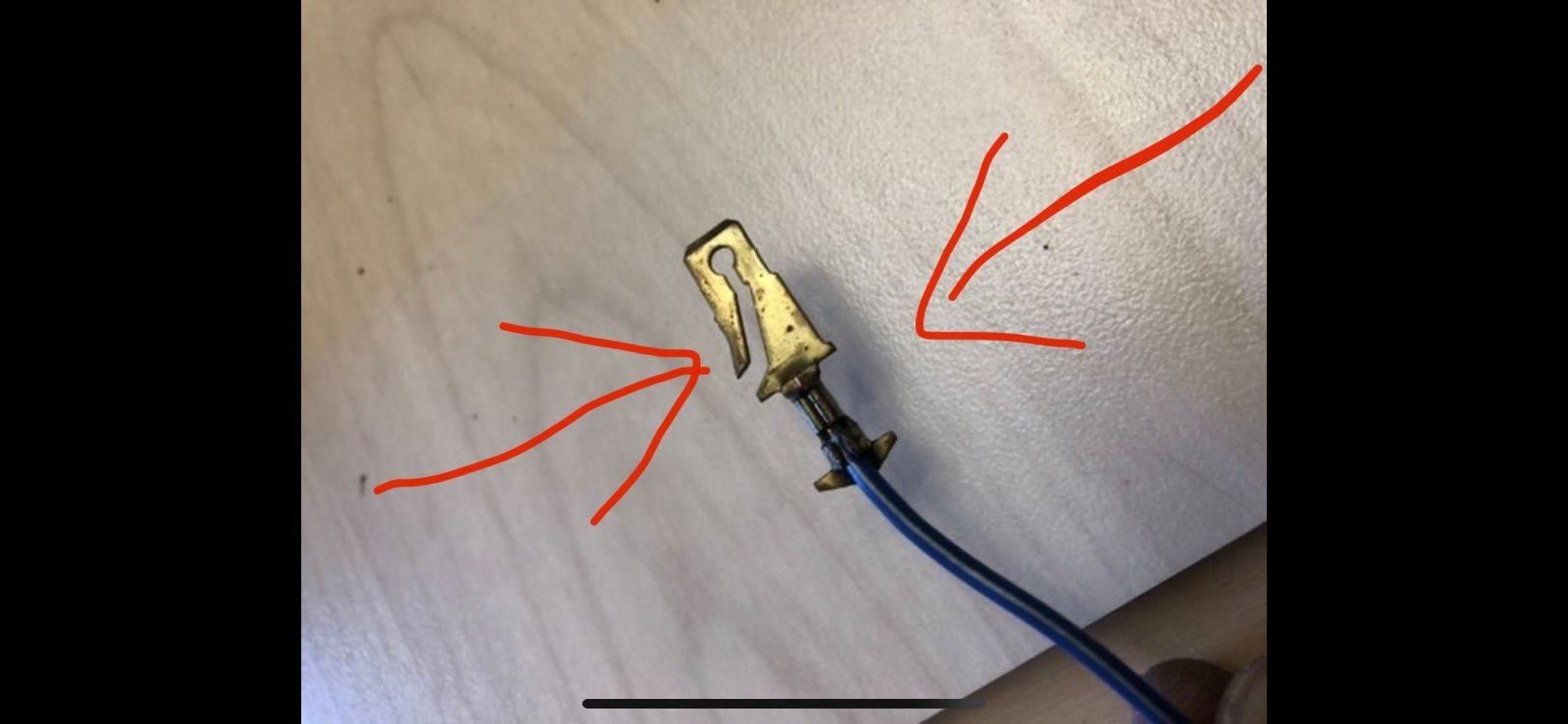

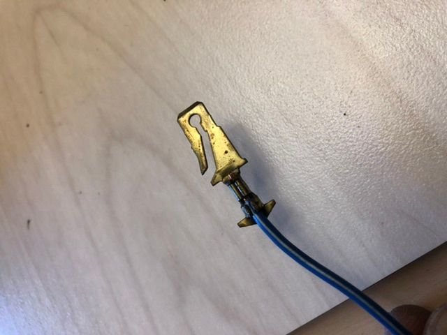

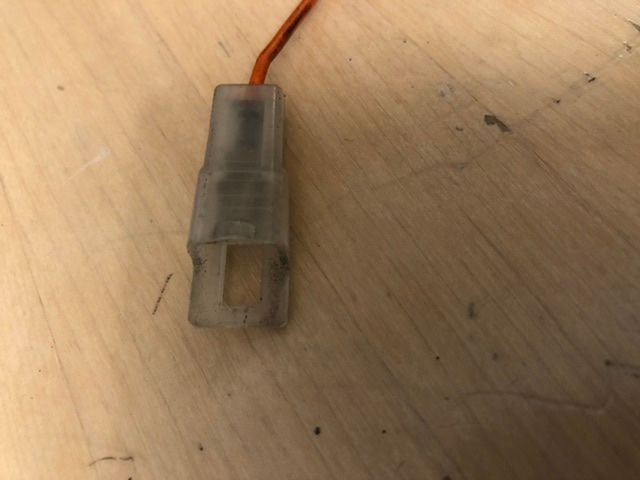

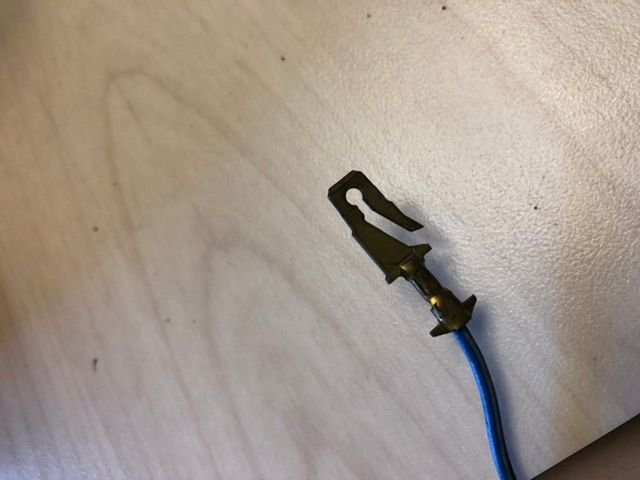

Looking for advice on pulling a connector from its plug housing. I can usually stick a very small screw driver into the housing to separate the connector but I’m having a hard time getting this out. I provided two pictures of the connector that I’m trying to get a plug housing for and a second set of pictures of the plug housing I’m trying to separate from it’s existing connector.

You need to squeeze the sides to make it small enough to fit through the slot in the plastic.

You should be able to slide a small screw driver in the open end of the terminal shown in your third photo and apply enough pressure to close the gap of the wire connector... I use a set of tools similar to the ones referenced above...

That worked squeezing the sides - thank you!
