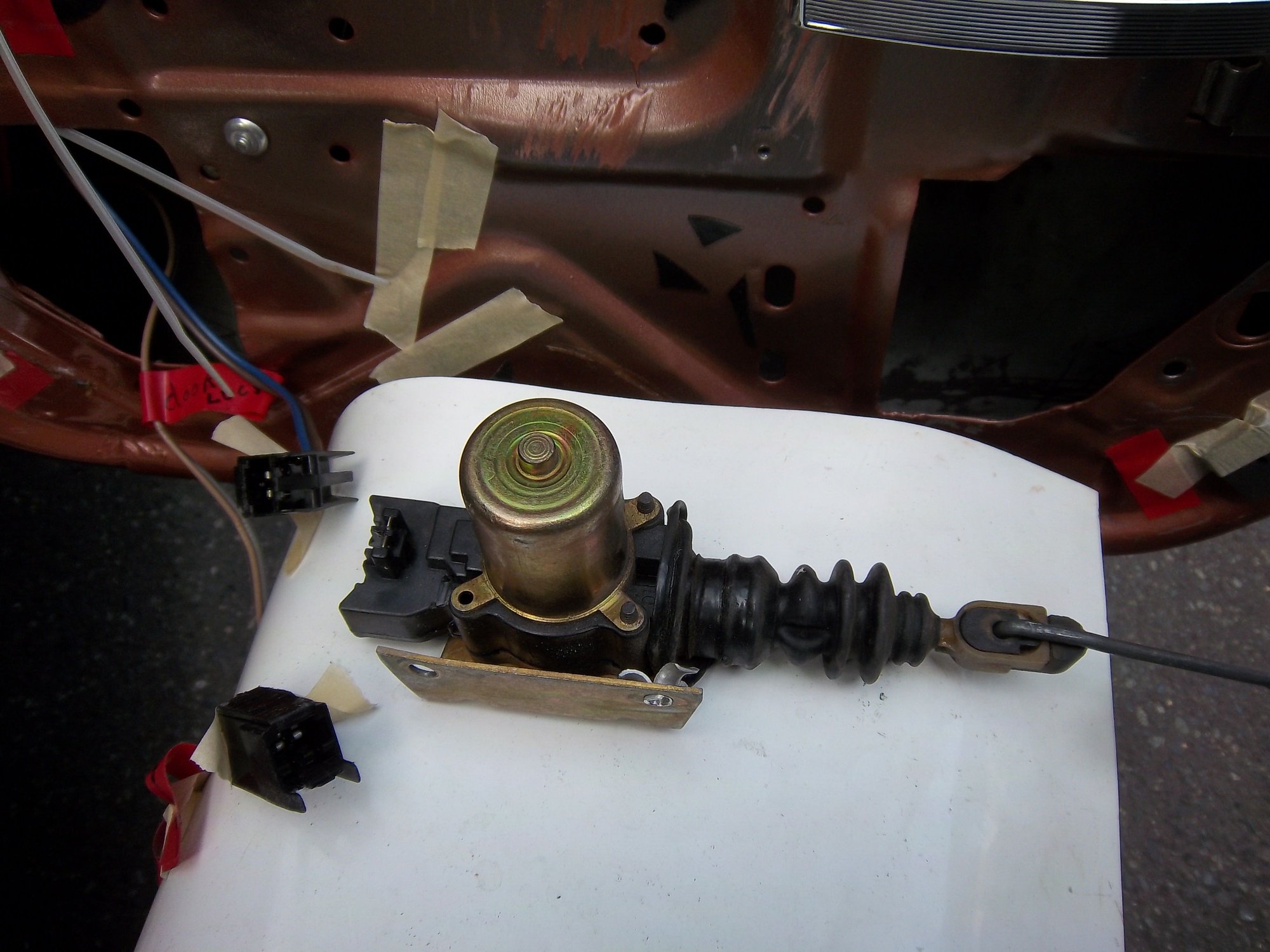

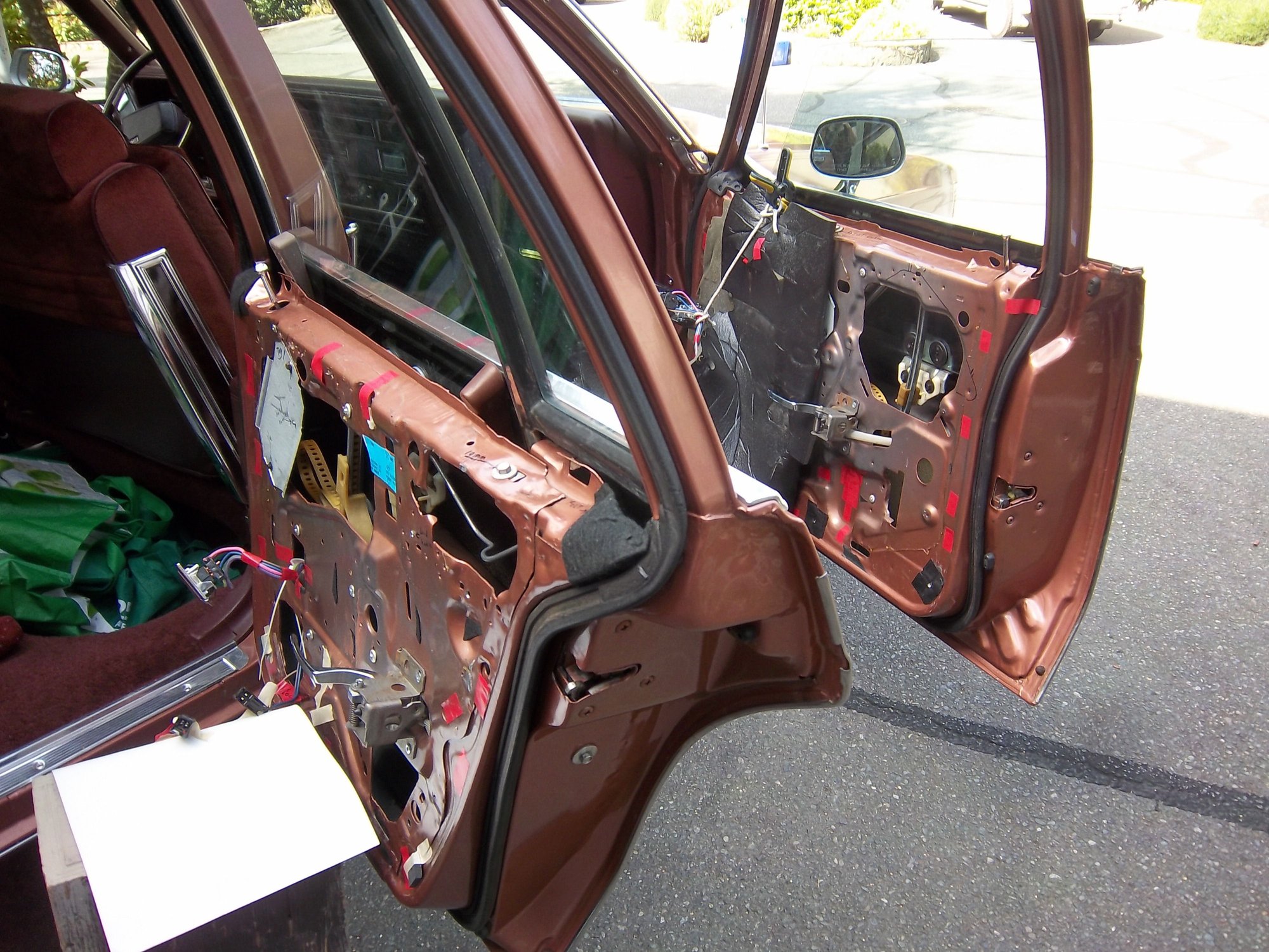

I have a 1982 4 door Delta88 . I removed all my power door locks . They did go up and down , but did not go down far enough to lock the doors , just sounded like they were locked / down . As you know we have to use a key to unlock a front door to get in . With the power door lock motor removed its less for the key to move / lift , i am older so this is helpful for me .
The power door lock has the same electrical connection as the power windows . To test and find my power window issues , i plugged my power window electrical connector into the power door lock motor. So maybe same idea for you / try moving the power window electrical connection to the power door lock
