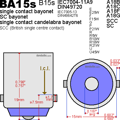

An 1157 or 1034 (normal parking and tail light bulbs for your car) has TWO contacts on its base and the socket also has two. As Yellowstatue has pointed out, these sockets and bulbs also have offset pins to correctly orient the filaments for either running or brake/turn signal.
Make sure you're not trying to put a single contact bulb in it. Plenty of us have done that.

I remain amazed that people can mix these up, but for completeness, THIS is an 1157 base:
And THIS is an 1156:
