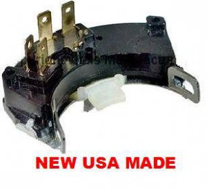

I did install headers. I thought I installed a everything back but obviously not. I checked the neutral switch and it is connected. I'm curious what colors are the wires connecting to the switch? I've noticed that there is a green wire harness not connected to anything. I attached a couple pics. One of the green wire that's not connected and of the neutral switch

The purple wires are the neutral safety switch.
The pink and orange-ish wires are the backup light switch.
The other plug is for the TH400 kickdown, though you may not have a TH400 - they just installed it in all of them.
- Eric

Sorry, Eric, but on this car the connector with the two green wires IS the one for the backup lights. That's why your lights don't work.

Curses. Right again, Joe.
Backup lights: Dark Green with Black stripe and Light Green
TH400 Kickdown Switch: Pink and Orange.
I never realized you could interchange the plugs, though.
