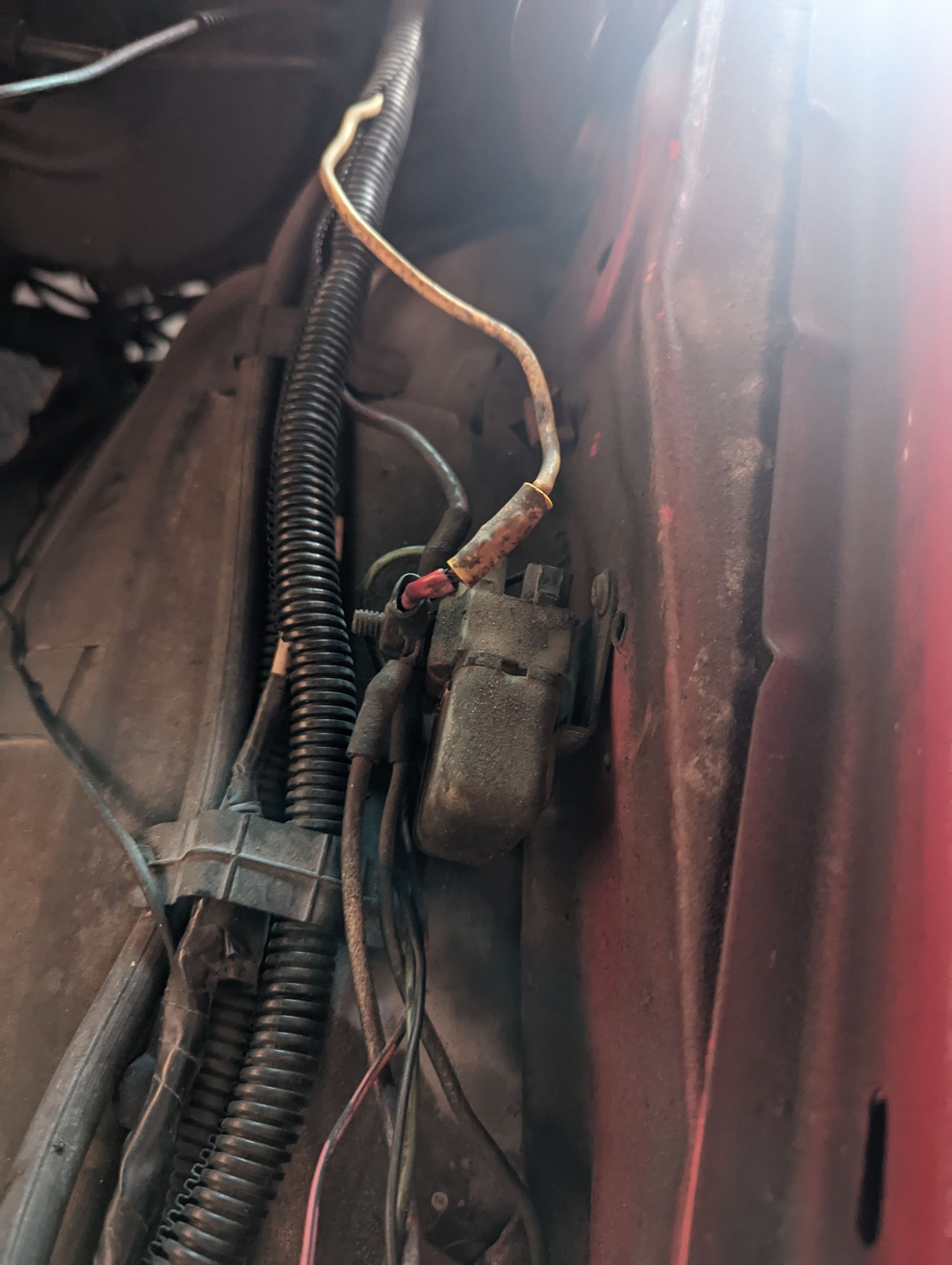

I would much rather remove this set up all together as suggested. What I gathered from tracing the wires (although they seem bunched up and colors change throughout the wiring)
There is one red/yellow wire connected to what I believe to be the Horn Relay or some sort of relay on the fender and One black wire going to the positive of the battery terminal. Would ths seem likely?
Pictures for reference:

I have connected the two wires for now to complete the circuit. Given the connection exists, im inclined to install a kill switch. What amp switch would be recommended given that the entire car's power goes through these wires? Any suggested brands/type of switches?
Old Sep 16, 2022 | 07:18 PM
Try leaving the ammeter wires disconnected and run a 10ga jumper from the pos battery cable to the horn relay.
Old Sep 16, 2022 | 08:00 PM
Falkon's Avatar
Joined: Jul 2022
Posts: 214
Get rid of the wires running into the car interior. They carry too much power. Here is what I found when I bought my car recently. Scared the hell out of me. A cheap little switch was used as a kill switch for the whole car. Wired into the line from battery to horn relay junction. 1971 Cutlass. The large fuse is a separate sound system. The terminals on that little switch were melted. Get the wiring out of your car for safety. From what you describe, it sounds like you should disconnect the wire at the battery running to the ammeter, & also disconnect the wire from the junction block at the horn relay running to the ammeter. Then all you need is a 10 ga wire from the battery to the junction at the horn relay. I'm sure someone else will jump in & verify this.

I replaced the ammeter with a voltmeter. Technically at the moment I had both running but took out the ammeter and connected the two wires. I could just leave the ammeter hooked up and move it under the hood
Or just cut the wires shorter and connect them under the hood vs. having them in the connected under the dash. It appears that one lead goes to the horn relay and one to the battery positive terminal but again. Based on what Im understanding I cannot just remove the two wires. The circuit would remain incomplete as the car doesnt have any power when both wires do not touch....
I am also interested in wiring a kill switch if possible as I live in the City (Toronto) and car thefts are uncomfortably high.
Old Sep 17, 2022 | 07:13 AM
Falkon's Avatar
Joined: Jul 2022
Posts: 214
All you need to do is connect the battery to the horn relay junction, to complete the circuit as in the original car. 1971 Cutlass.
