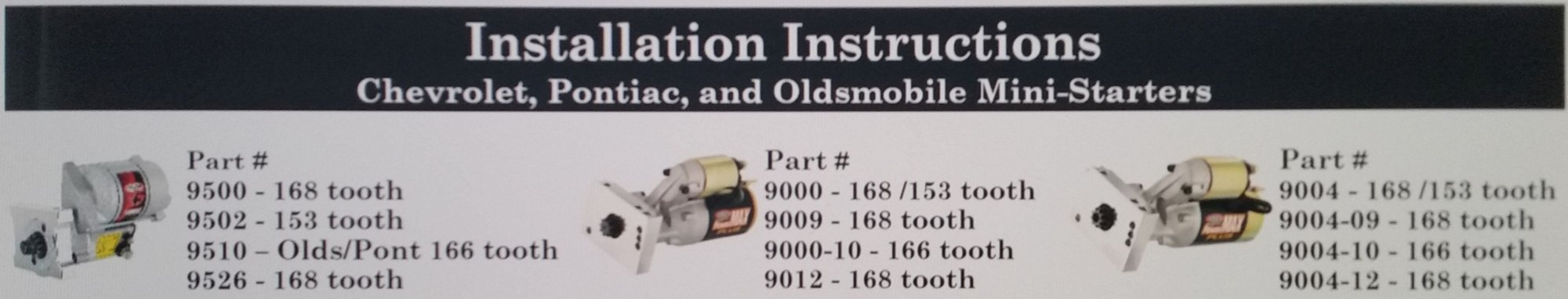

Originally Posted by HighwayStar 442
I have the Powermaster XS Torque Starters 9510.
Here's the header of my Powermaster instructions. It also calls out the 9510 for an Olds engine.

Posts: 50,768
Look again. 9510, 9000-10, and 9004-10 are all for the 166 tooth Olds/Pontiac application. Given that Powermaster shows a 9000 for Chevy and a 9000-10 for Olds/Pontiac, my money is on a mislabeled starter in the wrong box.I'm guessing that the pinions are different.
