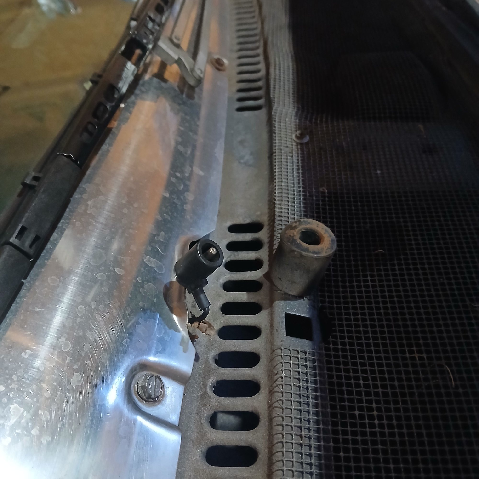

Trying to hook up original, still have antenna in windshield. What is this plug, I assume it's radio related. Where is it supposed to go, what does it connect with. What do I look for under dash? Thanks

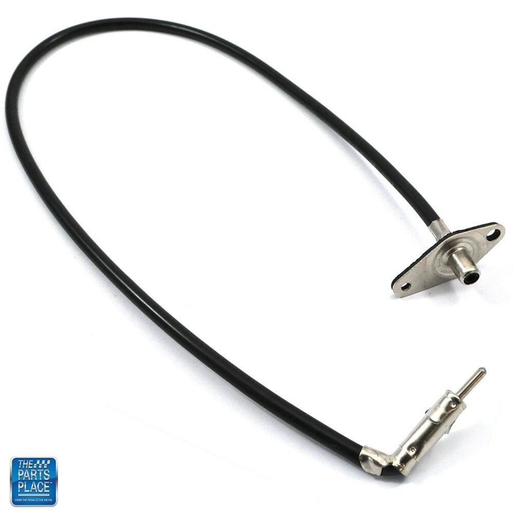

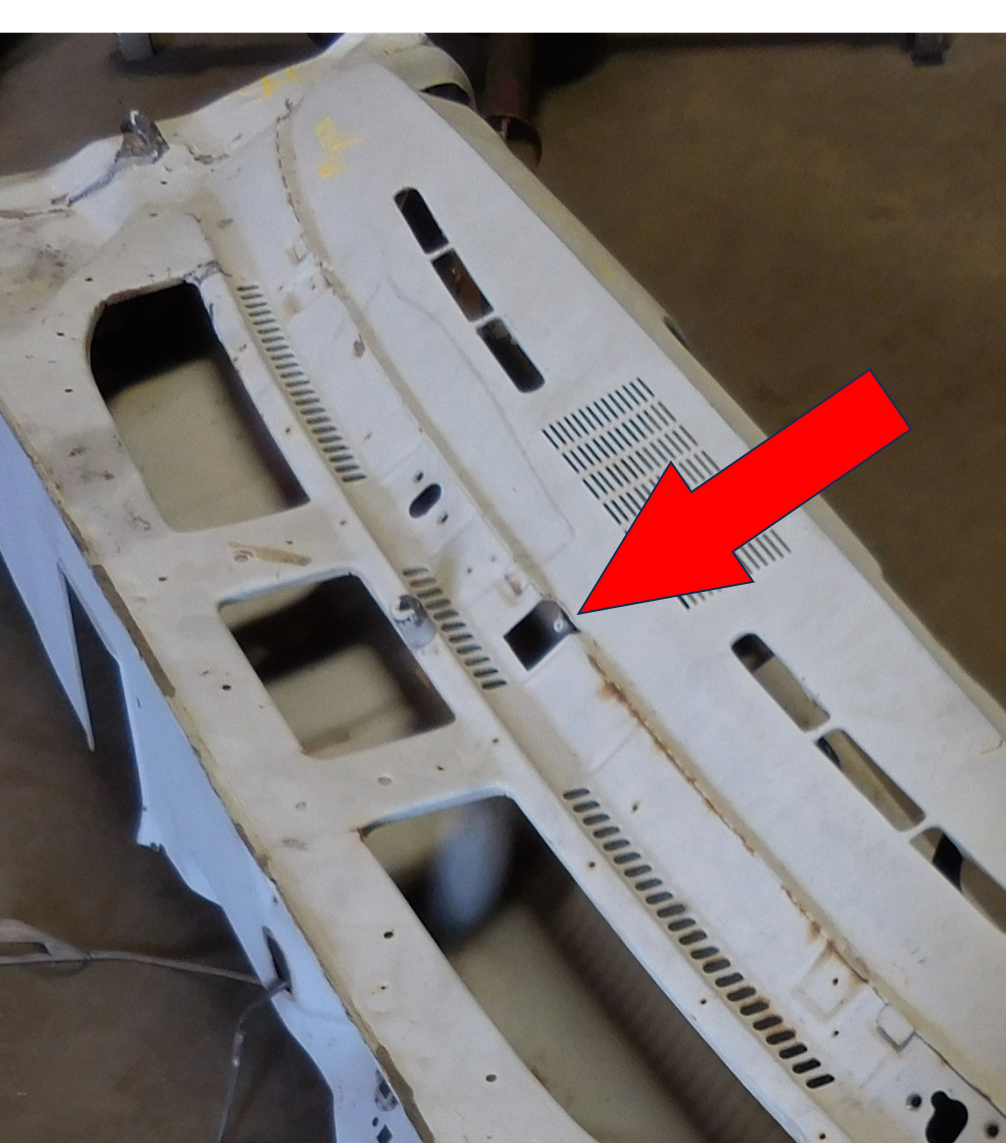

That's the RF plug from the windshield antenna to the lead-in wire. What year and model is this? OEM cars with windshield antenna would have had the lead-in right below that where it plugs in. On my 69 Cutlass wagon, the only wagon windshield available was the 1970-72 style with the antenna, so I had to install that but obviously my car doesn't have the lead-in.

It's a 72 supreme would removing chrome strip make it easier to access other end assuming it's there? Thanks
It should
