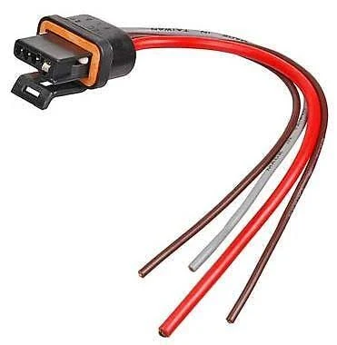

Be aware that the CS130 pigtail will have four wires in it. You only need to use the two of them. Ignore the other two and either remove the terminals from the connector or insulate the unused wires so they can't inadvertently short out.

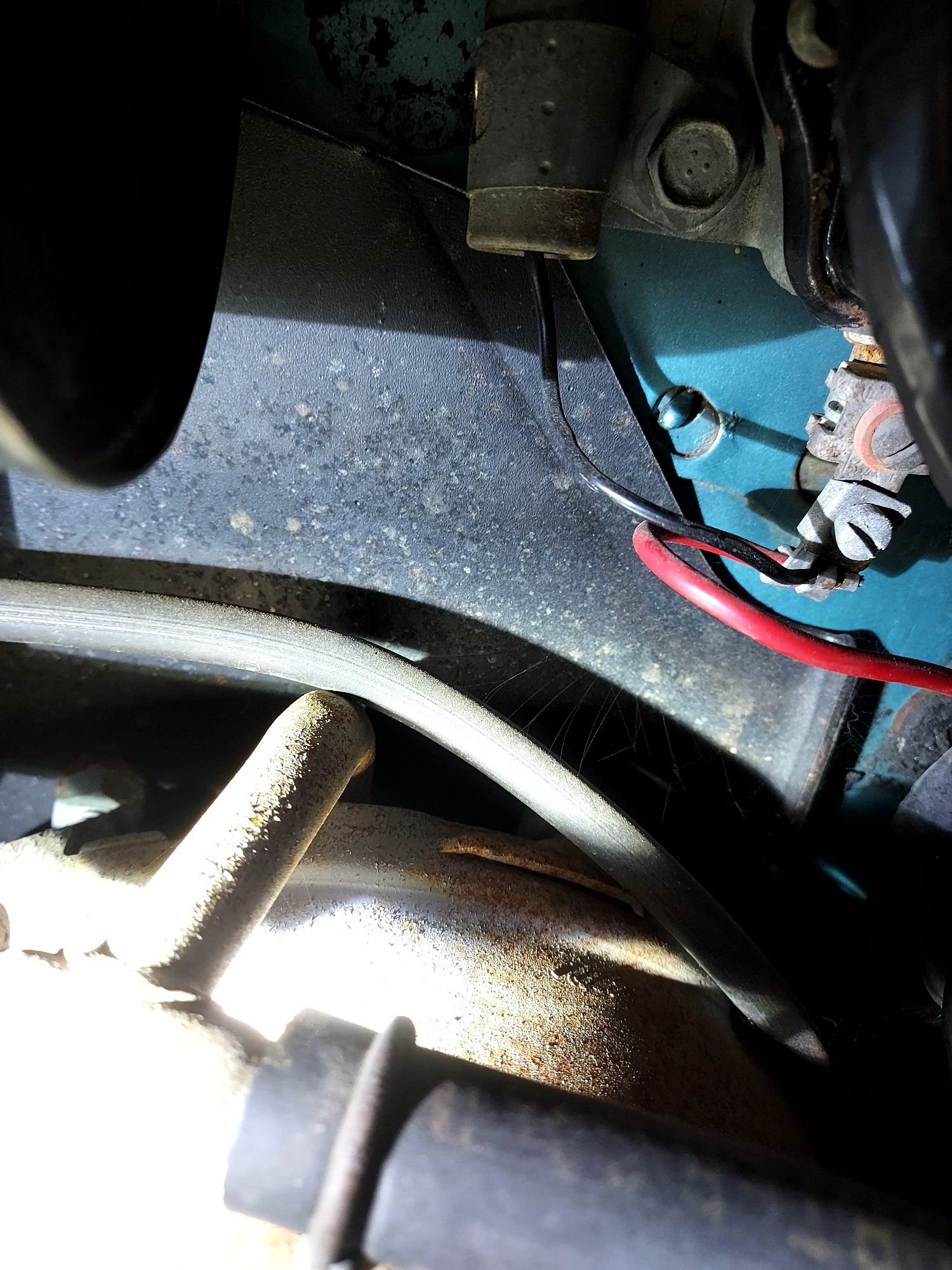

Hopefully that included the part about being sure to run a ground strap from the rear frame of the CS130 to the block. The one downside of the CS130 is that it is sensitive to grounding of the regulator. If you use the 10DN brackets, only the front frame contacts the bracket. Now the ground path from the regulator is through the aluminum rear frame to the iron stator core to the aluminum front frame. Galvanic corrosion between those parts compromises the ground path, leading to regulator failures. There is actually a TSB out on this from the late 1980s. I learned about this the hard way when the CS130 in the future second ex-wife's car would routinely go bad at 12 months. After the third time, a worker at the local parts store showed me the TSB about the ground strap. No problems since then. The one in my 62 has been working great for about 14 years now.
It did not. Thanks for adding that info.

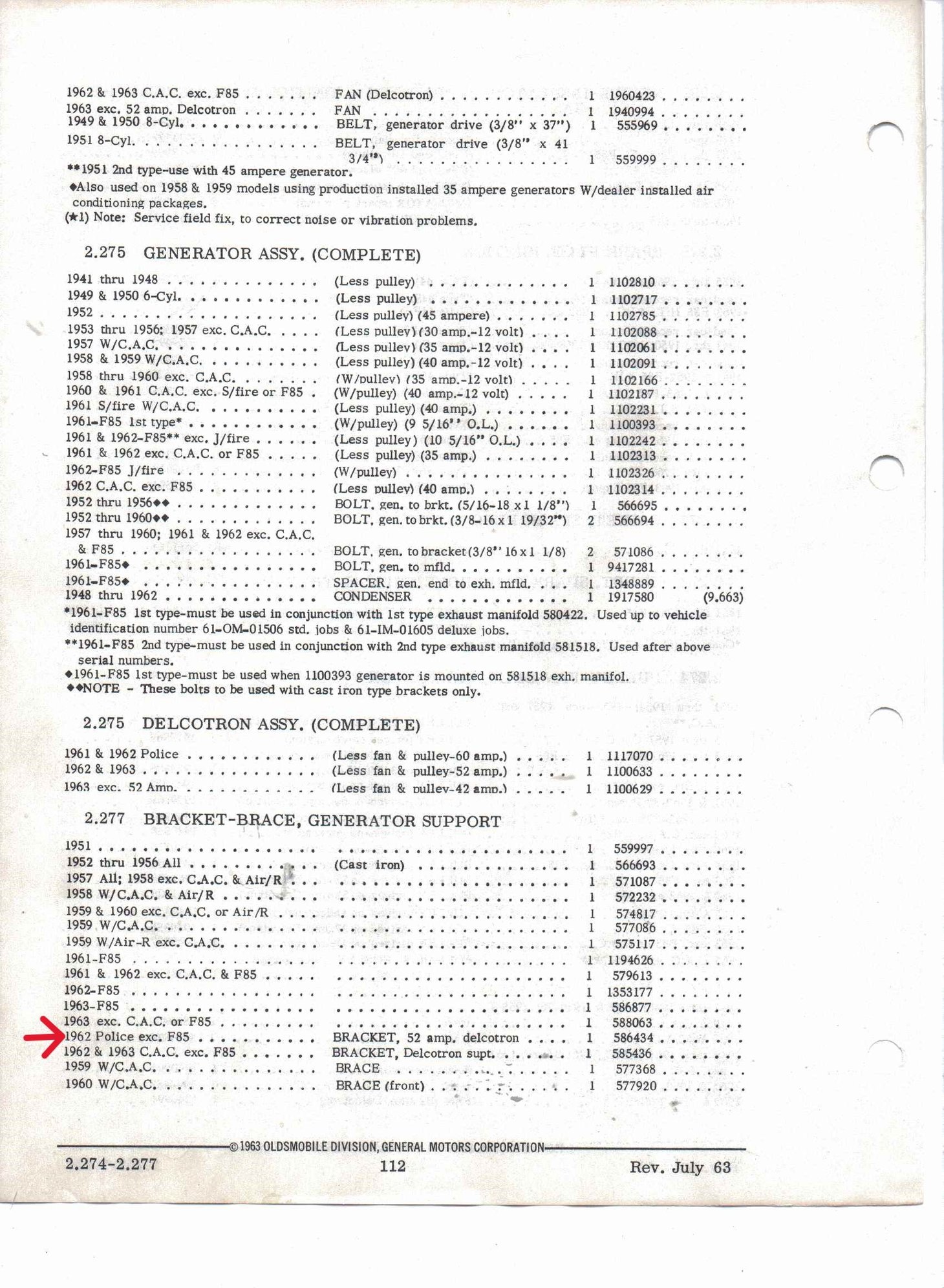

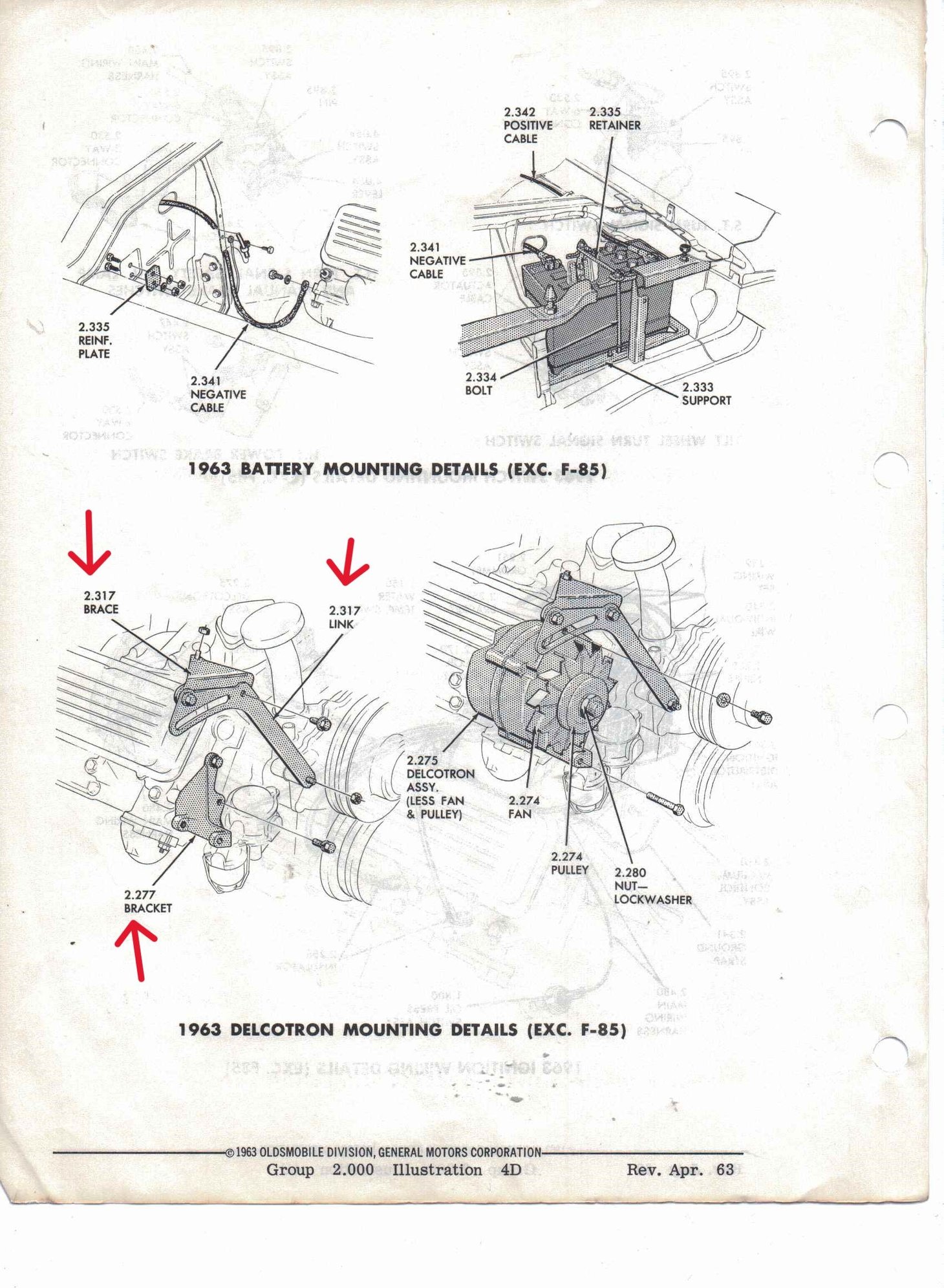

It may not be that simple and easy. The aluminum timing cover on 63-4 394 is different from the big cast iron chunk on the 62.
It's gonna take me a little digging to get all the part numbers sorted.
My Jan 65 parts book has a drawing of 63 with Delcotron and no airconditioning, but so far I haven't found one for 62, either with generator or Delcotron.

From what I can gather, upon studying the '63 parts book is that the only '62's that had a Delcotron were some A/C cars and Police cars.
The group numbers for the brackets are the same, whether Delcotron or generator.
The A/C brackets are a completely different design than non A/C.
With A/C the Delcotron hangs on a bracket bolted to the A/C compressor.
The only brackets for a Delcotron without A/C in '61 & '62 were police cars.
The part numbers are not the same as "63's without A/C.
It would be interesting to hear from someone who has actually done this conversion on their '61 or '62.

Got the alternator today but no pigtail.
I went to JPs post on HotRodders from 2007 and found he ordered an alternator for a 1990 Custom Cruiser.
Went on RA and looked up that vehicle and there it was.
Figured I'd add thos in case someone does the same mod.

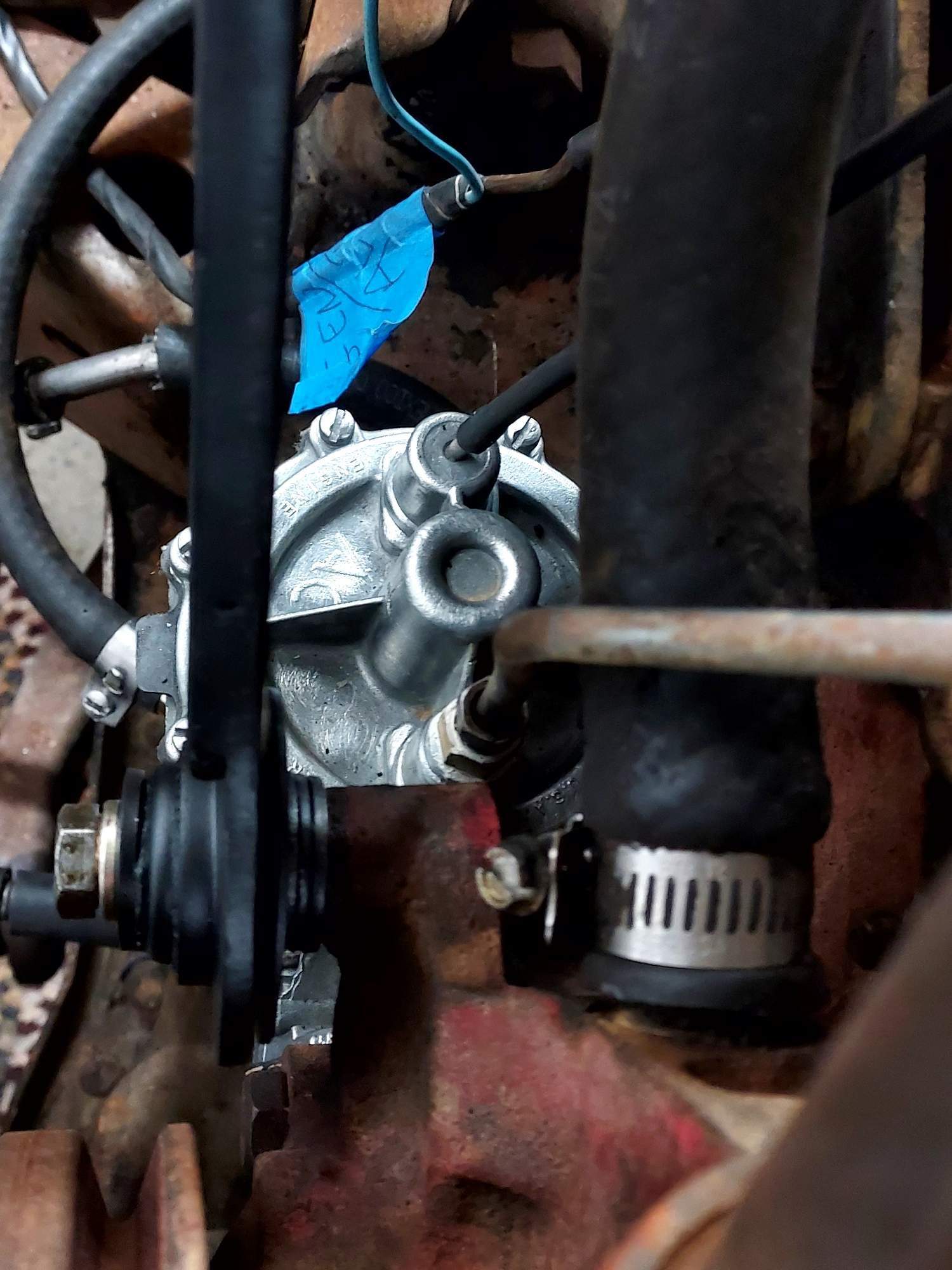

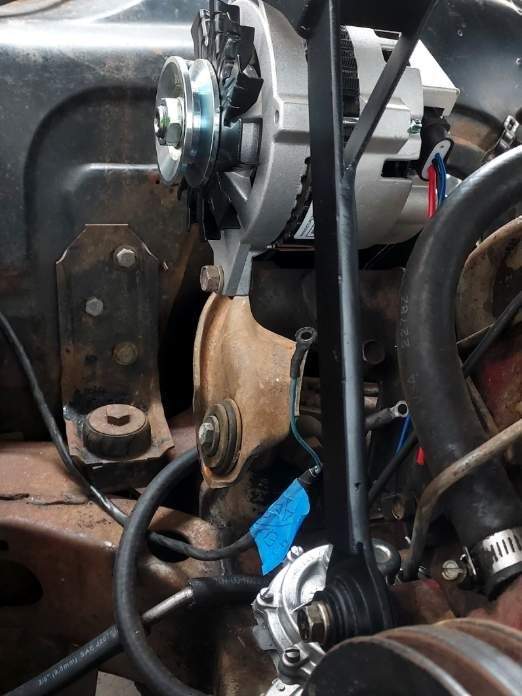

Looks like a couple spacers on the stock adjuster arm and the bottom mount, fab a small bracket for the rear alt support bolt and it should work.
Unfortunately the alternator does not spin freely, there are 2 spots where it hangs up and stops. Hitting something inside. You can spin it past those spots but it is being returned so pretty much on hold until new one comes as I have to drill out bottom hole on alt to accept stock bolt.
Old Aug 18, 2024 | 07:56 AM
Mikeyt's Avatar
Mikeyt
Joined: Apr 2024
Posts: 357
From: NC

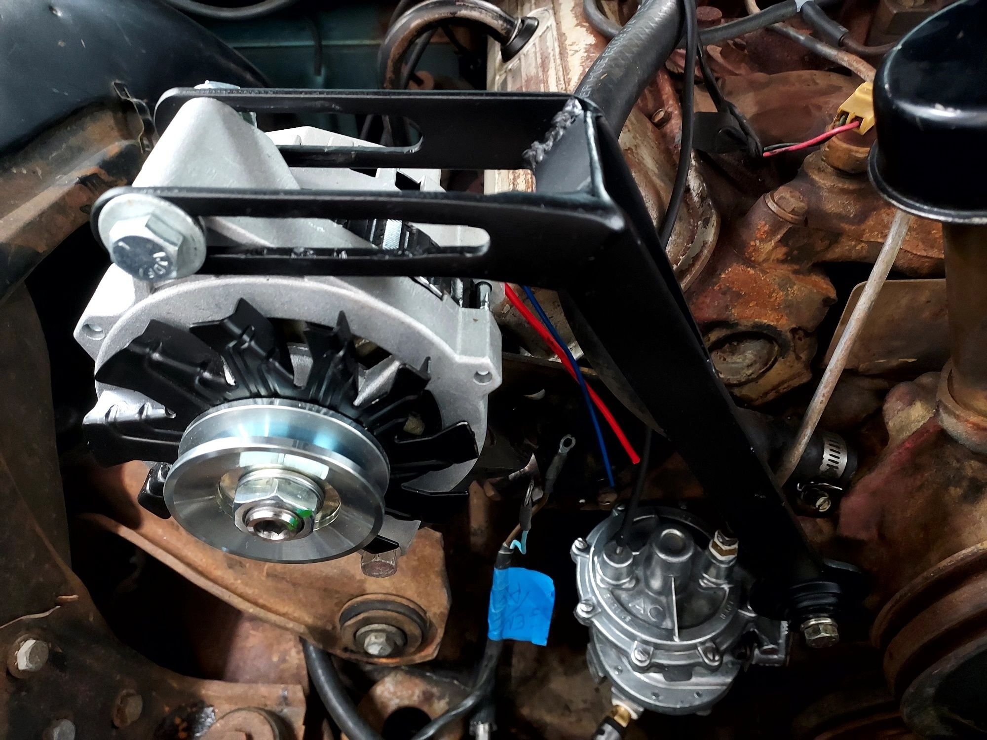

Finally got it mounted. Had to cut and modify the adjuster arm and added a brace to hold back of alternator. Couple spacers at bottom of bracket and it worked perfect.
Alignment looks spot on.
Bottom bolt of alternator lined right up with existing bracket.
Top and bottom holes of alternator had to be drilled for the bigger bolts also.
Grounded back of alternator to block per JPs advice.
Wiring questions to follow.
Please ignore the booger welds.😁

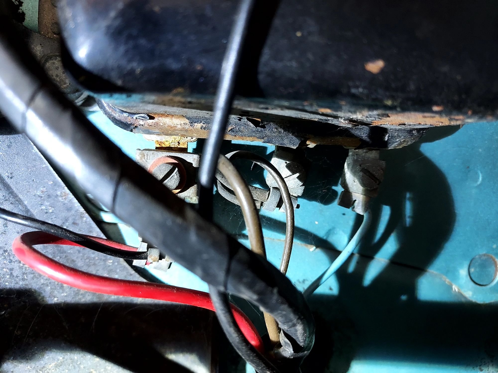

I understand the instructions JP gave me early in the thread.
I know where the wires from the new alternator need to go.
What I want to clarify is the existing wires at the Regulator. I know JP said eliminate them all I just want to make sure I eliminate them properly.
The brown wire has a small brown wire connected to it.
If I'm reading the diagram correctly that is a ground. So it can be snipped and capped.
It appears the big Brown wire goes into the firewall where it junctions and goes to idiot light. Snip and cap?
Red wire also appears to go in firewall where it junctions with 5 other wires one which goes to the horn relay. Another the main lamp switch, 2 to the fuse box and one to ignition switch.
Looking at the diagram it appears if I snip and cap at the Regulator all will still recieve power from horn relay junction.
Correct?
There is also a resistor, suppressor thing attached to that red wire. Just chuck it?

Nicely done!
Thanks Joe!
There was a lot of head scratching on how to support the rear. I kept focusing on the rear bolt on the alternator and how to attach it to the existing bottom mount. Just wasn't happening and still being able to add the adjustment slot.
Then sitting in my easy chair one night the design pictured popped in my head from somewhere. I got up real quick and made a crude sketch before I lost the thought. Lol
I burnt up my Dewalt drill making the slot in the rear brace and had to buy some carbide burrs to somewhat smooth it out but I am pleasantly surprised at how it turned out.

The brown wire isn't a ground. It is the wire that powers the GEN light. The round thing on the red wire terminal is a radio noise suppression capacitor.
One more time: Red wire goes to the BATT terminal on the new alternator. Brown wire goes to the "L" terminal. Run a wire from the "S" terminal to the junction block.
Old Aug 18, 2024 | 08:46 AM
  #33
Mikeyt's Avatar
Mikeyt
Joined: Apr 2024
Posts: 357
From: NC
The brown wire at the regulator that runs to the GEN idiot light goes to the "L" terminal on the CS130 (or the no. 1 terminal on a 12SI). Run a sense wire from the "S" terminal (or no. 2 on a 12SI) to the junction stud on the horn relay. Run a 10 ga wire from the BATT terminal on either alternator to the horn relay stud. Eliminate all the other generator and regulator wiring. Done.
So to clarify the brown wire has 2 ends. One at the generator/alternator and one at the Regulator. I need to connect new wire from alternator to brown wire at Regulator and eliminate brown wire that went to Gen correct?
So now you are saying instead of 10 ga. wire from batt on alternator to horn relay you are saying attach it to red wire at regulator?
Correct?
Old Aug 18, 2024 | 08:59 AM
  #34
Yes
Correct?
Either way works. The results will be the same.
