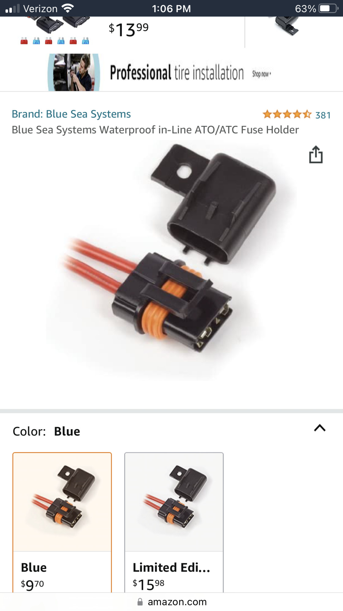

You can use a digital voltmeter to test various points of the circuit to determine exactly where abs how much voltage you are losing in the circuit.
Positive probe on the terminal at the blower motor. With the blower on high, bsckprobe blower motor power wire at the relay (both sides) the fuse holder on both side of the fuse, etc. Whatever the meter is reading is the loss of voltage at that point. I bet most of it will be in the fuse holder. If it’s a glass fuse type holder I just don’t think the springs provide nearly enough tension to support the current.
Id suggest a ATO type fuse. You can either cut the connector and wire from a mid 90s GM FWD cooling fan motor, or buy the terminals and make your own. I have repaired lots of blower motor wiring this way, it works much better.
Old May 21, 2022 | 10:07 AM
Posts: 6,105
If you don’t want to go the junkyard route, here is the ATO fuse and weather proof cover on Amazon for about 10 bucks.
