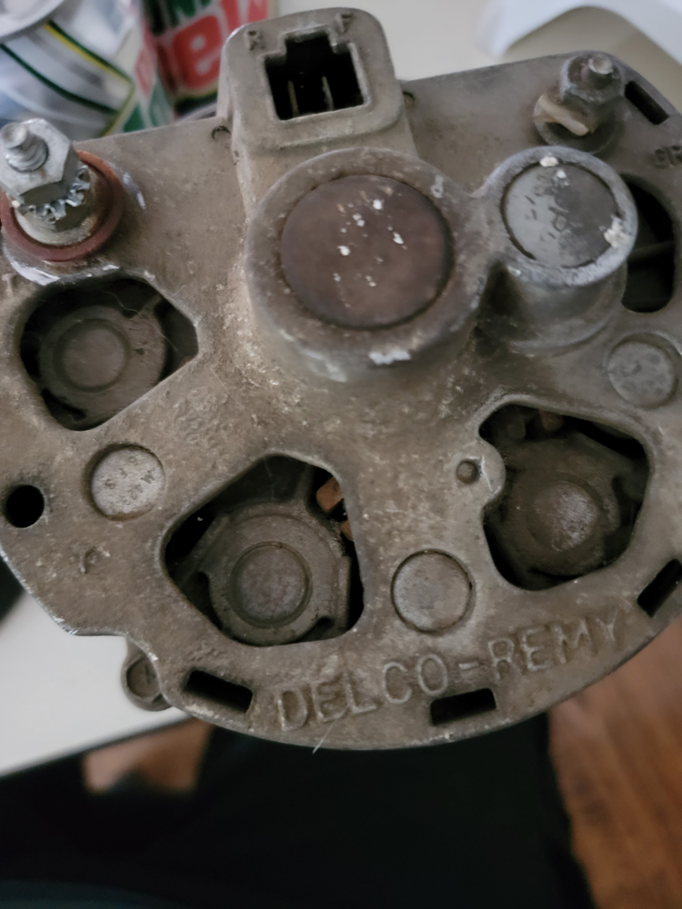

Now I need to figure out where the old ground wire on the alternator used to run. There aren't any loose wires in the engine bay at all so not sure when/where it was removed. Looks like something was connected (have what I think is the original delco remy alternator. Finding someone to rebuild it????)

Old Aug 2, 2025 | 02:50 PM
Posts: 26,195
If it is the original Delco-Remy ALT there will be a part number located on the case which can be validated via a parts manual. I'm not 100% on a 1965 ALT; yet, often an ALT doesn't require the GRD lug/post to be grounded as the ALT is often grounded via its attachment to the ALT bracket which in turn is connected to the engine block which in turn is grounded to the negative (-) battery terminal - again, I'm not 100% on the original OEM Delco-Remy; and, as you stated you don't know "if" it's the original ALT (so, there's that). At any rate, I think you said you've replaced the ALT twice now? Not sure where this is going relative to an external ALT ground wire if you've already replaced the ALT twice. Did/Do either or both ALTs you replaced have an external GRD lug/post? "If" you elect to use an external GRD wire connected to an ALT lug/post, you can connect that wire to any known good ground source - engine block would be ideal.

Looks to me like the GND wire has pulled out and vanished. I recall seeing a wire with a ring terminal under a nut on the alternator securing bolt (nut). I would check your CSM. I think you need to get a couple "ring terminals" and a piece of wire, clean and connect GND and a solid ground on the engine or alternator bracket.
