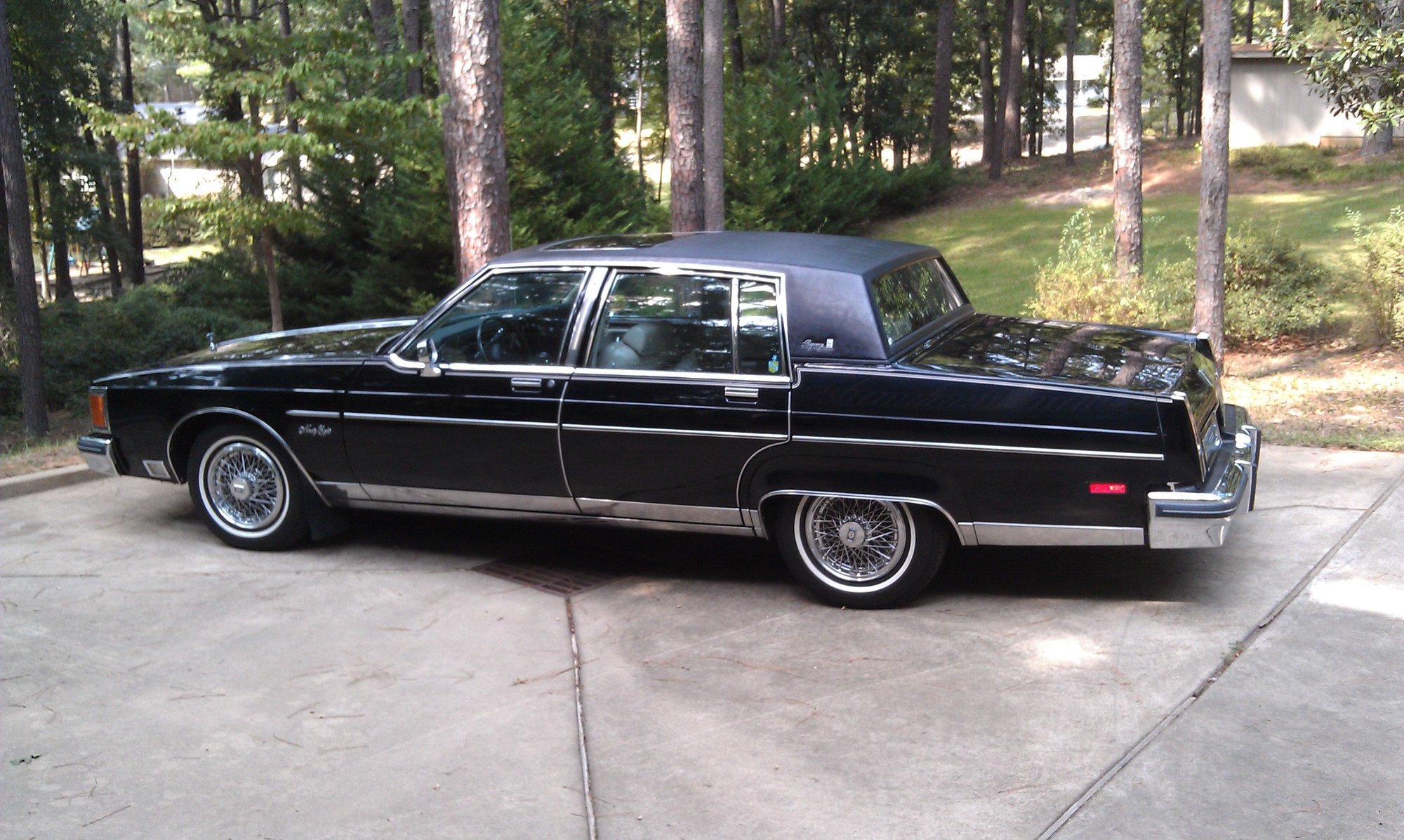

I am in need of help with diagnosing an electrical issue I am having with my 1984 Ninety Eight. The issue started when I attempted to jump start the car, there was a minor, but more than ordinary spark when I connected the cables to the post and shortly after the alternator began smoking and was damaged in the process. I stopped, replaced the alternator and manually charged the battery. When I attempted to install and reconnect the battery, the arc created when I attempted to connect the negative cable to the battery damaged the first thread on the cable bolt. I have looked throughout the engine compartment for a chewed wire but have not found any evidence. Thank you in advance, Brady

That is a great looking car!
Can you substitute a known good battery for test purposes?
Look near the starter for a partially burned/shorted fusible link and at the positive cable where it goes through a tube by the starter.
