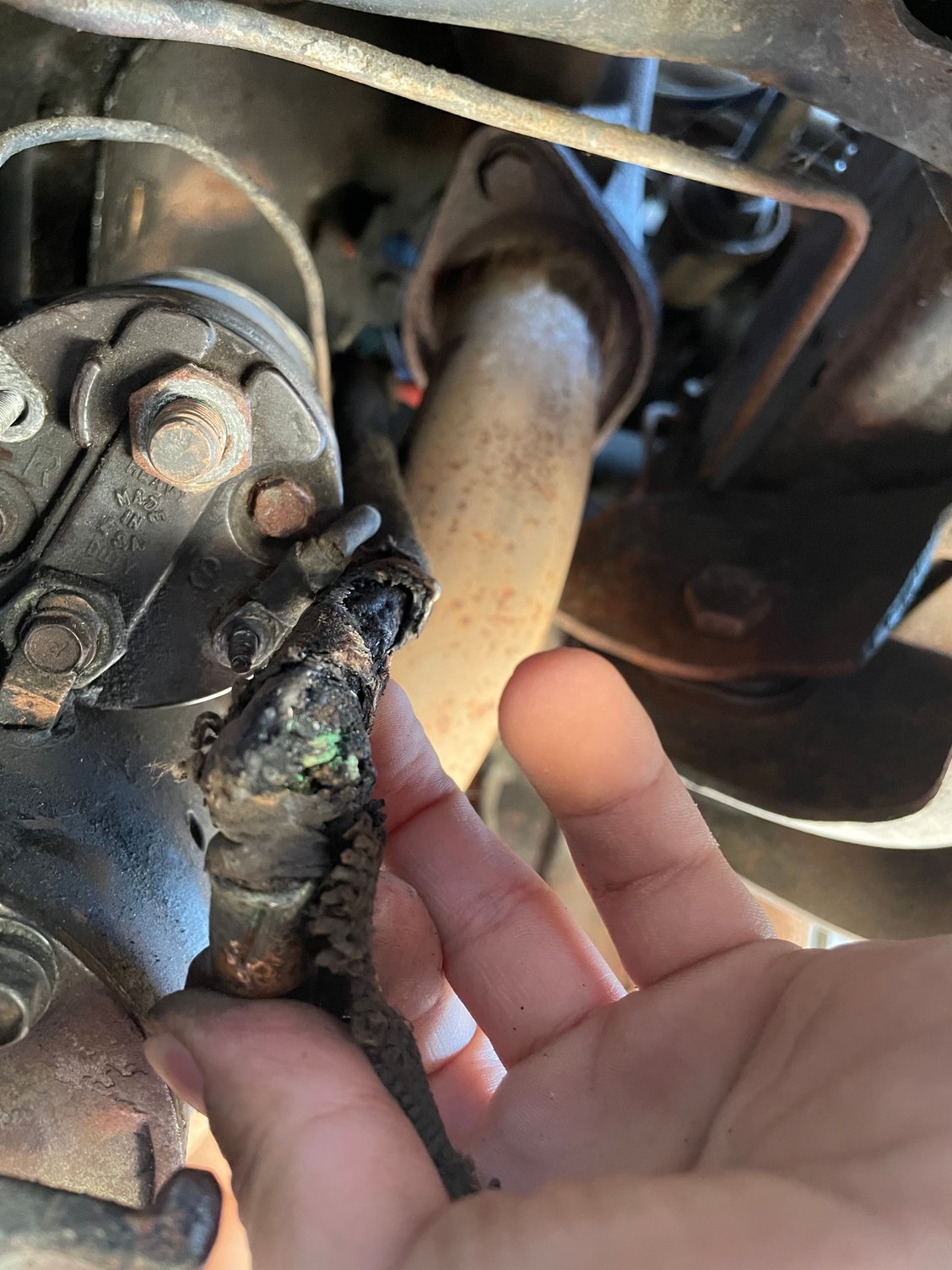

replacing cables found this.

Is this normal starter is working???

Old May 17, 2023 | 06:45 PM
Uh no...that is not normal. You need to replace that cable.
Old May 17, 2023 | 07:25 PM
Posts: 15,411
Your low charging voltage is a different issue than your corroded battery cable.
