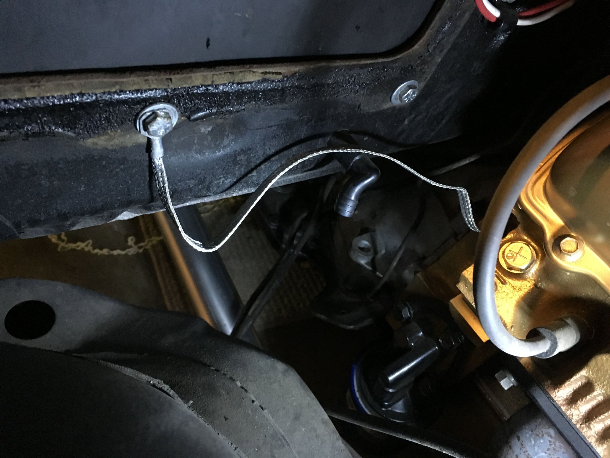

Does the 68 have the braided flat firewall to ground strap on the back of the passenger side head?
Not on my car.

Originally Posted by rhett838
Not on my car.
You should have one.
+1.

And you got a check, need that on the engine, bodyground. I would check all grounds on
the body front and rear, JTBS. Good to hear she's up and runni'n.

Next, get your engine to firewall ground strap hooked up. It looks something like this. The pic isn't from a Cutlass, just a pic I found on the Google. You can just use a 12 or 10 gauge wire for now until you can get a proper looking one. After that I would check all your connections from + and - battery to where the cables end. Make sure they are all tight and you have continuity.
Did you replace your cables when you put the new engine in?
Is the jumper you put on the NSS still tight or did it get loose?

Do I uses an existing bolt in the intake to attach that or is there an open hole I can attach a new bolt to?

There should be a threaded boss for a bolt to go into if the bolt isn't there.

I got that ground wire on btw...
