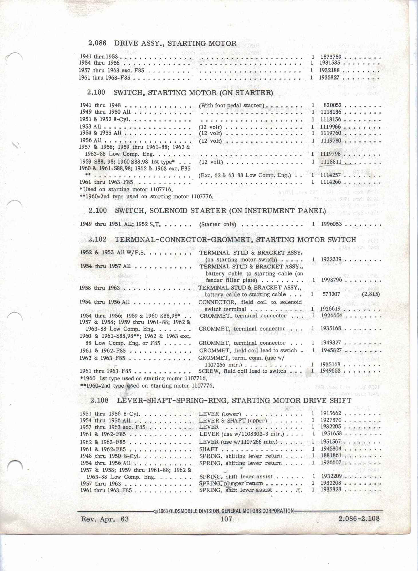

That's a lot of money to spend , especially when your starter may only need a drive .
Original starter drives can be had here ;
https://www.ebay.com/sch/i.html?_fro...963+Oldsmobile
A starter drive , bushings and brushes may be all you need .
A local shop should be able to check the armature on a " growler " and true and undercut the commutator .

That part number is 1932188 is directly from the Oldsmobile Parts catalog , group # 2.086 ;
thanks Charlie

Other Delco part numbers for the drive 1974355 1932188 1939506 D2003 D2028 I have a new one in stock if you can't find or fix locally Drive measurements in MM gear dia. 25.4mm Length 76.2mm
