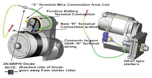

Another reason for the other solenoid is if your using a mini starter and still run points it also provides a resistance wire bypass signal to the coil+.

True, but a $0.50 diode does the same thing if that was the only reason.
It's easy to check. Just look and see if a wire goes from the solenoid to the + coil. I'm betting that's what it's for

In addition to the Ford solenoid? Nope.
Simply run a diode from the starter motor terminal to the coil. Current only bypasses the resistor wire when the key is in the START position, and the diode prevents current from holding the GM solenoid engaged after start. You can pay $20 for the diode kit like this or use a $0.50 diode and your own wire and crimp terminal.

No, having the benefit of providing a resistance bypass signal would be in addition to trying to cure the heat soak issue, The mini starter has no provision for that signal but the solenoid has an I terminal output.
Old Nov 9, 2020 | 04:25 PM
And again, my point is that the mini starter without the "R" terminal works just fine if you use the diode. Besides, the whole point of the mini starter is to fix the heat soak problem of the GM starter. Adding unnecessary components only increased the number of potential failure modes.
