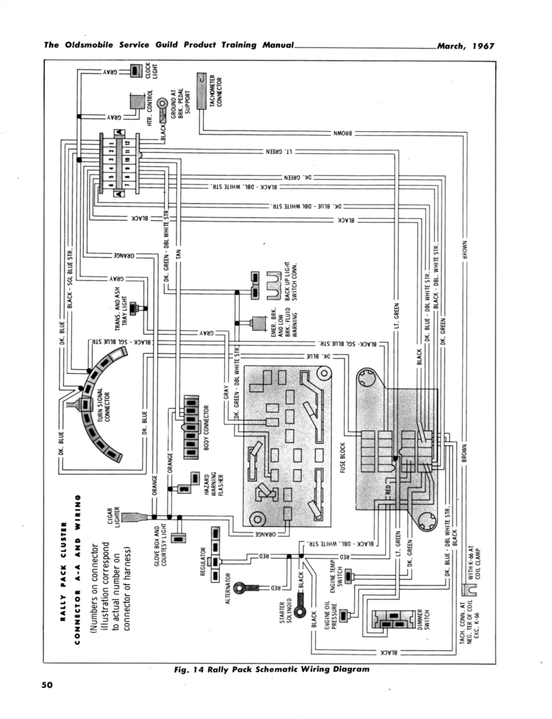

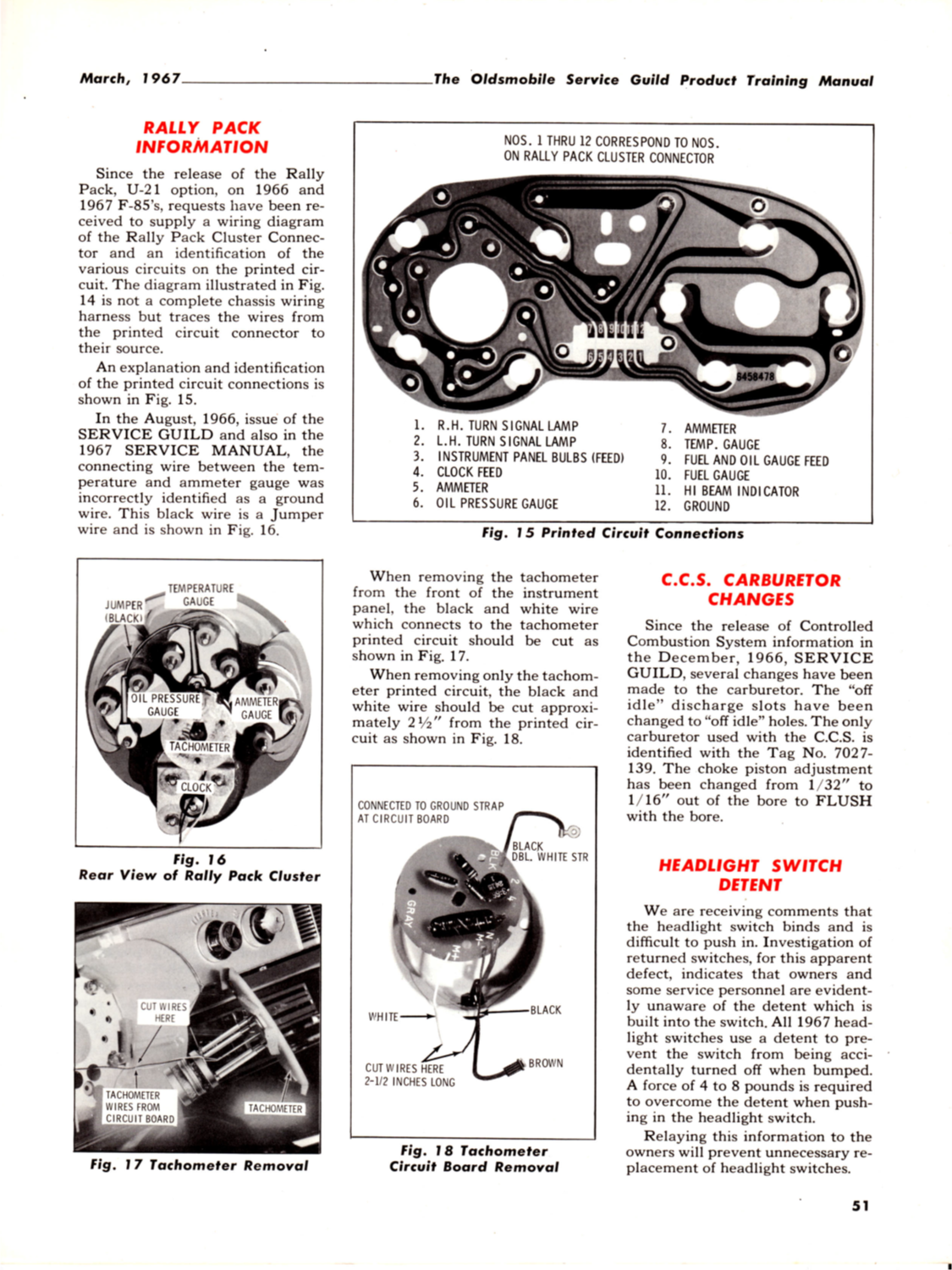

Does anyone know where I can get the wiring diagram for a 1967 442 dash harness with rally pack. The only thing any of my book have is for standard dash with out gages

Here's your very own thread, rather than resurrecting a new one. The 1967 Rally Pack info was actually provided in a Service Guild Bulletin update.
