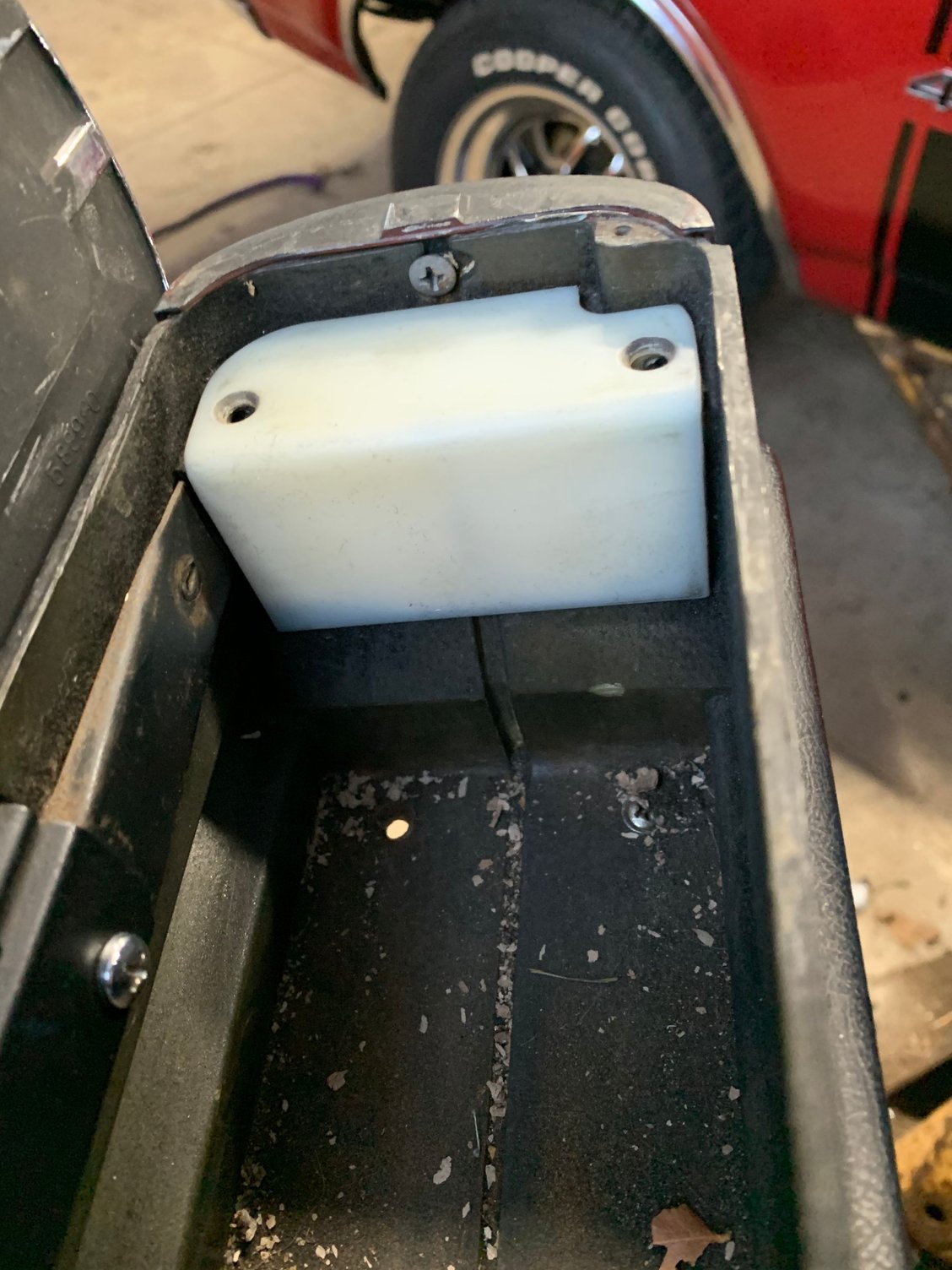

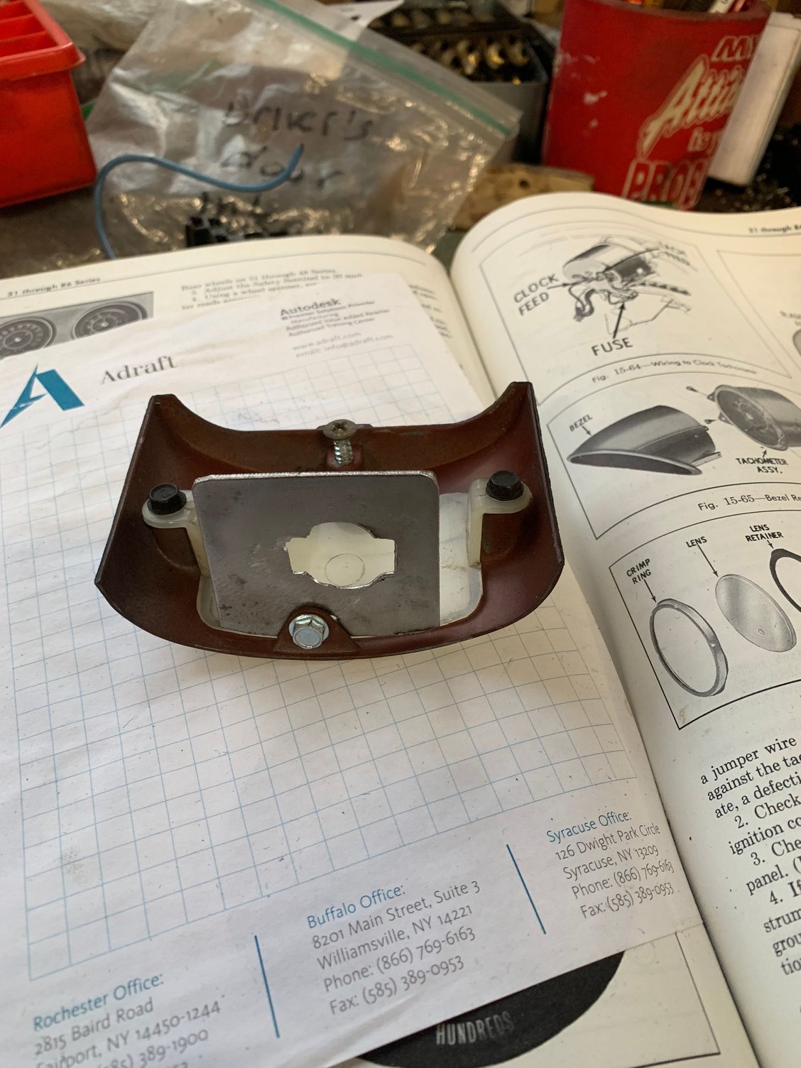

I guess we’ll see how this goes. I’ve got it wired into the courtesy light circuit. I removed the flock from the inside to expose the white plastic lens. I’d already done it to the back lens

Thanks Allyolds68!! This is exactly what I was looking for, to set up my console in my 66'
