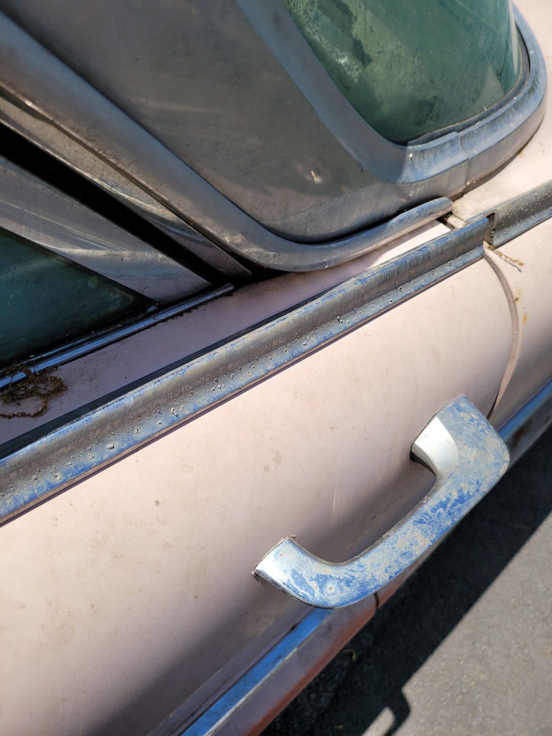

Well after a lot of searching, I actually have a 2dr, 4dr, and the wagon at my house. All hardtops. The rear doors are different. They look to have been modified for use on the wagon. I think I can also modify them to work so I think I can use them, but some work is required. I am so shocked to see that the door "spears" are the same between the 2dr and 4 dr. As well as the rear quarter fins.

Old May 6, 2021 | 08:57 AM
Lemans1's Avatar
Joined: Jan 2021
Posts: 28
So just to possibly help others. What was modified? Can you clue us in on the differences?
The only difference I can find without actually fitting the door is the top rear corner. Looks like they simply trimmed it to fit the different molding.
Old May 6, 2021 | 09:01 AM
Lemans1's Avatar
Joined: Jan 2021
Posts: 28
Here they are closed.
