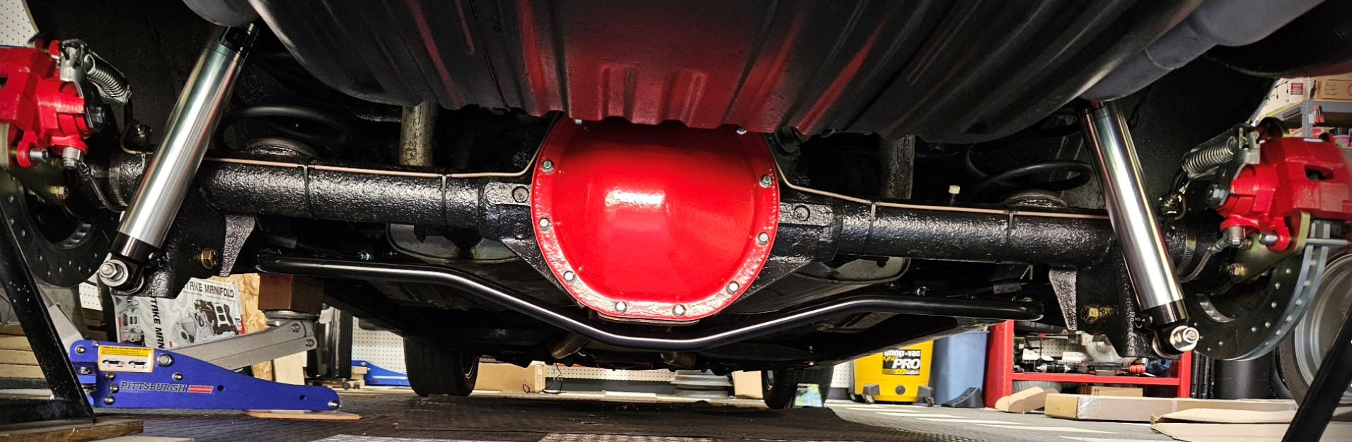

This is it on my '67:
bought the pst bar -- boxed the lower arms incorporating the plates provided -- works like a champ -- best I could find, but no it is not a bolt on application, but with a little ingenuity, quite acceptable...

I am happy with the QA1-TS904 adjustable shocks that I have on the rear of my 67 98. It allows me to dial-in the rear suspension to match the Coil-overs that I have in the front.
