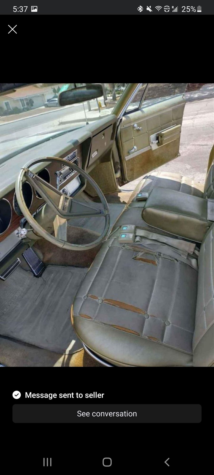

Im new here and I'm not sure if this is the right place to post this but I'm looking at buying a 1968 delta 88 with the 455 with the automatic transmission. The one that I'm looking at has some basic rust as well as a huge rust hole in the front bumper. It showed evidence of a transmission leak and when I went to test drive it it wouldn't drive at all, it barely even backed out of the spot it was in. I'm just curious as to how much one would go for in this condition and about how much it might cost to replace or rebuild the transmission.

That's an oddly optioned car, with Tilt-Telescopic wheel, Guide-matic (automatic headlight dimmer) and little else. Good color too, these cars looked "right" in Willow Gold.
A Delta 88 Holiday Sedan was the quintessential middle-class car back then.
If you can get by with a reseal the transmission may not be expensive to fix. Depends where you are in the US, a full rebuild of a TurboHydraMatic 400 can get into mid 4 figures. But once it's fixed you can't hardly kill it.
Bumper can come from any 1968 88 or Ninety Eight.
With the transmission issues, interior needs and general soft market for four-doors, I wouldn't go over $2000 for it.

Does the ac work, or at least turn free? If not, that may set you back another grand or so to get repaired. On the bright side, it looks like a 310 hp lower compression 2 barrel car, so it should get 18 mpg on the highway. Agree that 2 grand or less is fair price given the car’s issues.
