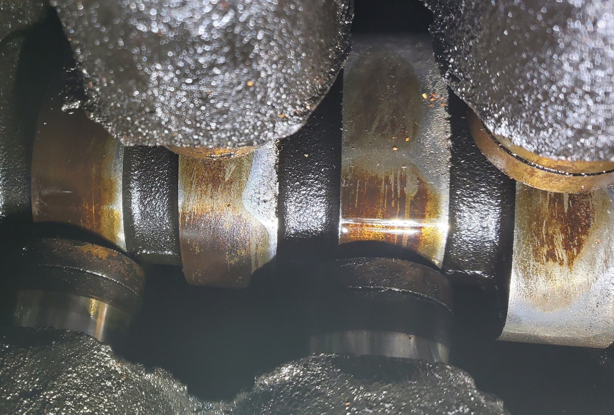

Since winter has hit, I pulled the engine and trans for rebuilding, found a guy locally that has done the "Slim Jims" and was a fair price so it is to be dropped off tomorrow for service, the motor on the other hand had some surprises I was not expecting, the wear on the camshaft was something I had never seen before not to mention the chunks missing which i can only assume was the result of the guy who installed the camshaft the last time it was messed with.

Old Nov 28, 2022 | 05:13 PM
Charlie Jones's Avatar
Phantom Phixer
Posts: 5,526
From: Apopka, FL
It looks like a normal, well-worn camshaft. none of the lobes are rounded.
It, along with the lifters, should be replaced though.
Looking at the deck surface, it looks as though there were steel shim head gaskets there.
If so, it's likely that the engine was never opened since coming from the factory.
The cylinder ridge doesn't look too bad so it may clean up with a .030 overbore.
Your machinist will be able to tell for sure.
Ok good to know, I was concerned it was ran low on oil from the looks of the cam but I am not a motor guy either. You are spot on it was a steel gasket, only reason I assumed the heads had been taken off is the paint job made it appear like they had.
I have no experience having machine work done on motors, I was planning on measuring the bores comparing to the spec I have in the manual and then requesting larger if needed from there, would that be the correct method?
I was also planning on having the driveshaft ground or polished depending on it s conditions, will know more when I tear it the rest of the way down this weekend.
I have seen the back and forth on hardened valve seats and I am unsure if I should do them as it will be a cruiser not a road trip long haul car, was figuring to just check to make sure the rockers were in good shape and have the heads machined flat.
Any suggestions or advice welcome as this is not my strong suit.
#1. Do you have proper measuring tools and proficiency using them ? Dial or digital caliphers won't work.
#2. Driveshaft........ Use a powered wire wheel to remove rust and then paint. Don't grind or "polish" the drive shaft, you could throw it out of balance. If you are calling the crankshaft a "driveshaft", DISREGARD #2 completely.
#3. Rocker arm shafts and rocker arms can be checked for size and "out of roundness" and cleaned. If any are worn, they need to be replaced, bushed, or refurbished.
#4. You can check the block deck and heads for straightness with a straight edge and feeler gauges. You may decide to have the block decked and heads milled to clean up.
In your case it is probably best to disassemble the engine. Wash the oil off the parts, and take it all to an automotive machine shop.
They will have the proper tools to measure and evaluate the parts. Let them determine how much the cylinders need to be over bored.
By driveshaft, did you actually mean crankshaft? There again, let a machinist with a micrometer determine whether the crank can be just polished, or reground, and to what undersize.

YIKES, I didn't realize he might be referring to the crankshaft as a "driveshaft". You need to learn correct terminology.
You are correct, its what I get for trying to write a post in the middle of my work shift, thanks for the input.
Here' a link to my 394 rebuild. I did do a performance rebuild with the forged pistons and hi lift cam but those are not necessary in a stock rebuild.
394 "Rocket" engine build - ClassicOldsmobile.com

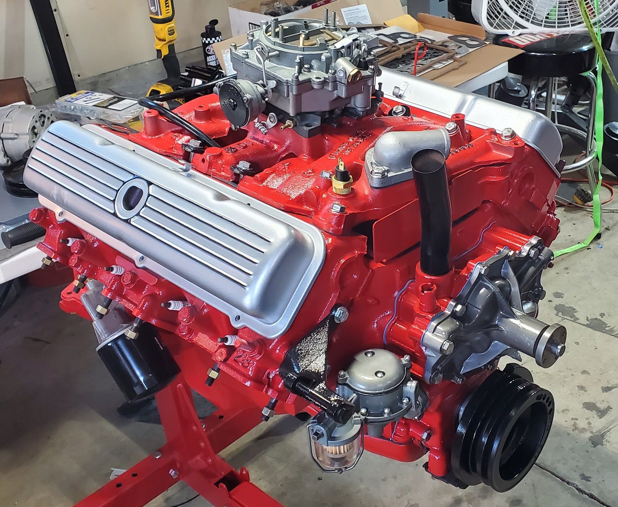

Well long time no post, finally have the motor back together after getting it back from the machinist, ended up going .030 over and having it decked and balanced. I also opted for a higher flow oil pump and had the machinist open up the galleys.
Now I am on to figuring out the vacuum lines which seem to be dropped from the service manuals unless you are working under the dash on the heater, anyone have a resource to tell me where and what all the ports on the manifold are intended to go?
Here are some pictures of the progress so far.
looking very good
Time to get it together
to much red
Tedious work..
Semi all dressed up

The small port on the rear of the intake manifold goes to a vacuum ball. which supplies vacuum to the HVAC system.
The big port on the intake goes to the power brakes.
The port on the rear of the carb goes to the distributor.
The port on the front of the carb goes to the PCV valve on the valve cover.
That's it. Pretty simple in '64.
ok I had 3 ports on the manifold so it had me stumped, especially the one that is on the bottom of it.
If you're talking about the one on the bottom in the middle under the carb, that is associated with the heat tube that goes to the choke thermostat on the carb.
That's correct that was one I was wondering about, the previous owner had chopped up the original 4 barrel manifold to fit a new Holley carb so most of the original vacuum lines were missing or messed with and I am trying to take it back to stock or as close as I can atleast and did not have an example to go off of.
