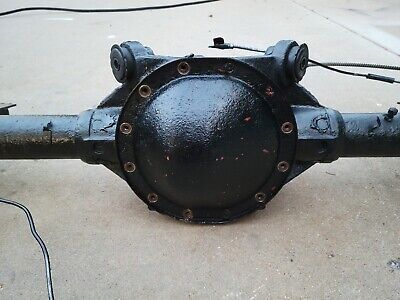

I am looking for a type O rear end. I found one that has bolt on cups for the coil springs. Perhaps it is a 1966 version.

66 was the only year for the O Type & flat bolt on spring mounts. 67 up are the dowel type mounts.

Need close ups of the welds. It appears NOT to be original flat perch 12 bolt O rear... But need close ups of the perch welded areas.

The 1966-only housing is pretty rare, since they were only released in April 1966 and were changed to the later spring perches for the 67 model year.
