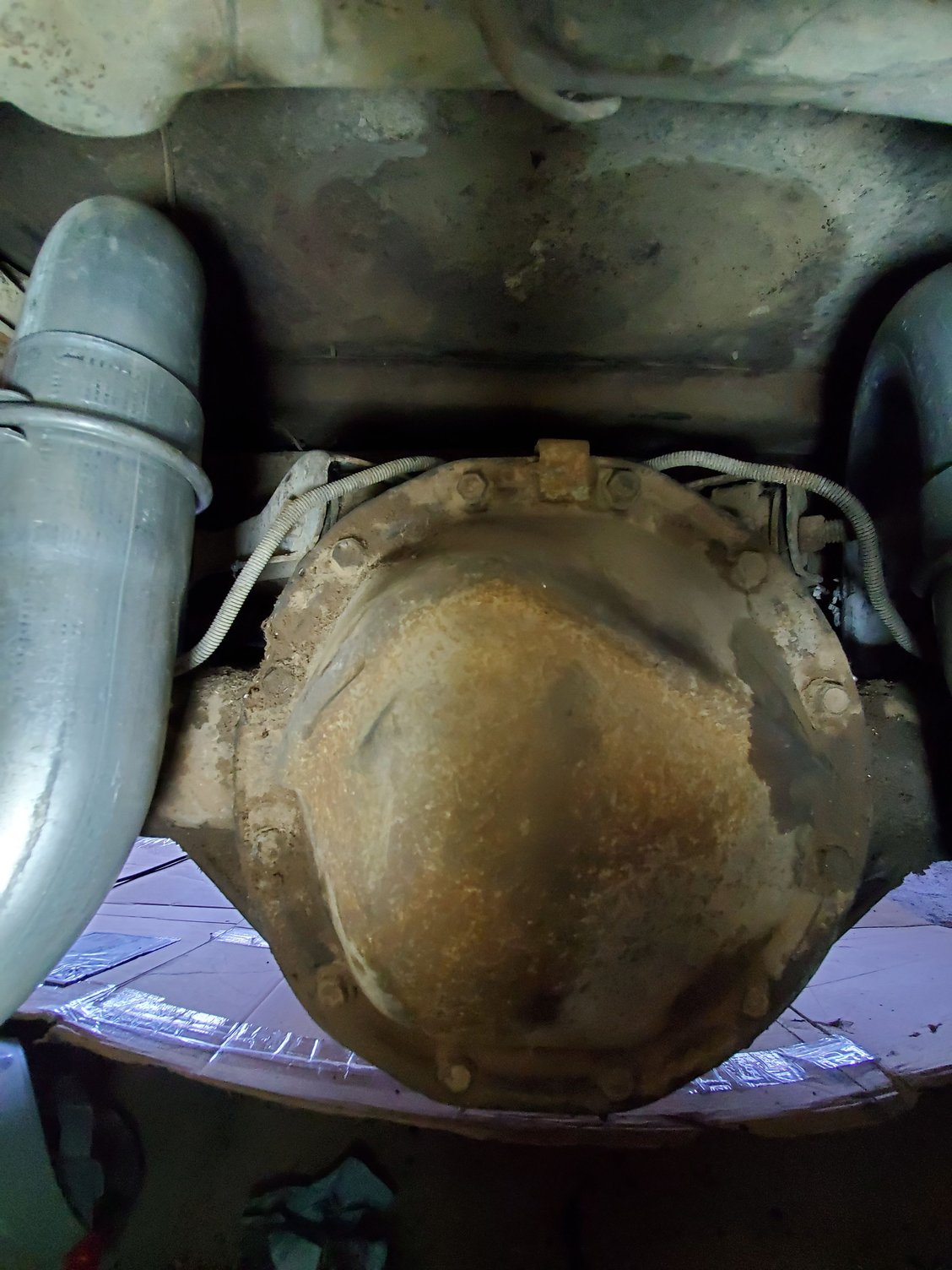

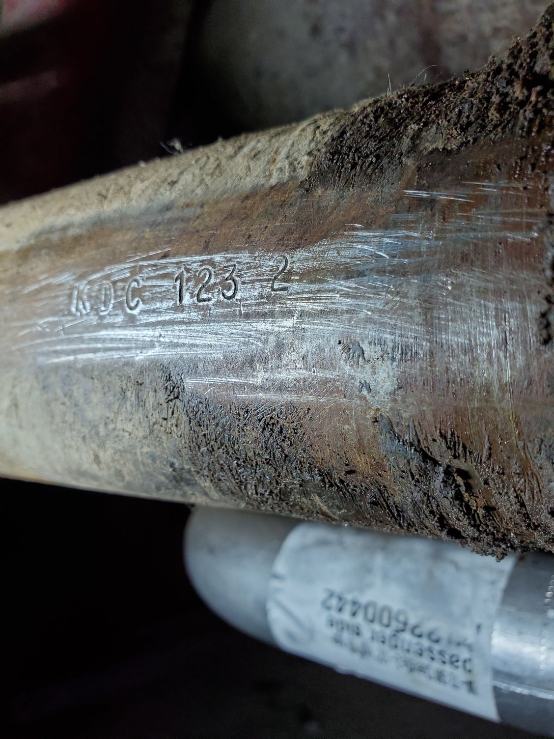

It is a pain to try and get identification info for an Olds differential. Anybody have a better way to tell if this is a Type C or a Chevy 12 bolt? It has the crease in the cover and 12 bolts in the cover but the numbers are stamped on the front of the passenger side tube. KDC 1232. The axle has been molested at some time in the past judging by the state of the brake lines, so it may or may not be the original to the car. Any help is appreciated.

Type C IS a Chevy 12 bolt and yes, that is what you have.

Yeah, it's "Type C" as opposed to "Type O".

http://chevellestuff.net/1972/rear_axle.htm
KD means ratio was originally 2.73
C means assembly plant was Buffalo NY
