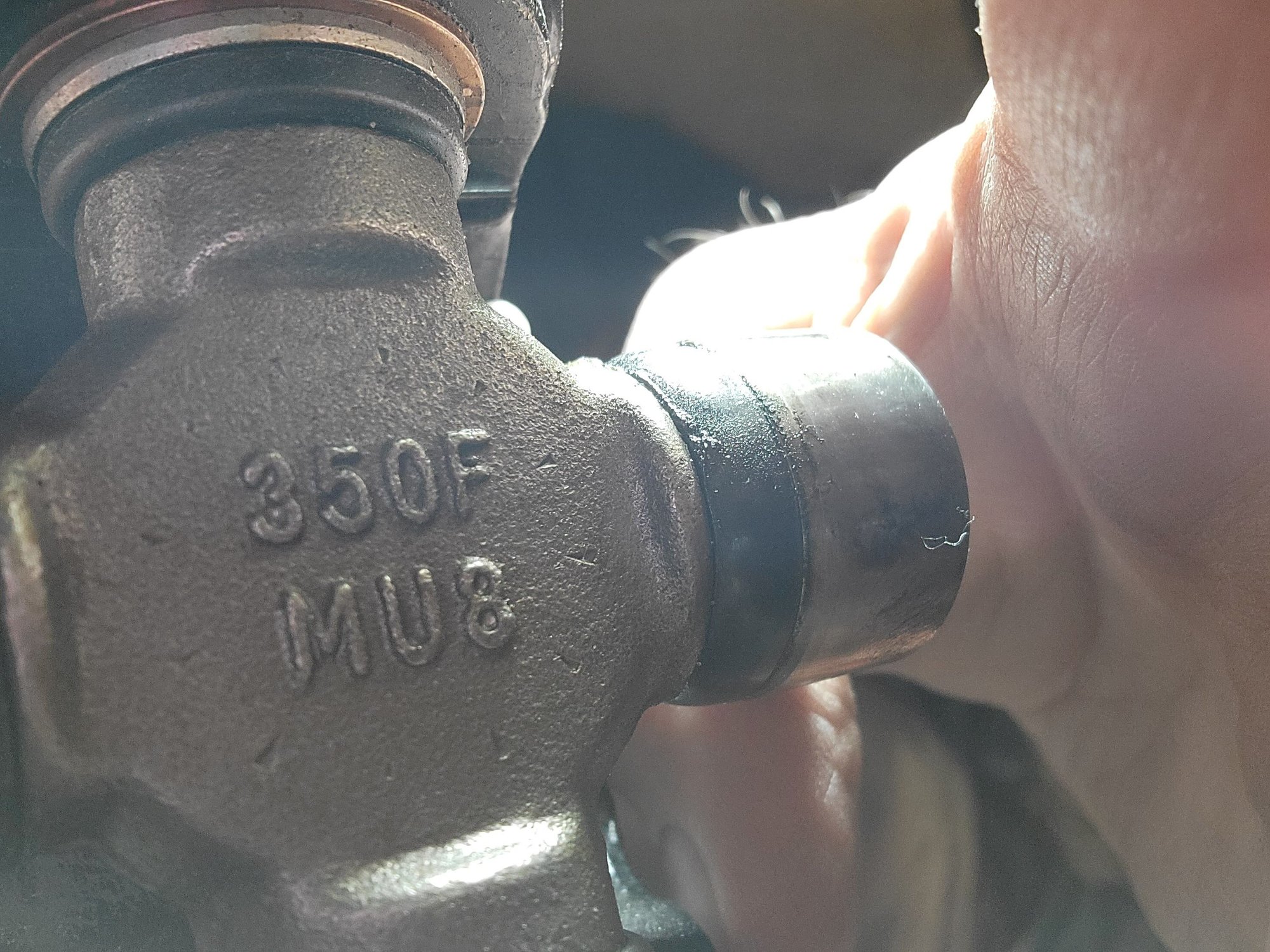

My 67 Cutlass has a a Chevy 12-bolt rear in it that I'm pretty sure is not original. I put a new engine and transmission in it so I replaced the u-joints to hopefully add some reliability. The yoke of the differential uses the larger u-joint and the driveline uses the smaller. I have installed the conversion joint from Auto Zone but when I tightened the caps on the diff yoke I noticed that the u-joint caps have a little extra room between the centering tabs. I moved it back and forth and tightened the bolts down with the u-joint centered as close as I could get it. This is not giving me a warm fuzzy feeling because if it is slightly off it will probably vibrate. Maybe not enough to feel during normal driving but I will always wonder... Anyone else had this problem or know of a u-joint that fits the diff yoke better?

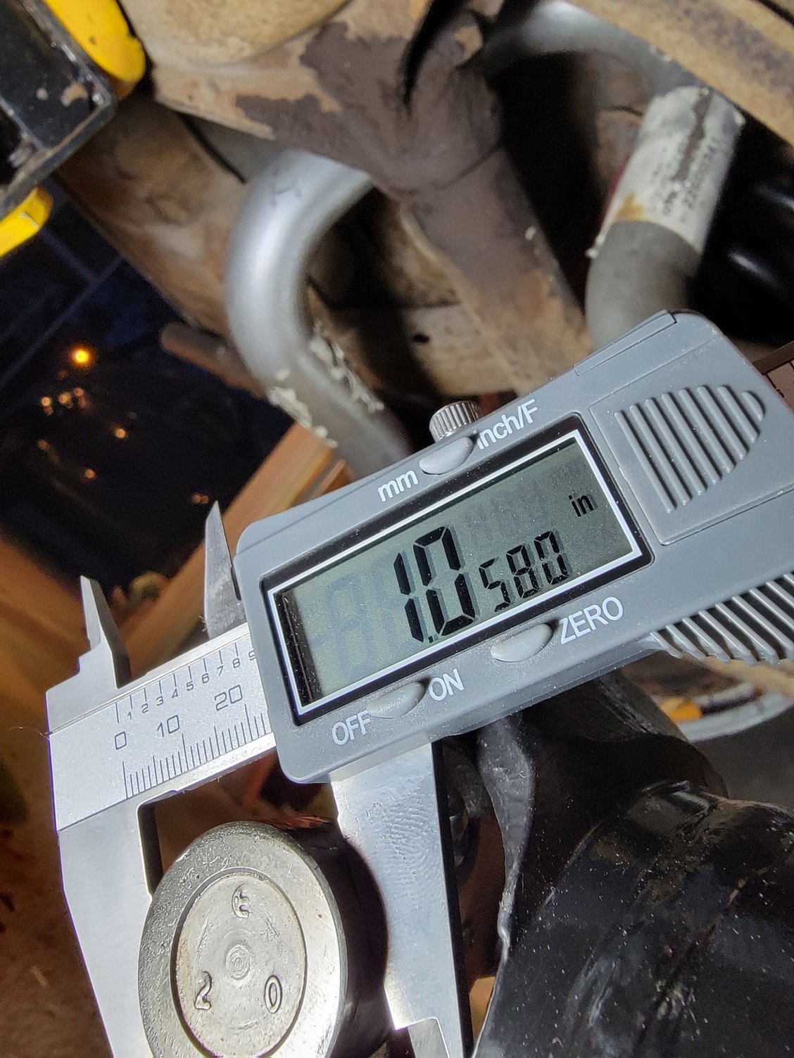

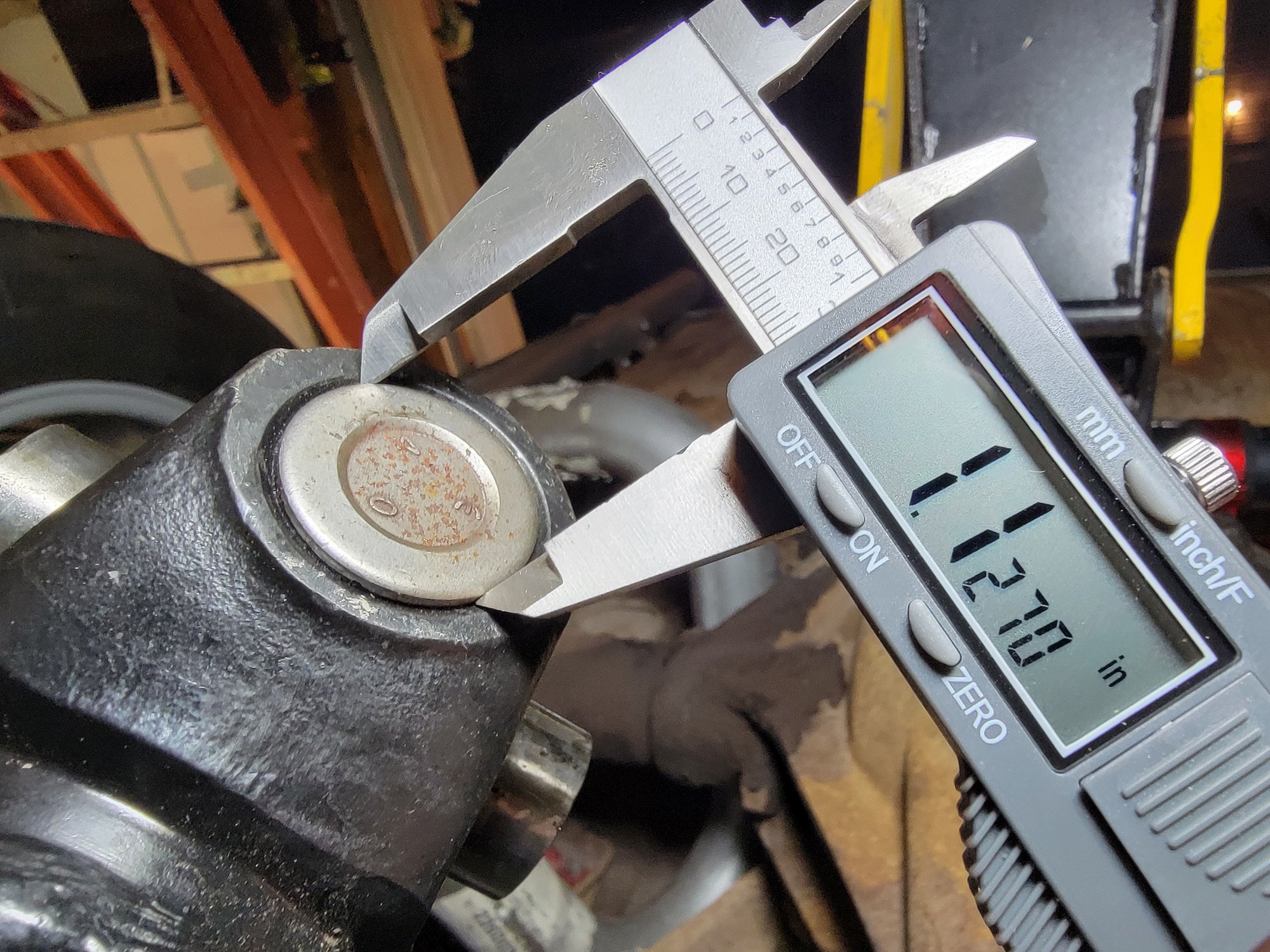

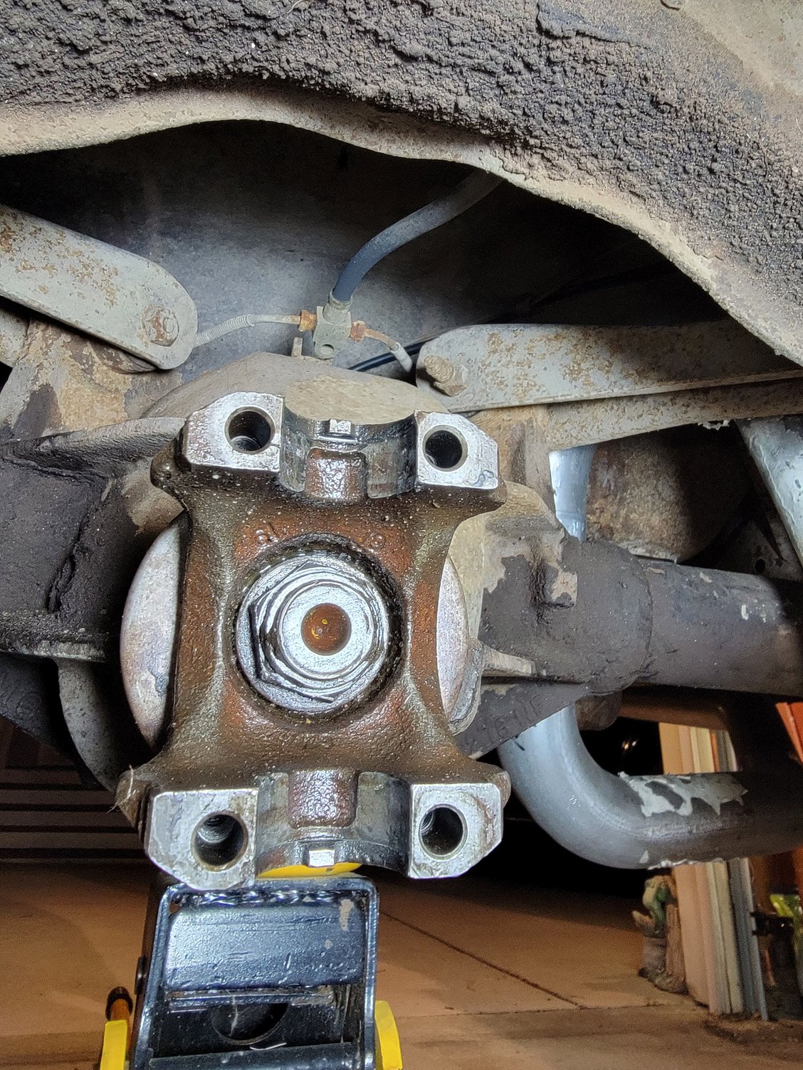

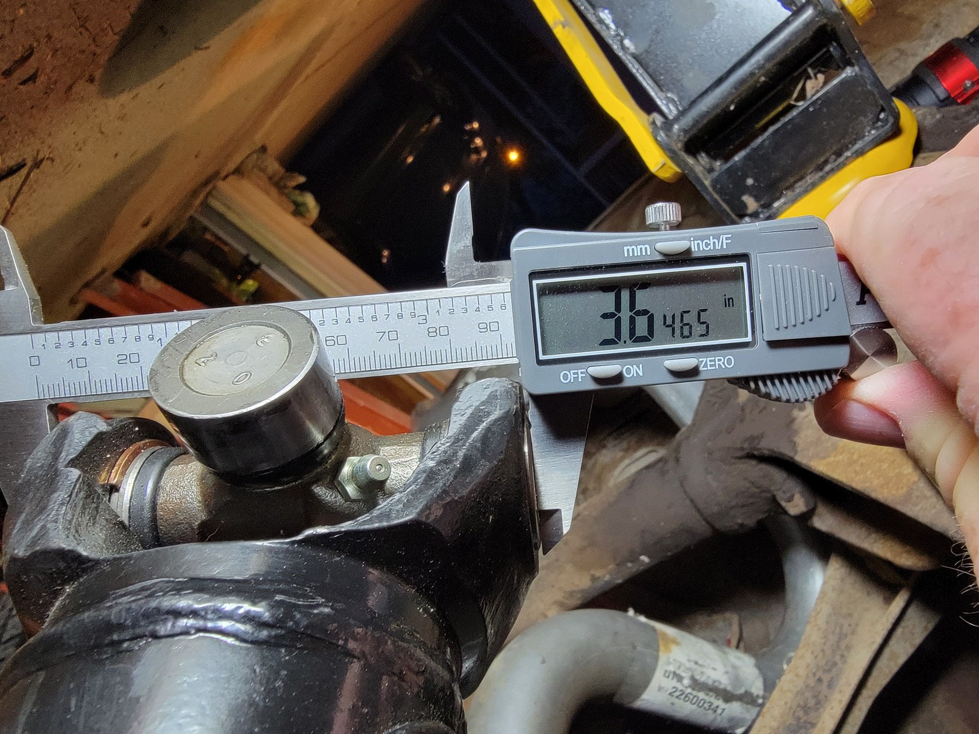

Ok, so it looks like I have a large yoke on the drive line and a small yoke on the differential. 4 bolts and two straps. The u-joint is supposed to be a transition joint so they can be used together. I have no idea when the Chevy diff was installed or what it came out of. The diameter of the cups all fit their respective yokes, the only problem is the side clearance in the differential yoke. One pic shows the amount of side clearance. Guess I need a wider transition u-joint. Pics...

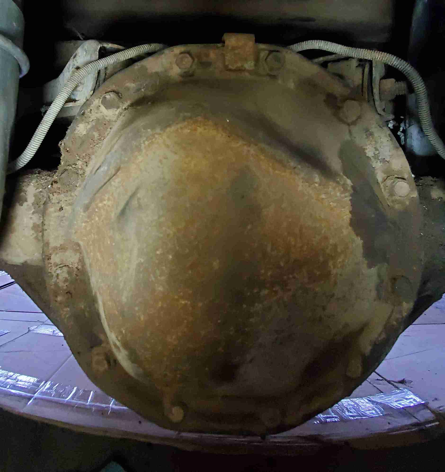

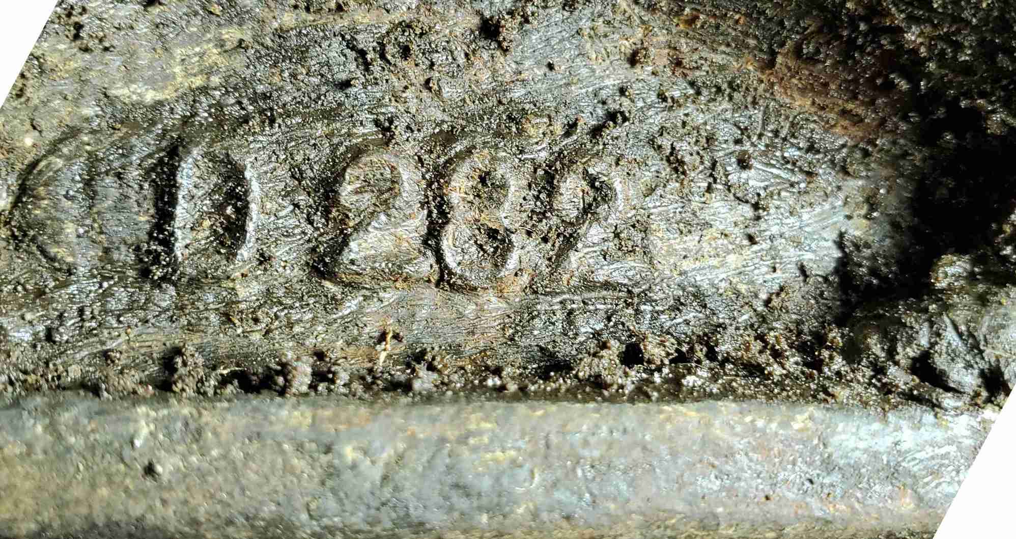

Here are the markings on the diff if it will help identify what it came from. The cast-in numbers are 0 282, and the stampings are KDC 123 2. Definitely a Chevy 12 bolt though. Joe P helped me to see the light on that one.

That is a conversion u-joint! Either the yoke is too wide or the joint is too narrow. 3.625 inch would never fit that yoke.

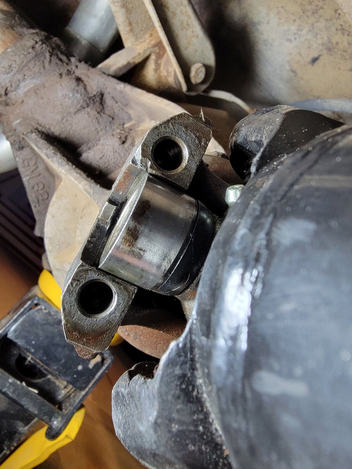

So, I took the drive line out again and was going to measure the saddle that the u-joint fits into and found that it is just completely worn out. Like many things about this car, it has been sorely abused at some point in its life. The guy I bought it from said his Uncle was a "Master Mechanic." That means because Uncle had been helping him with it the original carb leaked, the cooling system leaked, the head gaskets leaked, the transmission leaked, and so on.
Anyway, by centering the u-joint I was actually getting it settled into the saddle of the yoke properly. The alignment tabs are just so worn and the hold-down straps were so distorted that it would slide around quite a bit. I straightened out the straps that hold the caps into the yoke and it now holds the u-joint in place properly. Makes me wonder what happened in the past that made the the yoke so worn out? I'm glad I haven't been able to drive it any more than I have.

Yep, I get that with rears all the time. OH A PROFESSIONAL ASE mechanic installed all the parts. RIGHT!... Just because they passed a test does not mean they know how to use the info .
ANYWAY... The tabs like you said on the yoke are abused. You will need a NEW yoke or a MUCH better used one. MAny years of abuse and parts breaking and someone just reassembling each time bending twisting and hammering parts back together...

The u joint is what we refured as a BOP to chevy conversion joint
Moog 372
Mechanics 3R one way (1.125" cap) in the driveshaft and 1310 the other way 1 1/16 inch cap in the yoke.

YOU can see the damage / dents in the saddles where the u joint let go some time in the past. That yoke is totally junk. Get rid of it and get another or a new one.
Sorry it is just not repairable.
