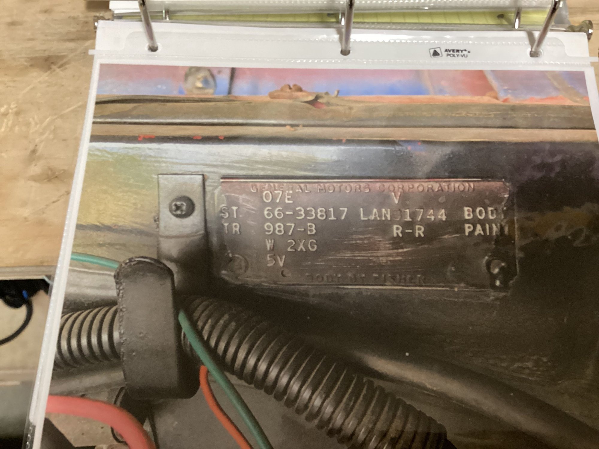

Trying to figure out my rear end ratio on my 66 442 Holiday coup that was originally an automatic, which I’m converting to a four speed. Doing this without the car as it is in the body .shop.
I attached a pic of the data plate.
My research tells me a 3.55 ratio is the best match as this will be a daily driver car. May add posi.
Thoughts anyone?

If your real question is "what is the ratio currently in my car?", there is no way to know that without either finding the code stamped on the rear axle or removing the rear cover to find the tooth count stamp on the gears. The cowl tag was used by Fisher Body to install options on the car as the body was built. Fisher didn't install the rear axle and thus nothing on the cowl tag will tell you that. In 1966 the standard ration with the 442 package and Jetaway automatic would have been 3.23:1, but 3.55 and 3.90 were available options.
