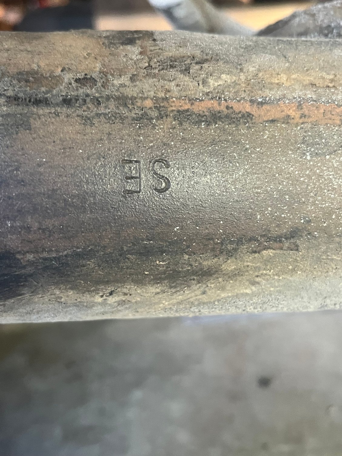

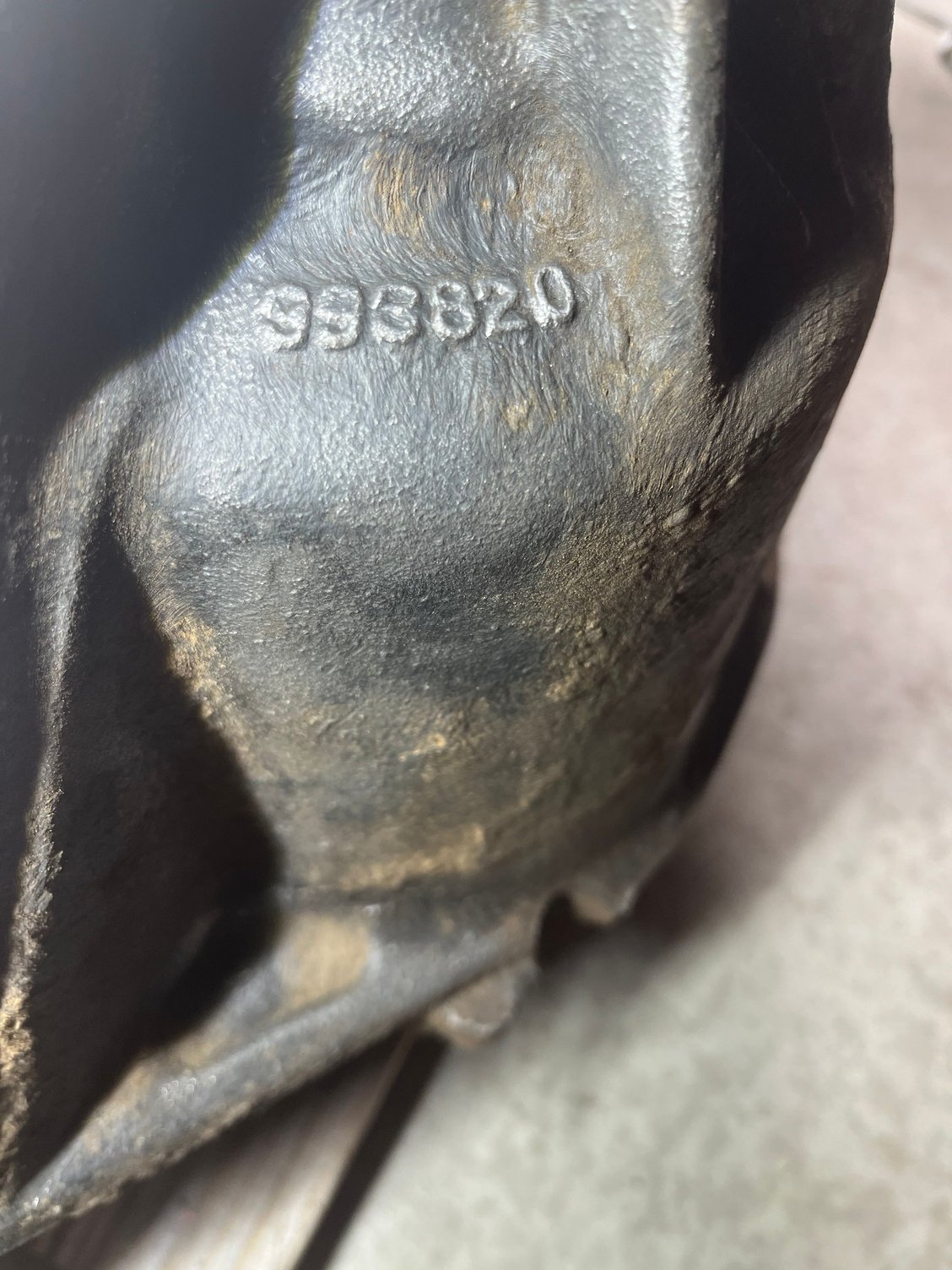

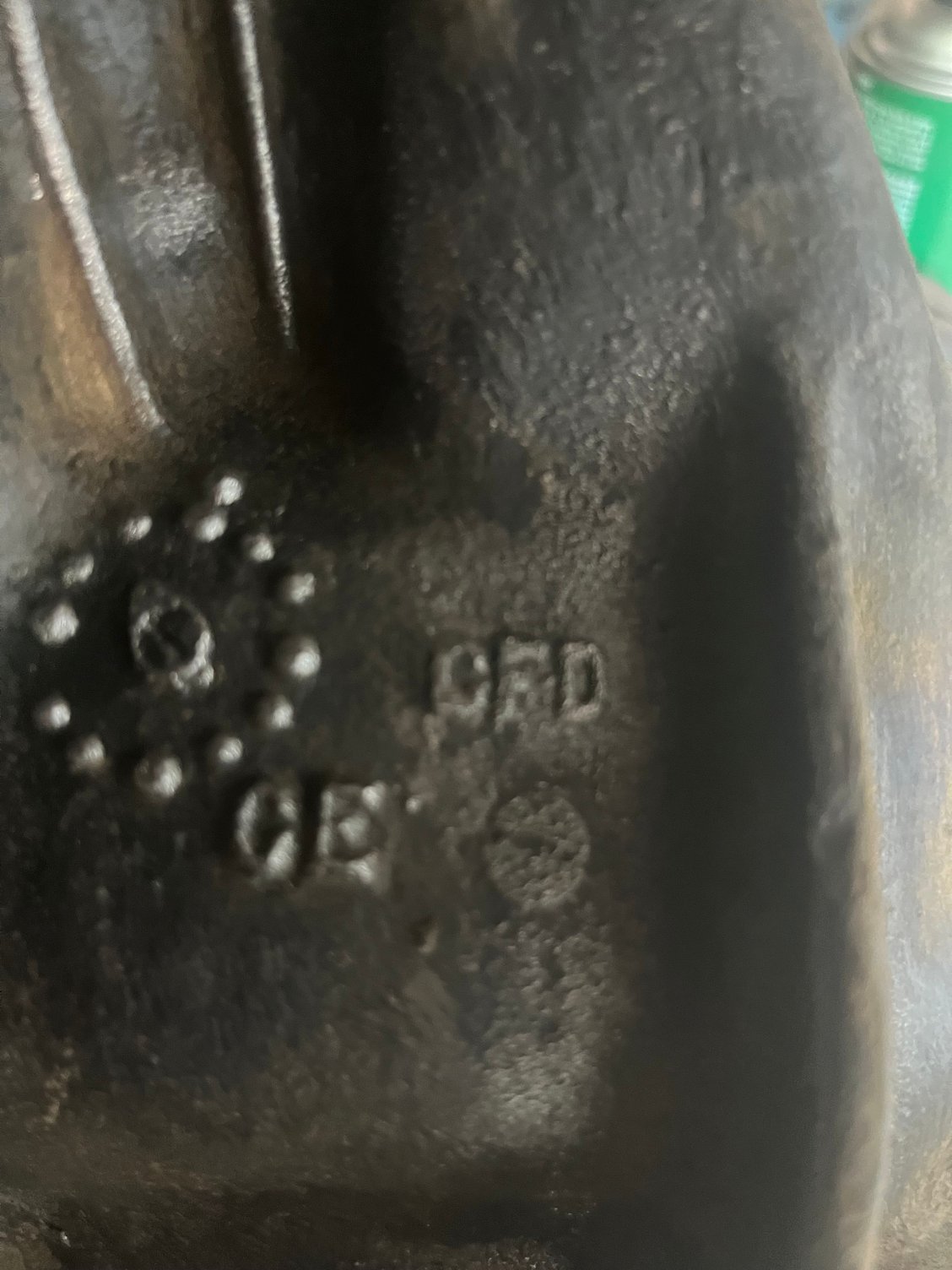

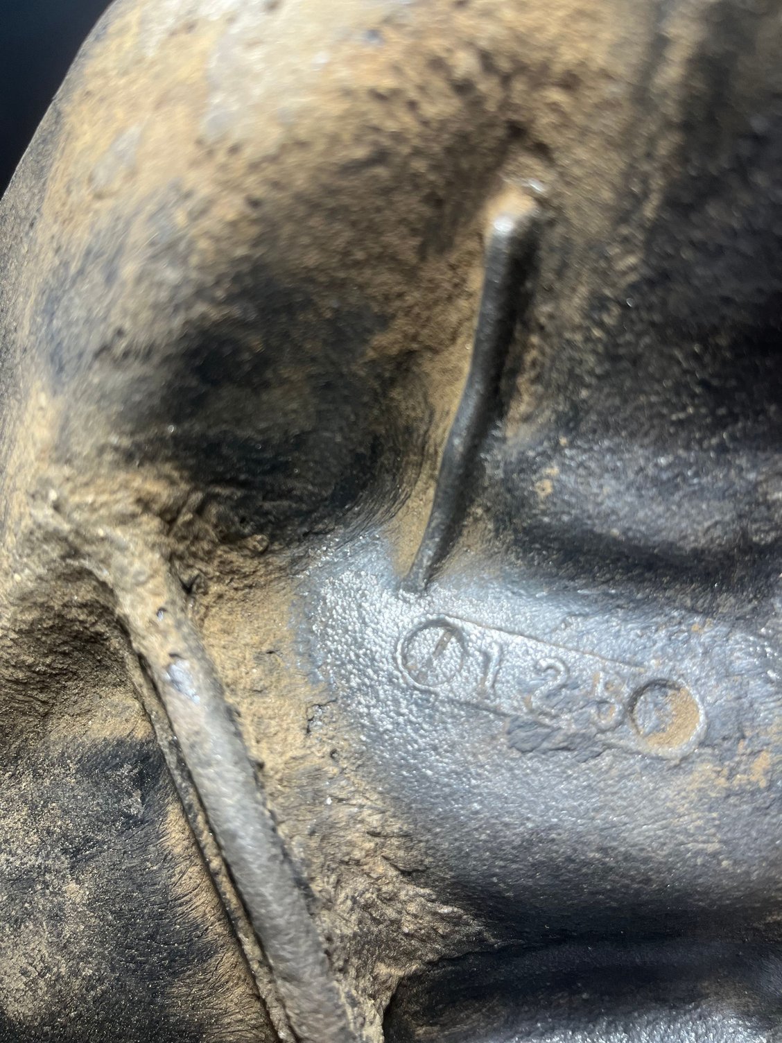

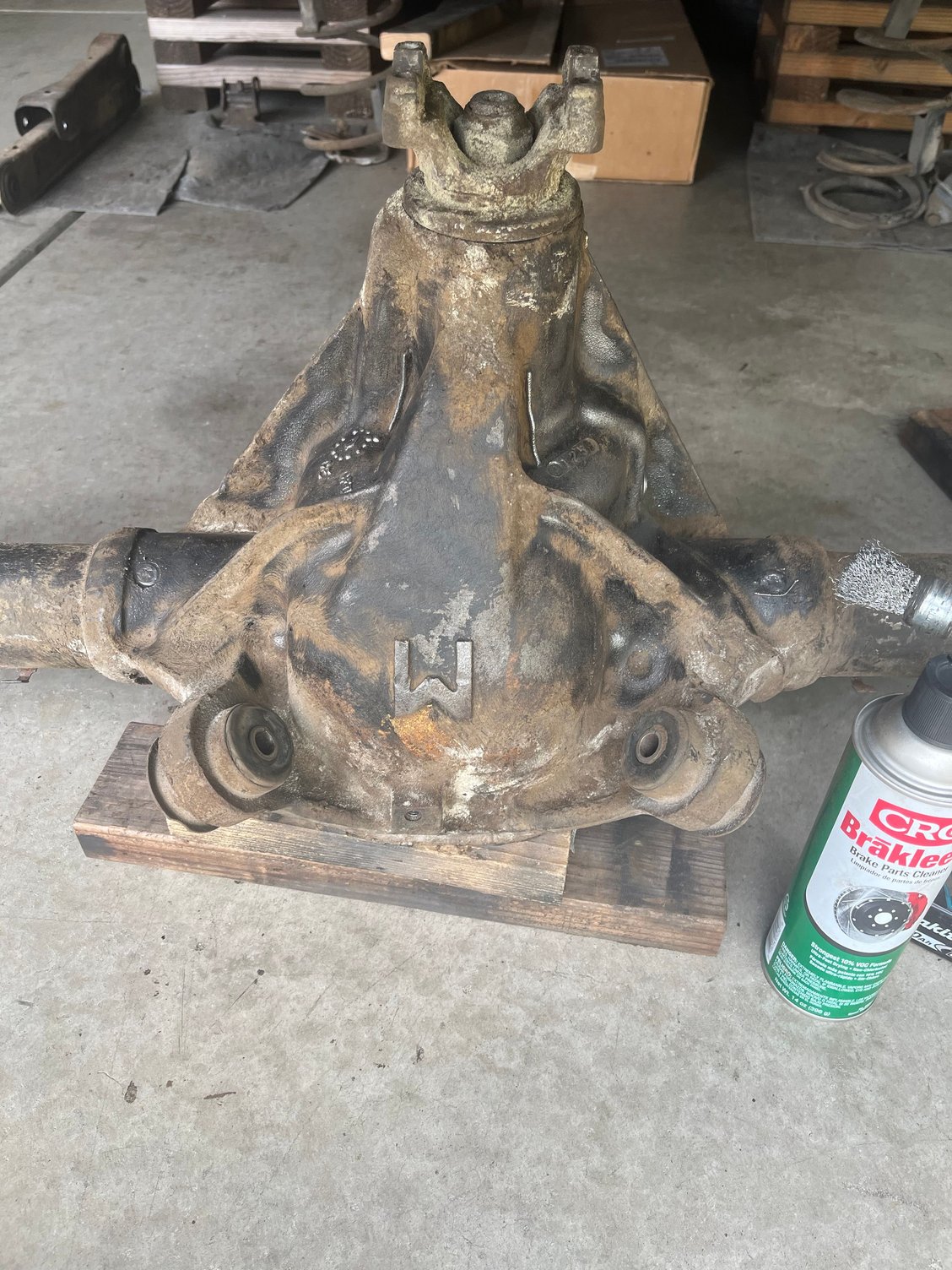

I’m down to rebuilding the reared on my 66-442. Trying to determine if this is the original reared or if it was a replacement.
In reading the above thread it makes me wonder if it was a replacement out of Chevy.
Casting #393820, ‘M’ stamped on top of the housing, ratio 3.23, 28 tooth axle splines, ‘125’ stamped on the housing(date code? If so, what’s the date, ‘CFD and CE also stamped on the housing, looks like standard coil spring pads (not flat plates’
J
Old Apr 9, 2026 | 02:39 PM
Posts: 50,857
3.23 was the standard ratio for a 1966 442 with either automatic or three speed manual. SE is the correct code for 3.23 gears in 1966.

Joe, thanks for the response. I figured the ratio/code were correct. The bigger question was about the ‘M’ stamped on the housing and the ‘125’ which I think might be the date code but need confirmation on that, and also if that would have been the original rear end or a replacement.

Still wondering if anyone has run into this M reared housing on a 66-442. In a quandary whether this is original to my car when built or changed/added somewhere down the road. Was thinking about changing ratios to a 3.55, but could only find a 3.42 ratio for the 8.5. Any help/info is appreciated.
Old Apr 12, 2026 | 08:26 AM
Posts: 15,446
The O-Type had limited ratios, with different carriers for each “series”:
2.56, 2.78
3.08, 3.23
3.42, 3.91, 4.33, 4.66, and 5.00.
Today there are very few aftermarket gear sets available.
Old Apr 12, 2026 | 08:30 AM

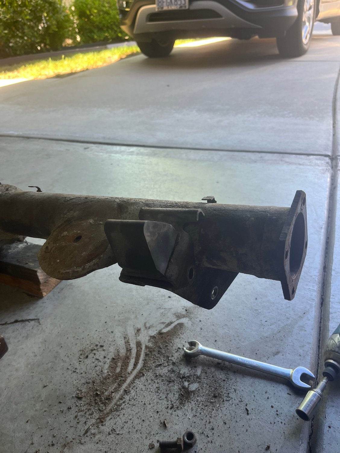

So the spring perch mounts are a DEAD give away to a 1966 era rear end. I personally did not know 12 bolt Oldsmobile 8.5 ever came with the flat cup and bolt perch.... BUT 7 to 10 years ago there was a post we were all in and trying to figure out if that was a real 12 bolt cover 10 bolt ring with flat perch housing... SOoooo I guess they did produce the 1966 12 bolt cover rears.... I always though they were 67-70.... BUT when there is ACTUALLY Physically a person that has one with factory welds you can not DENY it exists. I have been doing rears for almost 40 years now and STILL learning and discovering things exist out there. Jim

I'm pretty sure I was involved in that discussion about the 66 O Type rear axle. It's even listed in the 66 assembly/PIM manual in the rear axle section. I have personally parted at least 3 66's that had them.
