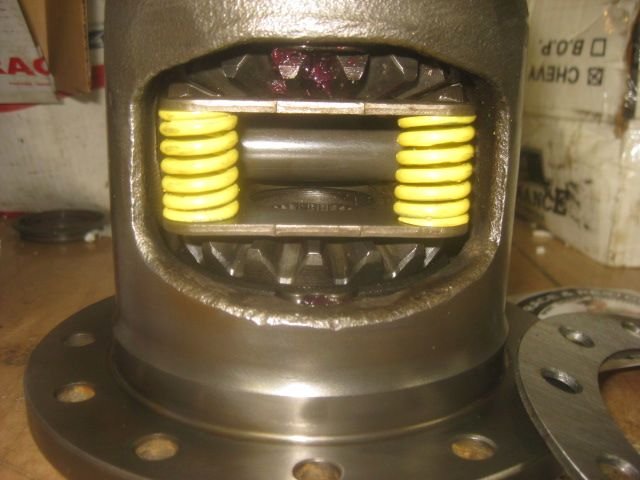

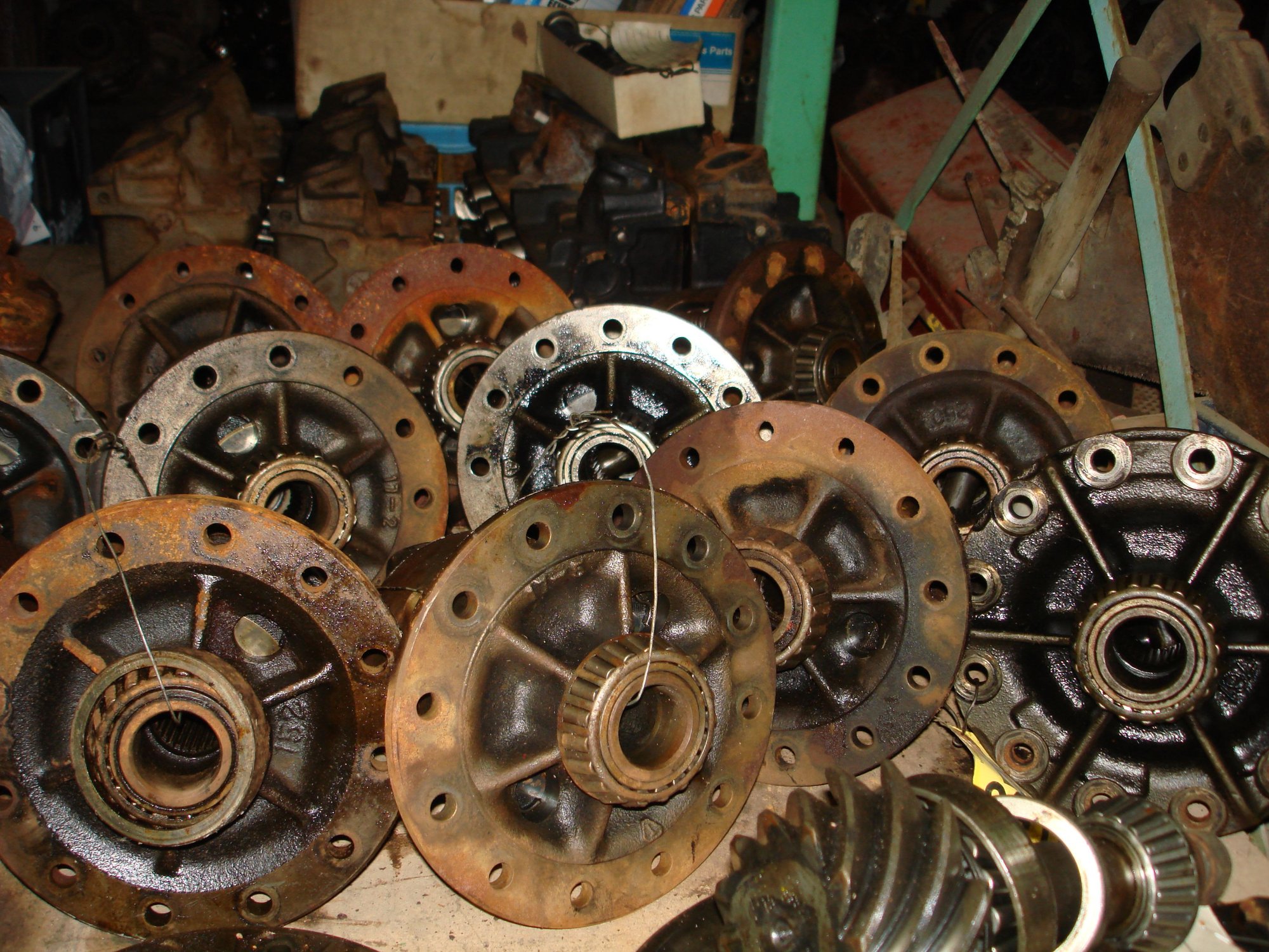

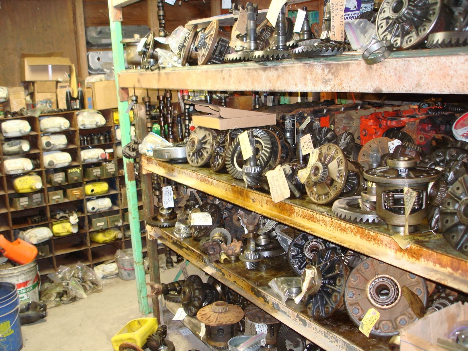

I have several of the eaton posi units for fullsize cars.I rebuild and blueprint posi units as well. Feel free to call 518-234-2480 I'm in upstate NY.
