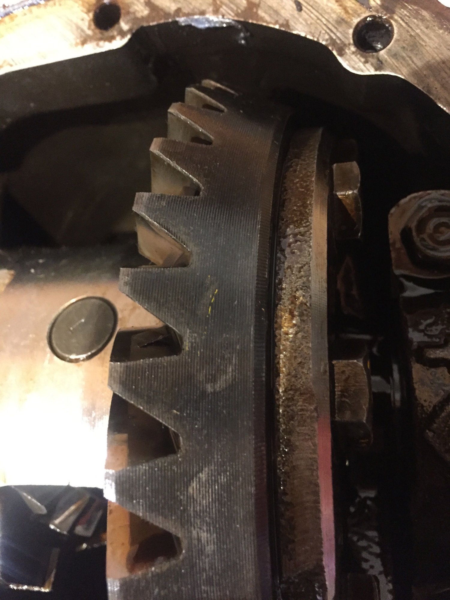

Upon further inspection and looking through posts here's what I found. Sorry I've edited this 5 times already.
Looks like 40A13 GM KN 342 2
There's the grease pencil 6 I was talking about.
This looks like 123787 343
Looks like 13A40 GM LD What do you guys think of that gear? Gouges a concern? It does click when you move it back and forth and spins with no effort. The fluid looks like a metallic paint.
SD 0004 on the front passengers side of the tube. Looks like this is the first non original part I've found. Guessing Chevy rear. 343 or 342?

40/13 = 3.08:1
Old May 23, 2018 | 06:22 PM
Charlie Jones's Avatar
Phantom Phixer
Posts: 5,534
From: Apopka, FL
Not a good sign .
Can you show us photos of the gear teeth wearing surfaces ?
Maybe take a magnet and run it around the bottom of the case . Or better yet , swirl it around in the fluid if you still have it . If a lot of those flakes stick to the magnet , you have a problem .
Was the rear noisy ?

It hasn't been on the road for at least 30 years and my friend that I bought it off of always complained it chattered around corners. He bought the car in the late 70's and pretty much never beat on it. I thing whoever owned it before him pounded the snot out of it. The fluid looks like metallic paint and the rear is very lose and sloppy. As of now I think it's a Chevy rear so I'm thinking the previous, previous owner blew the rear to pieces and replaced it with this one. Then old habits die hard. So far it's the only piece I've found that wasn't an original.

It looks like some pretty heavy wear on the ring / pinion gears .
Still , it is a Posi . And it's probably worth re -building .
You will probably need a new or good used ring and pinion , as well as all bearings and clutches etc .

Those gears visually do not look bad at all. BUT you really should put a dial indicator on the ring gear tooth and see what it is. .006-.010 is pretty good for used gears.
This is a BOLT in axle 725 casting Limited SLIP traction lock OLDS rear.
3.08 gears we all know that from your 13 / 40 tooth count.
The clutches are steel and probably where you got most of your metallic material. ONLY truer way to know what is causing the metal in the oil is checking all the bearings , backlash of the ring and pinion and feeling the ring teeth and pinion teeth for indents in the faces.
Pictures sometimes give a false reading with shadows of the gear mesh rub marks etc.
DO not write it off until you check everything.
If the gears or rear is grinding and making all kinds of noise straight and turns you certainly have issues.

What concerns me is how easy the rear spins, there's zero resistance and when I move the ring gear or the axle and it takes about 1/4'' turn before it moves the pinion. I have a 2.78 rear I picked up last year and that takes some effort to move and instantly moves the pinion gear. I assisted a guy years ago in rebuilding a 10 bolt Olds 2.78 posi that was in my then Cutlass and the clutches were grinding something fierce in a snow storm, so I never went near a rear again. Now I'm much older and less intimidated so I'll have to pick up a dial indicator and see what I come up with. I'll have to do the amateur thing and watch the dreaded Youtube to get an idea. I think there's also an illustration in one of my Motors text books from that era.
Thanks to all for your help. Good to know it's an Olds rear. I'll let you guys know how I made out.

Measure pinion depth, back lash etc. I would also say it is rebuildable, just inspect everything and replace as necessary. Good luck.

NOW being 40 years later...you never know what your car will have...lol. Just ID it and build it.
J D Race
Jim Mitschke
File Type: jpg
