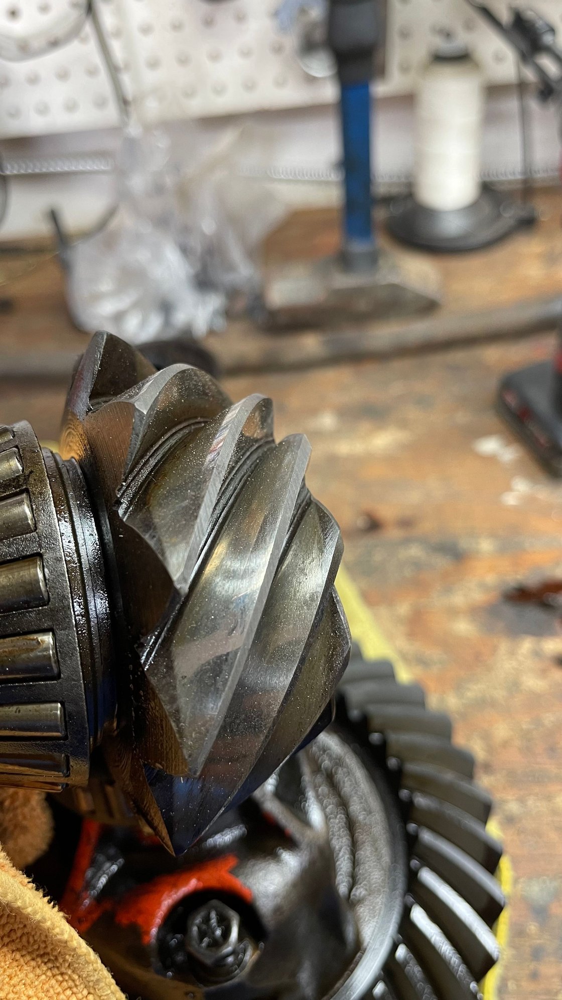

the time has come to decide what to do with the rear of my 65 442. should i rebuild with the factory housing or go another route? i am not planning on racing this car but i would like a nice medium between performance on take off and efficiency on the highway. the car will have a 400 engine with muncie 4 speed transmission. i am tearing down the housing now and will be dropping it off tomorrow to be powder coated the same time as the frame.

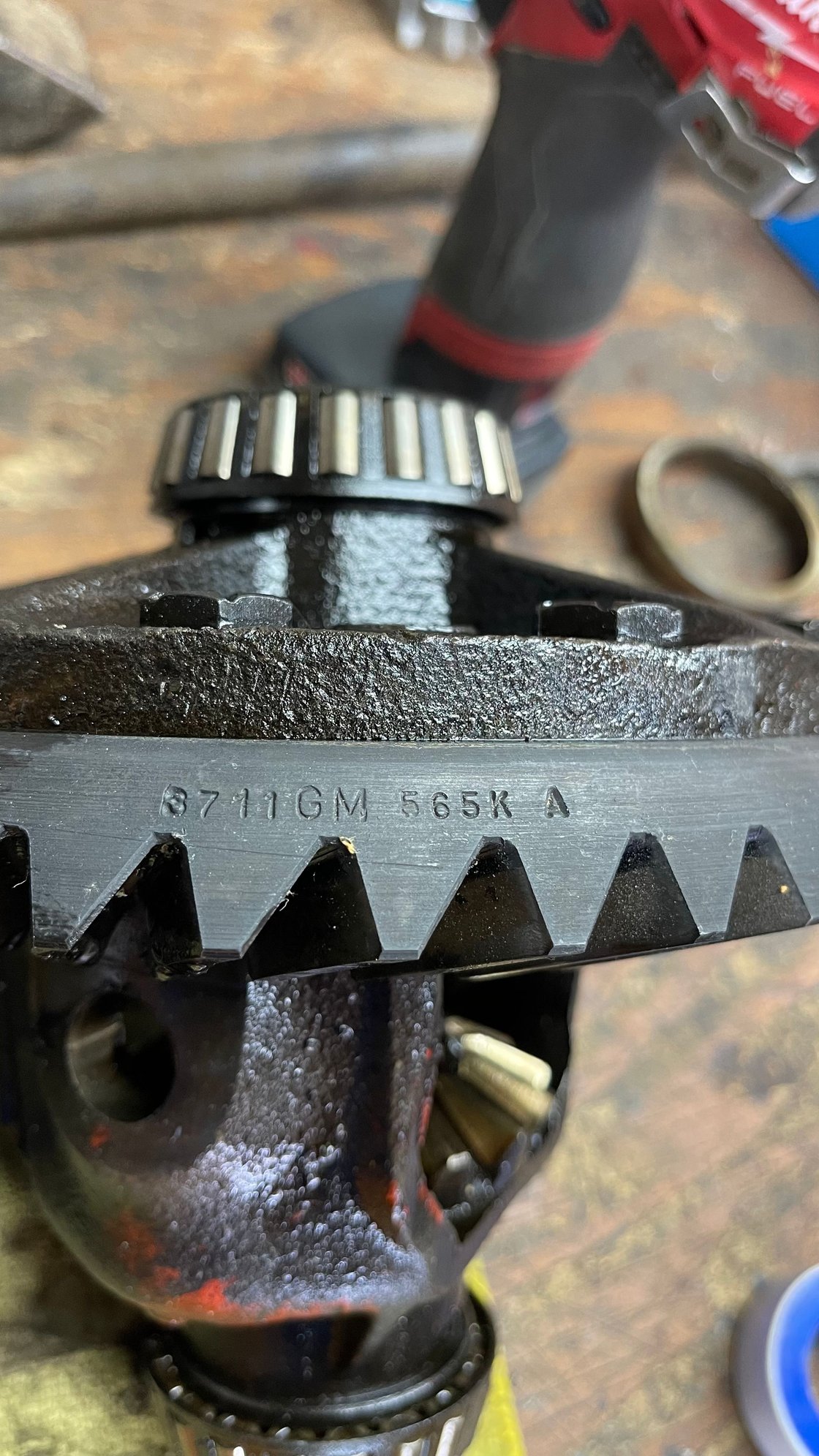

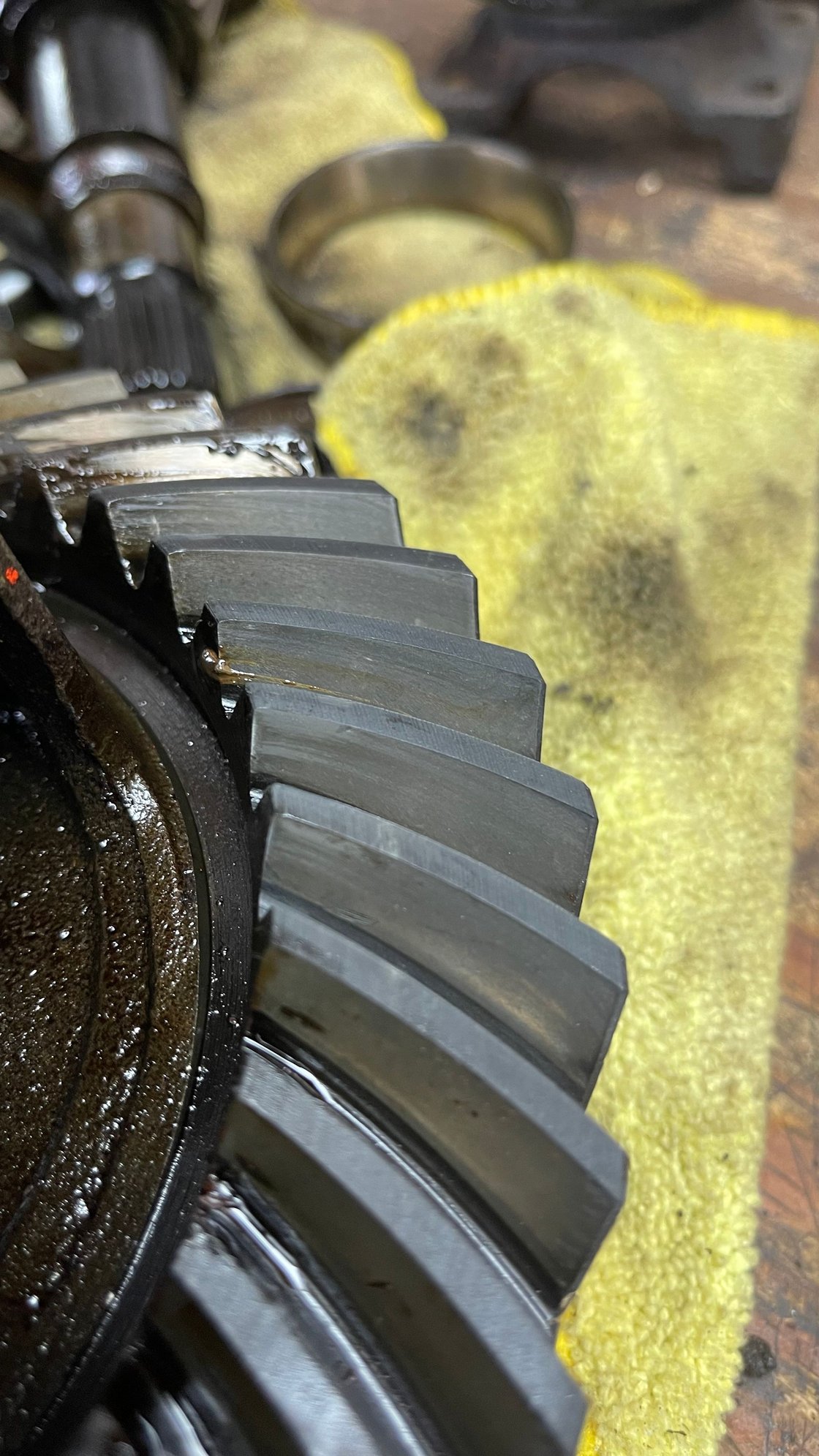

IF you like the gear...(3.36) should be good for most driving applications still enough grunt but also capable to hit the freeway too .
THE posi unit is where you need to open up and see if the cones are bottomed out in theunit. IF they are we can machine the cones and towers etc. to make it live again.
BUT all NEW bearings and seal through out using all the same shims and pinion shim should be able to just put it all back together and not set up anything.
BUT you should always double check just to be sure .007 -.010 is a good range to be in. THE used gear will likely set up better in the .009 area
From the pics the gears look fine.
It appears that does not look like a POSI ... so you would need one of those if you want to leave 2 Black tire marks on the ground.
IF you do not do burn outs or spirited performance driving ...then LEAVE OUT THE POSI option...It is just a Noise maker for a driver like you.
Open diffs will always run quieter and less heat and less oil changes. LESS Maintenance period.
