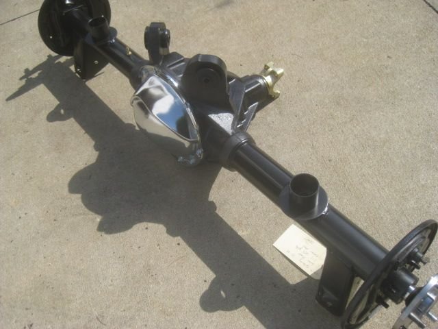

One of the biggest questions is WHERE the car will be driven...Street driving really does not hold torque and power and you can usually get away with ANY rear to to the job.
Stick shift cars will usually put more of a hurt on drive line parts and especially the way customers drive them banging gears popping the clutch in every gear thinking it will make the car go faster...lol.
Tally up the parts cost and see where you are - If the car is a KEEPER more than 5 years Wait and get the bigger rear... If this is a weekend might sell for school college money just build the 7.5 and roll he dice
I just build the 12 bolt Moser rears for the G-bodies as like someone else said for the amount they want for a GN or 442 8.5 rear you might as well spend another 500.00 and get it all
Correct width bolt in with out changing control arms, any ratio any posi 1/4" thick HD tubing and casting super thick main bearing caps are twice as thick as stock cap bolt are larger and caps machine screw
Remember you can have all the best parts in a engine Trans and rear...BUT if you do not install them correctly...It will all be junk quickly.
Play with big boy toys you better have the money to play....
Jim
J
D Race

Parts
You have 14000.00 into a 350? (MUST BE some serious stuff)
and 4500 in a 200r4?
I thought 3250.00 for a FULL out race Power glide SFI race case trans brake alloy input shaft set-up was way out of wack? (I just did not have time to wait for a local to build me one...)
If you spent that much in a motor and trans...You should NOT start getting cheap... Just saying...Finish the car right as just one weak link and all that money is sitting on the side of the road.
That rear pictured is 2350 cash! (who knows what prices will go up next year?) ALL new everything.
Jim
