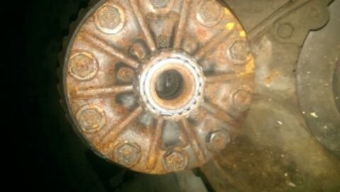

I have a 1968 cutlass supreme. I am not completely sure exactly which rear end I have. It's been a couple of years since I've pulled the cover off. The cover has 12 bolts if that helps. I do NOT have a posi in my rear end but would like to add one. A guy in my town has a brand new Richmond 3.90 gear set, a posi and a posi carrier. He says the carrier is 12 bolt. He would sell them for 200 for everything. What do I need to do to find out exactly if it will fit and possible to use before I make the purchase.

So what are the above pictures from? It looks to be a 673 carrier, which is an O-Type posi carrier for the 2.56-2.78 gear ratios. I can't make out the numbers stamped in the perimeter of the ring gear to determine what the gear ratio is.
12 bolts on the cover of the rear in your car means either an O-Type 12 bolt (original equipment in most all 68-70 Cutlass models) or a Chevy 12 bolt that could have been swapped in at some point. You would need to check for the number of bolts holding the ring gear to the carrier, which for the O-Type would be similar to the above picture showing 10 bolts.
If his carrier has 12 bolts holding the ring gear on (meaning Chevy 12 bolt), it won't work in an O-Type, which has a 10 bolt ring gear.
thank you for your reply. I will remove the cover and see exactly what I have. Those pictures are the posi and carrier and the gear set he has for sale. He sent those to me.

Another question is since the carrier is a 673 can the 3.90 gears work on it?

Also 673 carrier will need a spacer plate to work with aftermarket Richmond gears. Will not work at all with GM 3.90 gears.

Where can I get a spacer? So if I get the spacer the 673 carrier and the Richmond gear set 3.90 will work?
