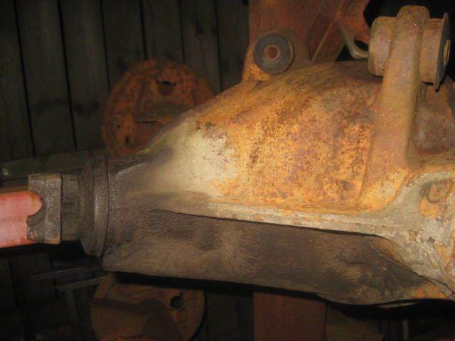

I have acquired a 31 spline "O" rear 3:90 posi. I'm hoping to speak with someone knowledgible about these rears.I have been doing rears for 40 years and this is only the 3rd one I have encountered.This particular rear I'm sure has never been opened up until now.I say this because it still had the black heavy gear lube I'm used to seeing in only older rears.All the bearings and seals are OE.There are some paint marks near the yoke.In any rear ,especially one that was used hard there is always metal transfer on the mating surface of the upper left cap mating surface.This is the highest stress point,this rear has a special bolt in that position.I think this rear is a good candidate to learn from.This rear will be for sale,but I want to know more about it first.

The 31 spline axles were only used in 67/68. It's actually called a 3.91 but that's not important. The T3 code was also used in 69 but as a 28 spline unit.

Seems as if you already know a lot about it. What additional info are you looking for?

672 is the only limited slip casting for the 31 spline. Meaning you can only use 3.42 3.90 4.33 4.66 5.00 ratios
Axle bearings are sealed rw507cr
Again this was a W30 only option 1967 1968 years.
CArrier bearings are LARGER in this housing as it uses the larger 3.062/3 carrier saddle diameter where as all the rest use the smaller 10 bolt carrier bearing diameter of 2.890 saddle . because they only had 28 spline axle shafts
Clutches are interchangeable with the other 2 3 4 series 28 spline units too.

I can see that your Limited slip is toasted so that will not be a easy replacement - 2 year rear and not even all those were posi either.

Specifically,I was wondering if the paint marks are of any signifigance,also the fact that the upper left diff cap bolt is different.I thought this rear may be a good candidate to learn from as I'm sure it has never been apart

My original '68 T3 rear did not have a different bolt in the upper left position.

If you look close at it ...it appears the bolt head was shaved lower and dimpled? For some reason someone did this? That is not the way any bolt comes from the GM factory.
Paint marks... always mean something... I know GTO guys get that info for their cars there were paint swaps on th e outside and in th e case. I know on the caps GM will make a paint mark so you can install the caps back on correctly...BUT years of oil changes and people cleaning with brake cleaner marks disappear and the reason we punch the one cap and reference to th e case adjacent to the cap.

pictures.
rear pics you wanted - This is the special 65 only GTO rear guys want as it was the only one used in the GTO. Does not have the converging ribs KNOWN with the Pontiac rear and these were used in the Olds HD engine applications we have found them in the 442 also. Seems the Olds and Pontiac still shared the rear end parts here again. It is cast as a Pontiac with the 97 in the casting as most all 8.2 pontiac rears were. ...so There is your B and P no O so there you go, Monzaz is wrong (making everyone happy.) But the A-body Olds used this rear under there cars with the Big motors and the lower powered motored Pontiac and olds got the Buick 8.2 rear. both the buick and This rear use the BUICK type yoke and seal same as in 1964
reason we consider it olds rear is the Buick uses the same pinion seal 8620 Pinion seal and ALL Pontiac 8.2 rears used the 2043 pinion seal (converging diagonal web casting from the upper control arm ears to the pinion snout) just a half breed rear one year only deal shared by the A-body GMS. Pics are there.
you can see it only has one vertical rib on the passenger side of the pinion snout... but not on the other.
