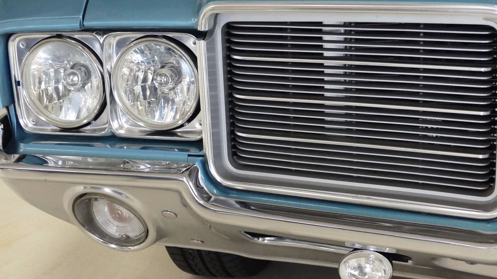

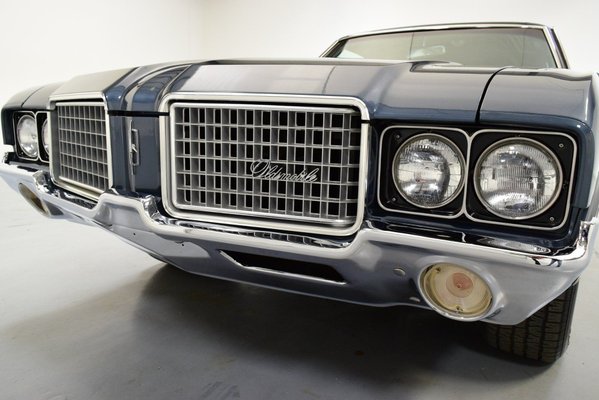

The 71 has a raised peak in the center of the trim. The 72 has more of a flat piece except for the outer edge lip is raised. Physically they will fit either year, but they look stupid if you mix and match. Hopefully you can make out the detail of the 72 example below.
1971:
1972:
