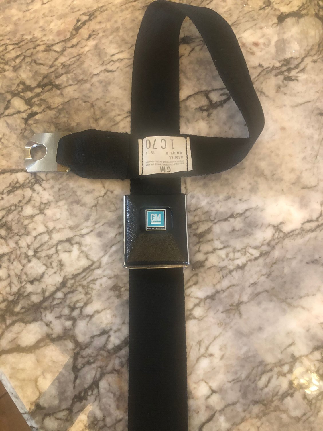

As noted, soaking with a cleansing agent of your choice is effective. My seatbelts front and back were a filthy greasy mess (’70 442). Plus, the black paint was chipped off the buckles especially bad on the front set.
This is what I did: I soaked webbing and buckles in Oxyclean and cold water for about a half-day. I checked on them about every hour to be sure things were ok.
At the half-day mark, I removed each belt and placed it flat on the bottom of the kitchen sink and I went over each piece of webbing and buckle lightly with a brush. A thorough rinsing of each buckle and webbing is necessary.
After blowing the buckles dry with compressed air, I placed everything on the screened porch to dry for several days.
Using a thin artist brush I applied two light coats of semi-gloss black chassis paint to the buckles. The paint is chip resistant and dries to a very durable finish. After painting I shot a very short burst of synthetic lubricant inside each buckle. Of course, your buckles may not require paint.
The seat belts look brand new. I’ve attached a picture.
Good luck with yours.
