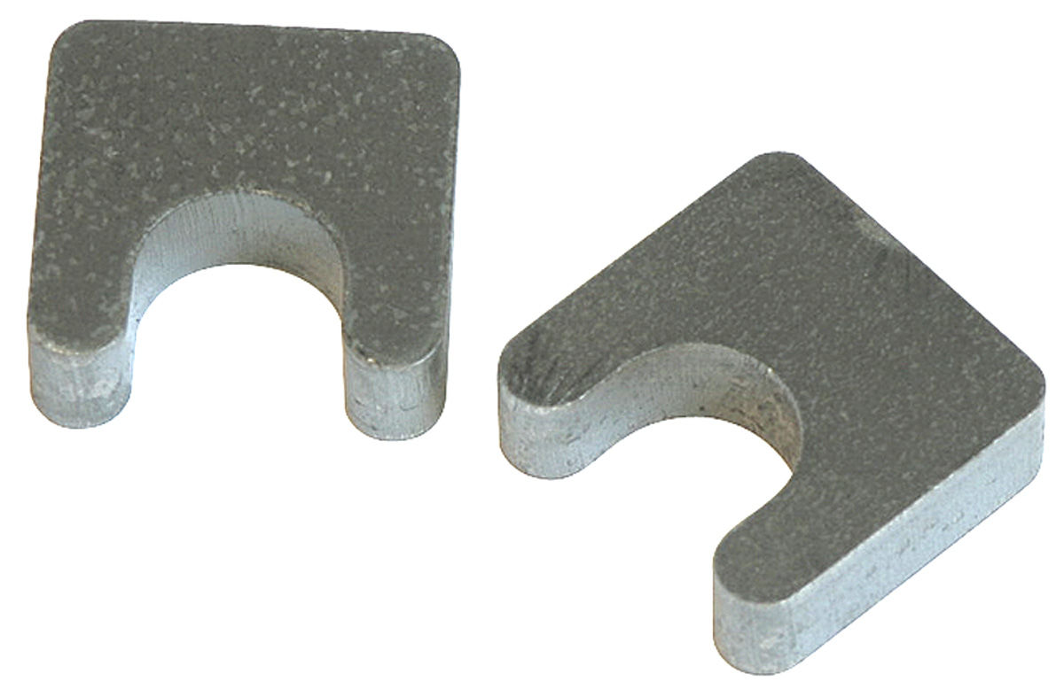

Did you reinstall the thick spacers at the rear of the hinge, between the hinge and the hood? Sometimes these fall out during hood removal.
