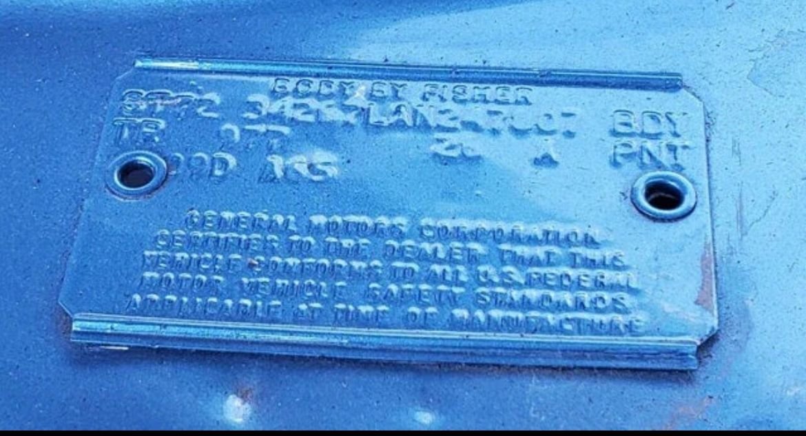

I see that this is an old post. This is not the best picture but a vehicle I’m looking to purchase. Can someone see well enough to decode my cowl tag?

Yours will probably be shifted to a new post but here's my best shot at it.
ST72 = style/model year = 1972
34267: 3 = GM division = Oldsmobile; 42 = model series = Cutlass Supreme; 67 = body type = convertible
LAN = assembly plant = Lansing MI
247807 BDY = Fisher Body number (has no relationship to the VIN)
TR 977 = interior color = white
26 = body color = Viking blue
A = convertible top color = white
09D = time build code = September (09), fourth week of that month (D), 1970 (this is an early production car; gearing up for production of the next year's model car usually started in the middle of August of the previous year)
A65 = option code = notch back bench front seat
Randy C.

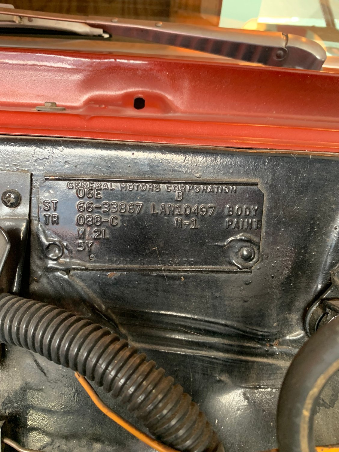

Anyone want to give this one a shot? I’d appreciate it.
Randy C.
I just don’t understand where someone gets 1970
Am I really missing the obvious??
Old Jun 9, 2025 | 12:32 PM
  #32
Posts: 9,477
This is a 1972 model year Olds as indicated by the ST72 at the upper left of the tag.
Exactly. Perhaps they were responding to the other cowl tag but specifically called out all of my paint color, interior color, seat type, etc but then also said it was an early 1970 build. That’s where I’m lost.

Probably just a brain fart.

Yes, indeedee, a slip of the "essentially tremored" finger on the keyboard! The car is a 1972 model year; the build date is September (09), fourth week of that month (D), 1971.
