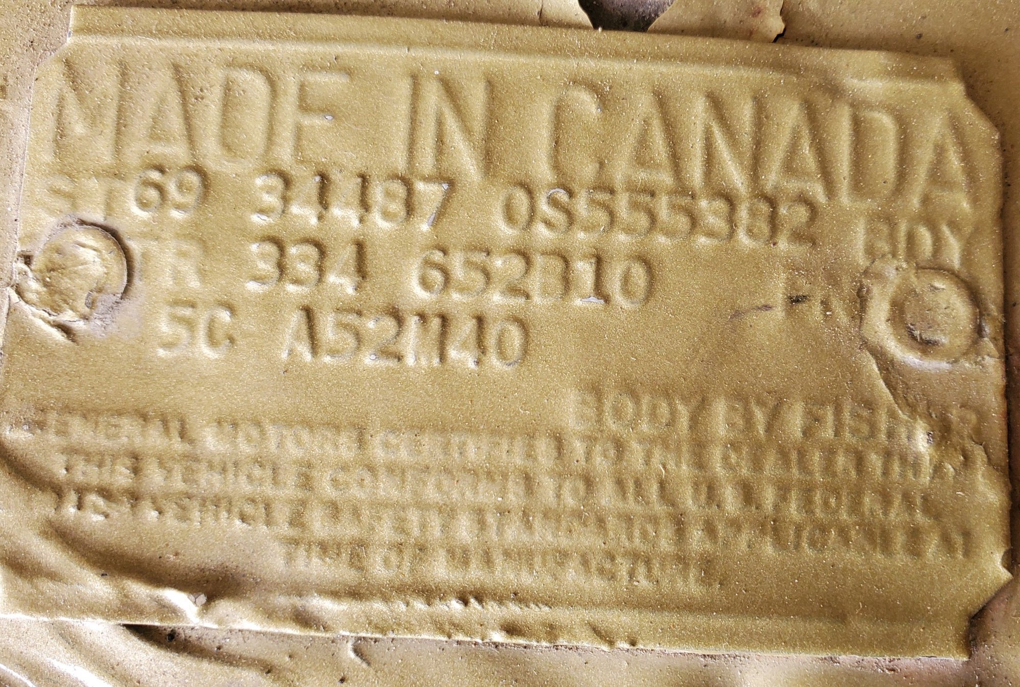

I'm sorry if i posted this in the wrong spot but would someone be able to help me decode this please
Old May 3, 2021 | 05:25 AM
Posts: 50,770
ST69 = 1969 model year
34487 = Oldsmobile division (3) 442 model line (44) Holiday coupe (87)
OS = Oshawa, Can assembly plant
555382 BDY = sequential body build number
TR334 = gold bench seat interior with cloth/vinyl trim
652B10 PNT = Topaz Poly lower body color (65) Black vinyl top (2B) with Black (10) pinstripe
5C = built the third week (C) of May (5) 1969
A52 = bench seat
M40 = TH400 transmission
