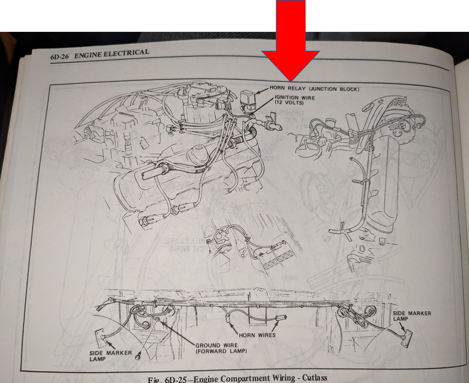

Cant find it. The + battery cable goes to the starter. Where do i find the horn relay junction? Service manual talks about it but doesnt show it. Thanks

If it is like a 75 (probably) it is on the firewall near the driver's side valve cover.

The Chassis Service Manual is your friend...
