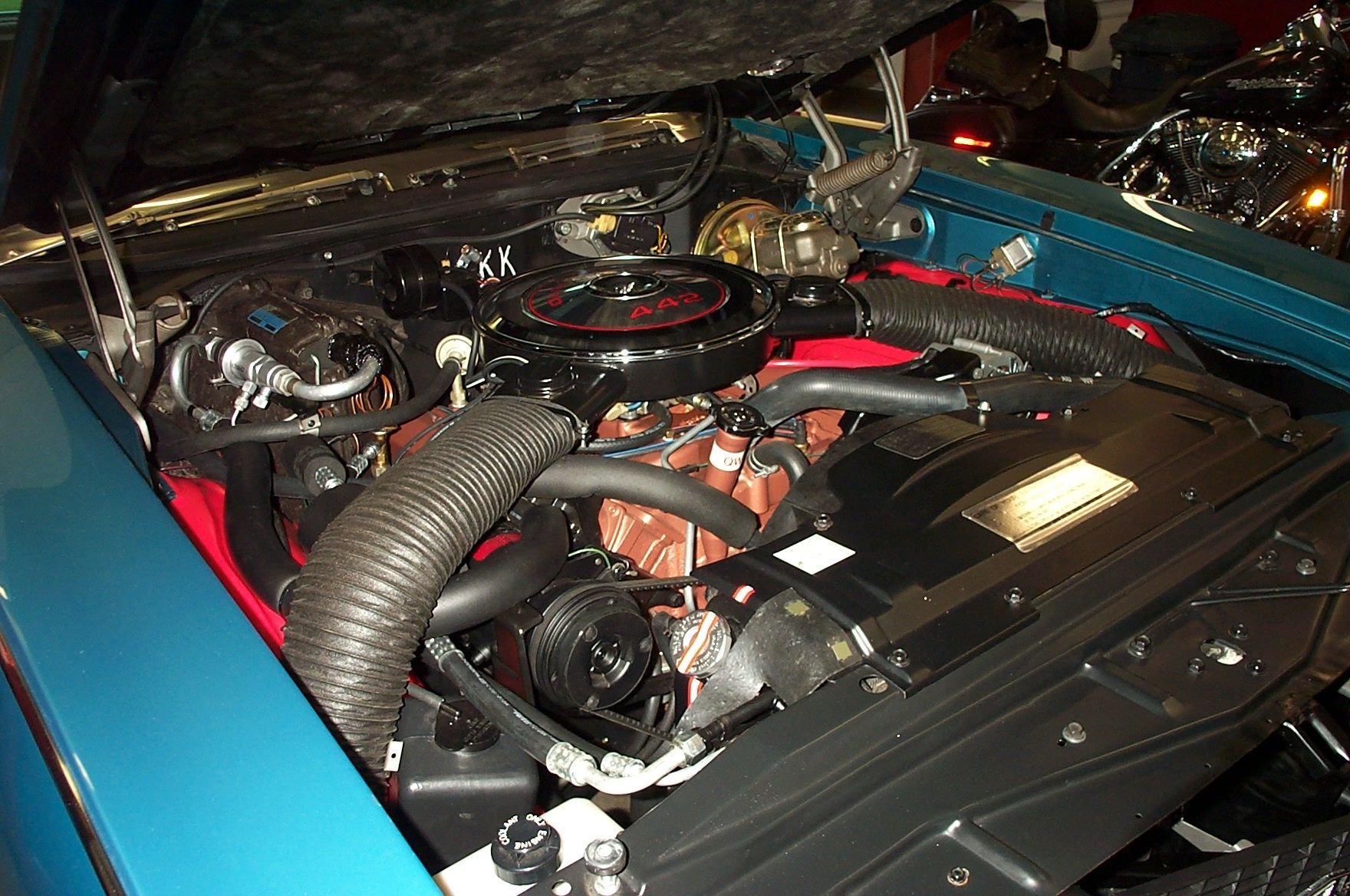

I bought one from Napa for my '68, Since I was planning to add OAI I was limited to where I could put one. The Napa one is probably Dorman & it was only $8! It comes with a plain black vented cap but I had a new later model GM cap in my stash so I used it. The tank has 3 mounting tabs so I had to drill 2 small holes in the upper core support tie bar & make a small bracket that bolted to one of my headlamp surround bolts for the bottom tab. It fits in the space perfectly & has a factory look to it plus no antifreeze can leak out that my cat could lick up! You can just see it in the lower corner of the pic.
Rob, we may have spoken on this before, but I forget, could you comment on how the OAI hose, the hood, and the AC compressor get along in terms of clearance? I'd like to do similar on my 67.

Koda, I'm using an Edelbrock O4B intake that raises the carb at least another inch really helping the fit of the OAI hose over the a/c. Other than flattening the right side hose a little on the bottom , everything fits fine even the hot air tube for the air cleaner.
