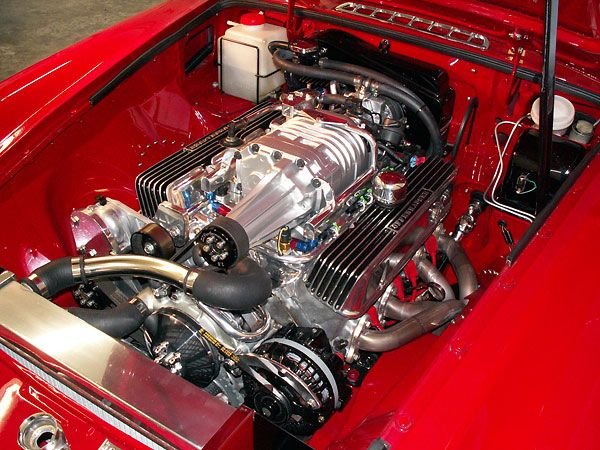

Actually, not so much of a problem. The 62-63 Skylarks came optional with the 198 Buick V6, which was the precursor of the 3800. Unlike the 64-up V6, the 198 used the same bellhousing as the 215. Later ones were BOP, and the Series II/III motors went to the 60 degree metric bellhousing. I suspect a GN drivetrain won't be cheap. Another option is the 3800SC version used in FWD cars. Those were 260 HP stock. The two problems are 1) the 60 deg bellhousing limits you to either a manual trans or the 700R4 used in F-body cars and the S10 trucks with the 2.8 V6 and 2) the throttle body on the supercharger hangs out over the bellhousing and hits the firewall.
Here's another option, one of those superchargers on a 215:
