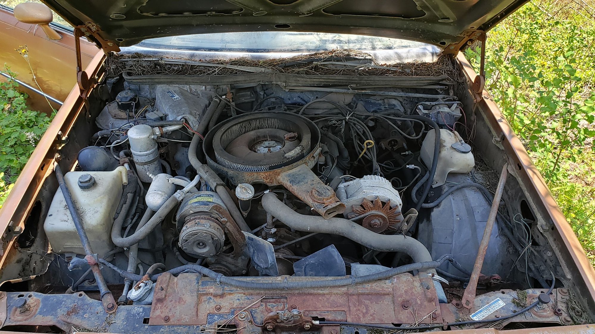

So I acquired a beautiful 79 cutlass supreme Diesel.
Haha. Sometime in its life it was nicely swapped with a gas motor. I am told its a 455.
They left the original brake system in place, only I am less a master cylinder. Buying a master cylinder and booster package would be best. Yet do I buy single diaphragm or double?
The exhaust pipe is directly under the oil filter. Move the pipe or relocate the filter?
Should I remove the air conditioning or rebuild it next spring?
Is there a way to identify the rear axle?

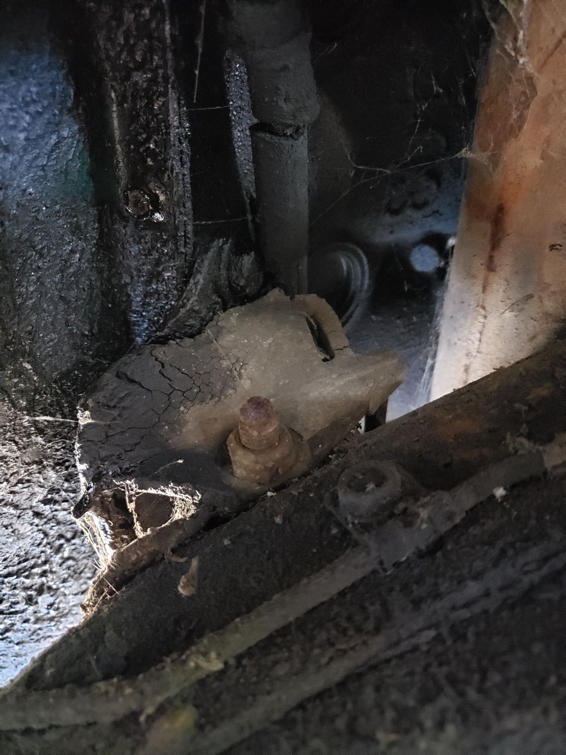

I think the the motor mounts need to be replaced.
What causes an engine to lock up?
Could I, should I, just give it some starting fluid and go for it? The engine has a Quadra jet, clutch fan and a alternator larger than the one on my 360ci truck.
Assistance, advise and opinions welcome. Thank you for your time.

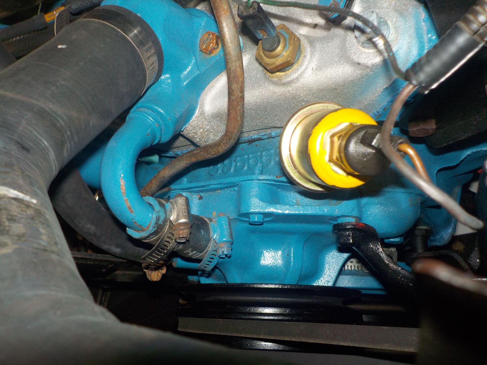

I'm pretty sure the motor is a 403, not a 455. If you look at the picture of the motor mount you posted you can see the numbers 403 cast into the side of the block. There should be a ledge between the water pump and intake manifold that has the actual block casting numbers on it. Will be probably be 557265 or 554990. See my photo for example. If it was mine, I'd redo the entire exhaust system and move the pipe away from the oil filter. No need to relocate the filter. I'm not sure where you live but I'd keep the A/C and have it serviced, especially if you're in a state where the summers are very hot. Your rear axle is (probably) the stock 7.5 inch one that originally came with the car. The only ratio available with the 260 diesel and automatic trans was the 2.41. There is a code stamped into the axle tube, on the top passenger side somewhere in the middle of the tube, that will tell you the ratio. That's assuming it hasn't been changed by a previous owner. As for brakes, I'd stick with the stock master cylinder that was originally used in the car. The stock braking system was more than sufficient for everyday use with these cars.
It looks like the car has sat for a long time without use. I'd be hesitant to try to start it without going thru some steps to ensure it won't have some serious problems later. There have been numerous discussions on this site about it so I won't go into it. Just search for it.
The 403 V8 is a nice motor. They used these in a lot of the full-sized cars from 1977-79 along with the Trans Ams.

Sorry, forgot to add the photo.
This is a picture of the Olds 350 V8 in my 1979 Hurst/Olds. You can see the casting number 395558 underneath the fuel line.

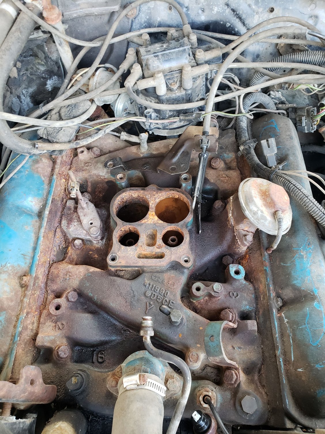

Block number is 557265 4B
Also I think the motor is leaning to the passenger side.
May have to rebuild the carb before I try turning it over. Looks like some moisture got on the engine.

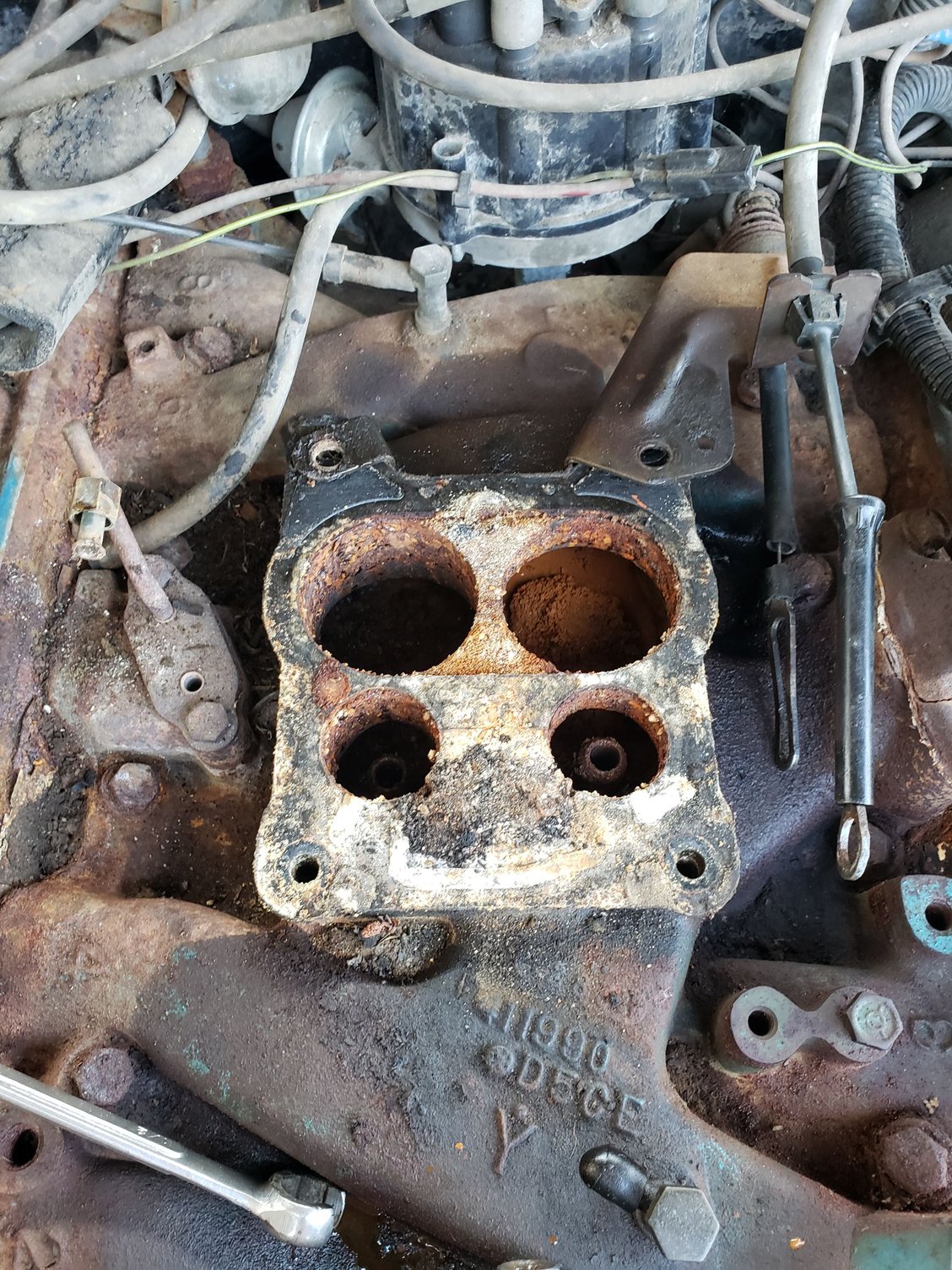

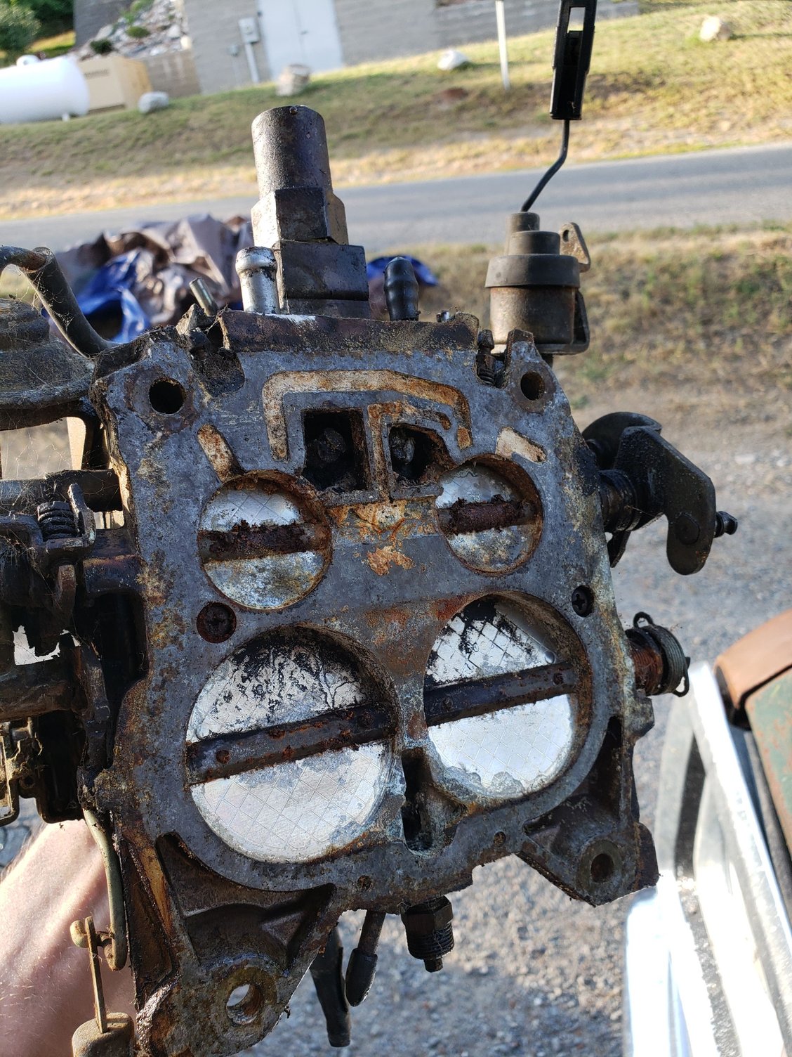

So the carb was frozen and so I took it off. Came off easy. I don't like what I see underneath.
Is the engine save-able?
I am going to vacuum out what I can.

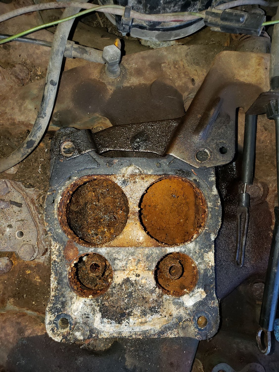

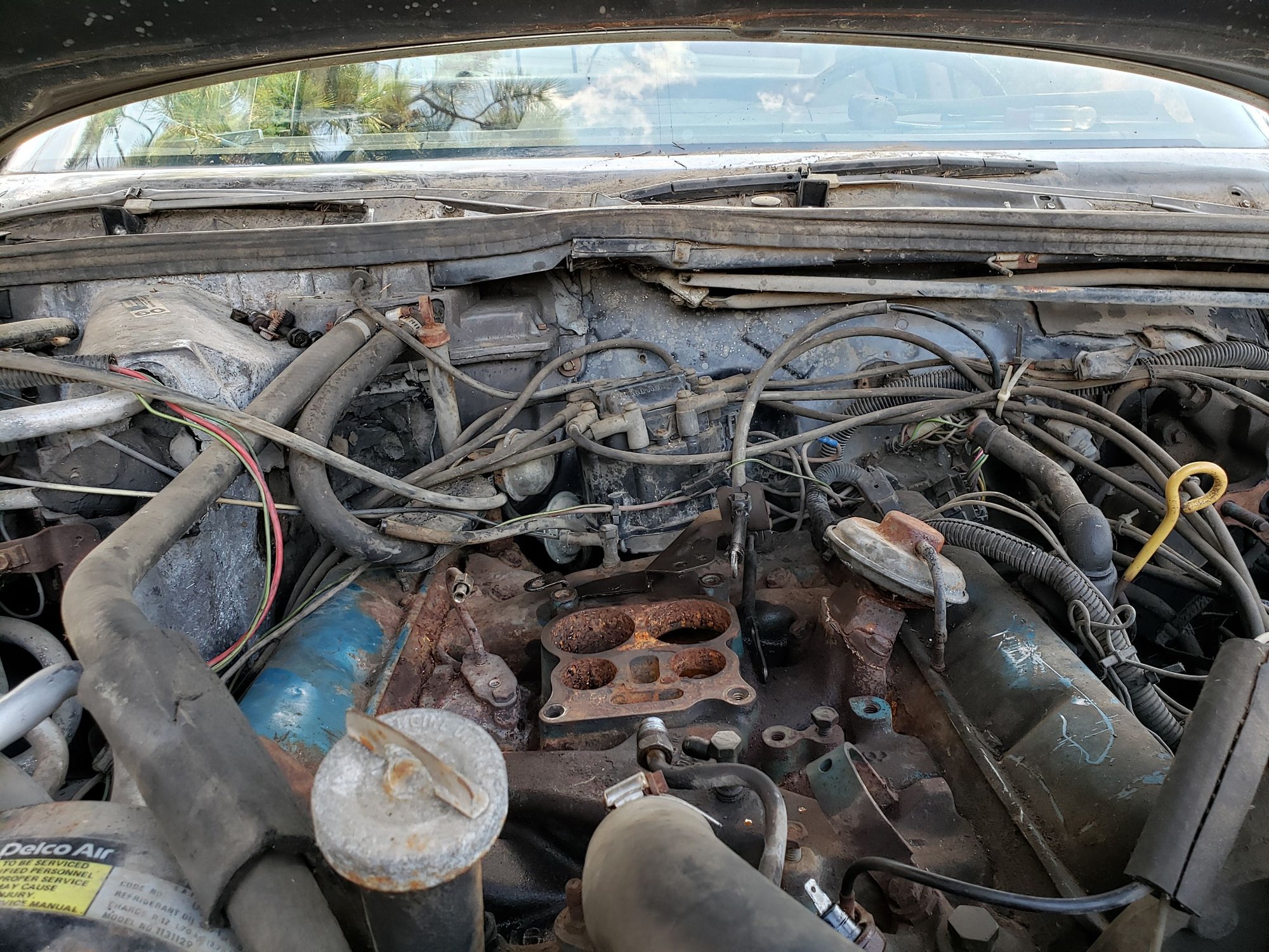

Vacuumed it out and now it doesn't look bad.
Should I pull the valve covers? Need to anyway for new gaskets.
Perhaps a new intake manifold like 79cutlass said..

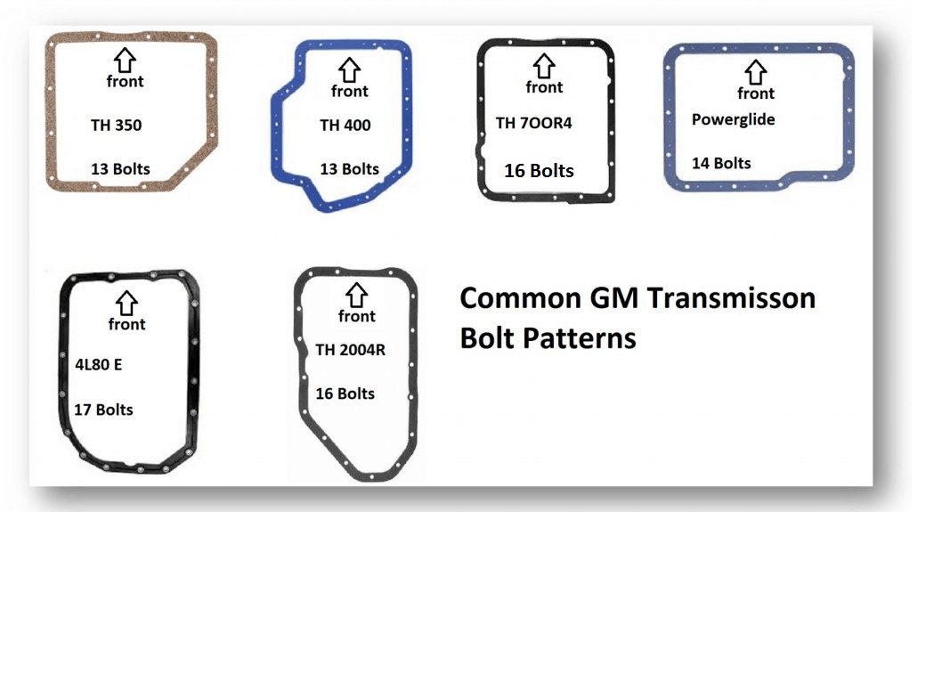

How do I know what trans is underneath?
Would it be in the vin?
where is it marked on the Trans.
I got the car for free,, paid 200 to drag it home and the plan is the get it running. My truck is getting worn out and he doesn't get good gas mileage either.
Old Aug 18, 2020 | 06:56 PM
69CSHC's Avatar
Posts: 2,072
This should help.

Looks like the TH350
Old Aug 18, 2020 | 07:26 PM
69CSHC's Avatar
Posts: 2,072
More precise...

Looks like #3 the TH350

If that's the case, you are set. A TH350 in good working order is a perfect pairing with a 403 particularly in a mid size car.

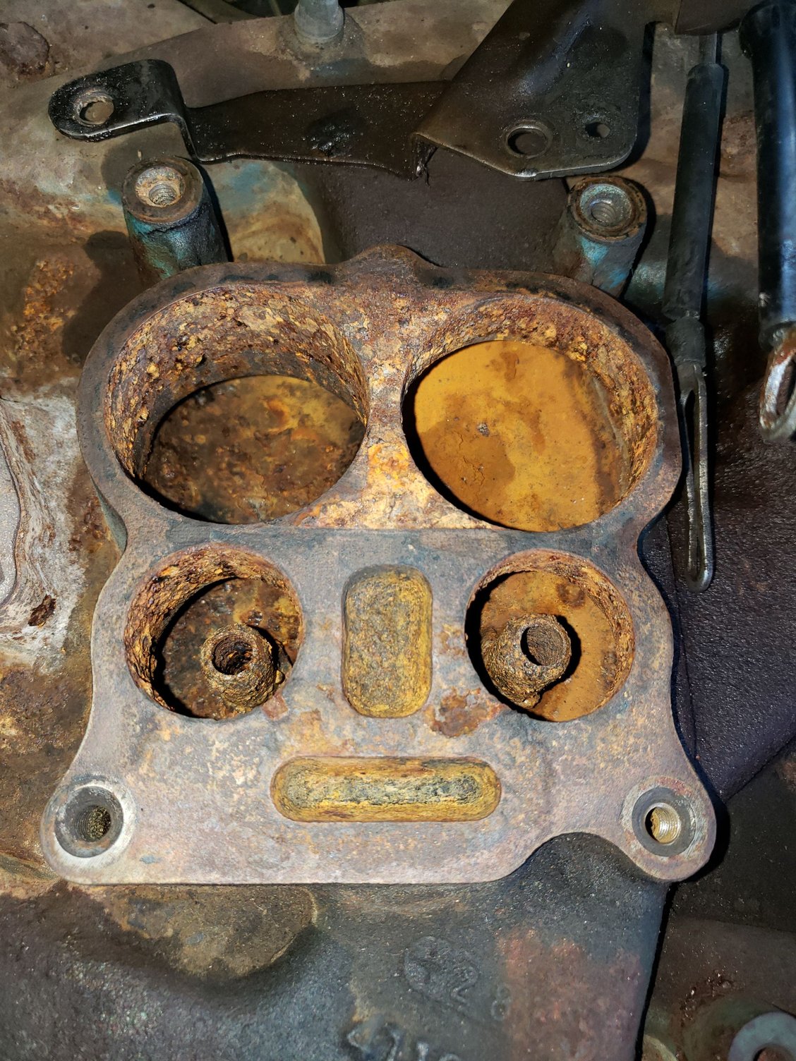

That is a LOT of crusty rust inside the intake manifold. If it were mine, I would pull the valve covers and the intake. You can get gasket sets for cheap on ebay and Amazon. There are three major options for the intake. Soak the whole thing in Evapo Rust for a few days, use a wire brush in a drill to clean everything out, or straight-up replace it. Looks like you will be needing a new EGR valve too. You don't really want all that rusty scale going through the engine while it is running. If/when you remove the intake manifold you will probably find some crusty dried oil sludge in the lifter valley of the block and that can be vacuumed out fairly easy but if you are doing any kind of reliability refresh, it is a worthwhile MAW (might as well). Also, if the crank will turn, try turning it bacwards and forwards with the distributor cap off to find how much slack is in the timing set. If the engine is still factory original, the timing gear on the cam has synthetic teeth on it that WILL deteriorate and ultimately fall apart. Again, not an expensive repair but well worth the time and money if you are going to refresh the engine. The MAW's have you... Welcome aboard!

Best of luck with this project. But also, be sure to check the rear frame rails from the tires back to the bumper. If they are rusted/rotted out this is an extremely expensive fix if you can even find someone who will do that work. This is a big time issue with these cars.

From the pics, it appears that engine has had water leaked into it for quite some time. I really doubt that engine would ever turn over and would never run without a complete overhaul. Your best bet is to pull that engine and either replace it with a known good engine or have this one rebuilt.

What he said.^^ If mine I would get a bore scope and check each hole first for issues (rust) before I spent a dime on anything else. You could be looking down the hole of a coal mine. Might be cheaper to put the money into your other ride..... Just my thoughts....Tedd

I agree with Roger, as much as it pains me to state this, I think IMHO this car is beyond rescuing per the photos. Motor, Trans, possibly the frame, all point to bad things around the corner. If you are looking for a good example of one of these cars, I know of a great one (a blue 1979 Calais with rare white interior and the chevy H 305 motor) for sale in Hartford, CT, I would buy it but my stable is full. Best to get something ready made and ready to go NOW then to sink tons of dough on something unknown.

Before sinking a dime in it, look over the frame rails in the back. I live in the rust belt, it was common to see 4x4 posts bolted to home made bumper brackets because the original bumper rusted and fell off. If the frame is rusty, it’s going to be expensive to fix.
