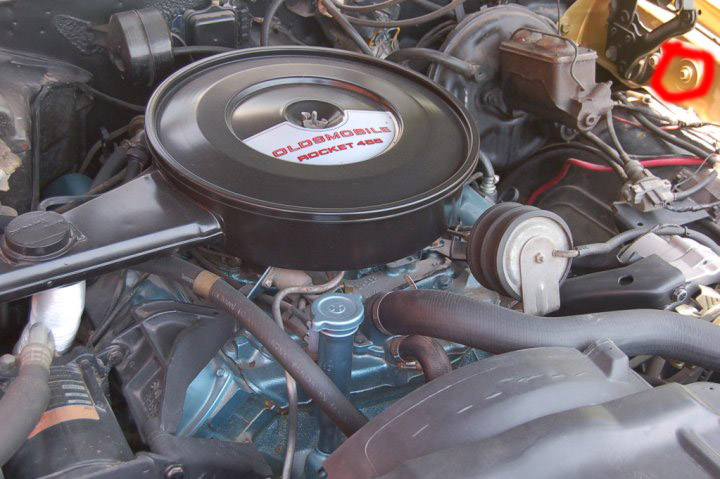

Hey Guys,
I have a 70 Cutlass I've been working on for a few years, and have never been able to figure out if it is a legit SX or not, hopefully I can get some feedback
When I bought the car, the body / interior was in good shape, but under the hood looked like it had not been touched.. in many many years. Lots of rust scale etc, I'll try to attach a picture
Car has a 455, and had a 2bbl carb when I got it (which seems consistent with many 70 SX's). After removing all of the accessories to detail the engine, I was able to get a the stamp pad and clean it off (lots of rust scale)... The engine block # matches my vin number, but the engine number is stamped twice on the block, kind of offset.
The only Cutlass-vin code 70's that would have a factory 455 would be an SX... right?
Anyone heard of a double-stamped number on a block?
Of course, no build sheets with the car, none under the seats or over the tank... Car has dual exhaust w/bumper cut outs (easily added)... not the original trans so thats no help...
If these attachments work, one shows the engine before I cleaned it up + the layout, and one shows the vin stamp pad
Any thoughts would be appreaciated!
Thx - Dan

I actually have the 70s SX with a 2bbl coupe. One not is the extra fender brace that is only located on the coupe.
Here is a picture of what I'm talking about. If you take off the fender, you should be able to see the brace, if not, just check for the brace.
Of course, see if you have the side badging. You should have the SX just under the 2nd S of Cutlass. There is more information at sx455.com
Thanks Joffroi. The car is a convertible - do those have the braces you mention?
The car was cloned to a 442 by previous owner (its the blue car in the orig post) so no SX badges to look for. Previous owner indicated he was familiar with the car locally (as an sx badged cutlass) in michagen for about 10 years before he bought it in 2000, and as it needed paint... so he went the 442 route. He did not know if it had the original engine, that was some digging I did.
Might just be an unsolvable mystery w/o paperwork
convertibles do not have the braces. This is going to be tough for you to find, I would maybe ask the president of sx455.com for help here.

Also, if you can get the inner fenders out, look to see if the holes have been filled on the fenders where the SX badge would be...this wouldn't prove either way, but could help answer your question about it's authenticity!

I know everyone has always said that the convertibles do not have the brace but mine does. when I got the car (28 years ago) the car had never been apart and had only had one real crappy repaint. from what I know of the car it was all original when I got it and that was back before anyone knew what they were. in '82 when I got it it was just a used car. it is an early build and was a 2 bbl car also.

Thanks. No braces on mine, just an empty hole....
Great idea... I took a look w/ a flashlight through the door jamb with the door partly open at the inside of the fenders where the SX emblem holes would have been and saw... patch panels - both sides... oh well!
