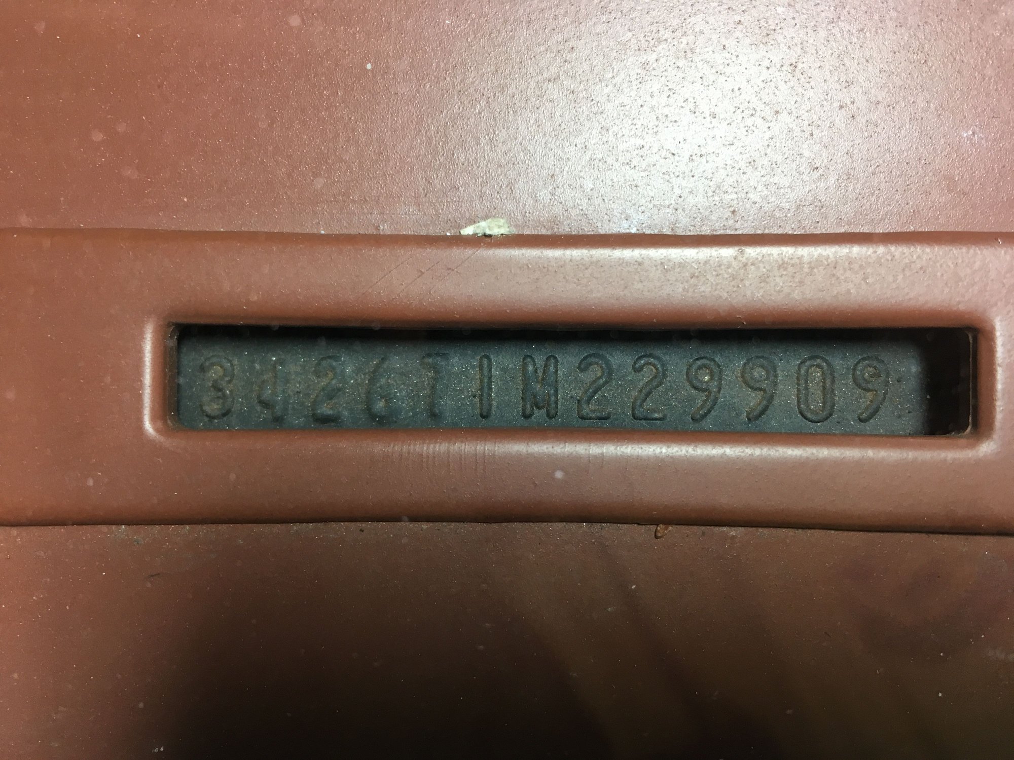

Post both a picture of the Cowl Tag and the VIN. Post a picture of both the engine VIN derivative number & the transmission VIN derivative number. Then, if you want further definitive assistance we could assist by evaluating crash/crumble ridges on inside of front fenders, rear ends, heads, etc.

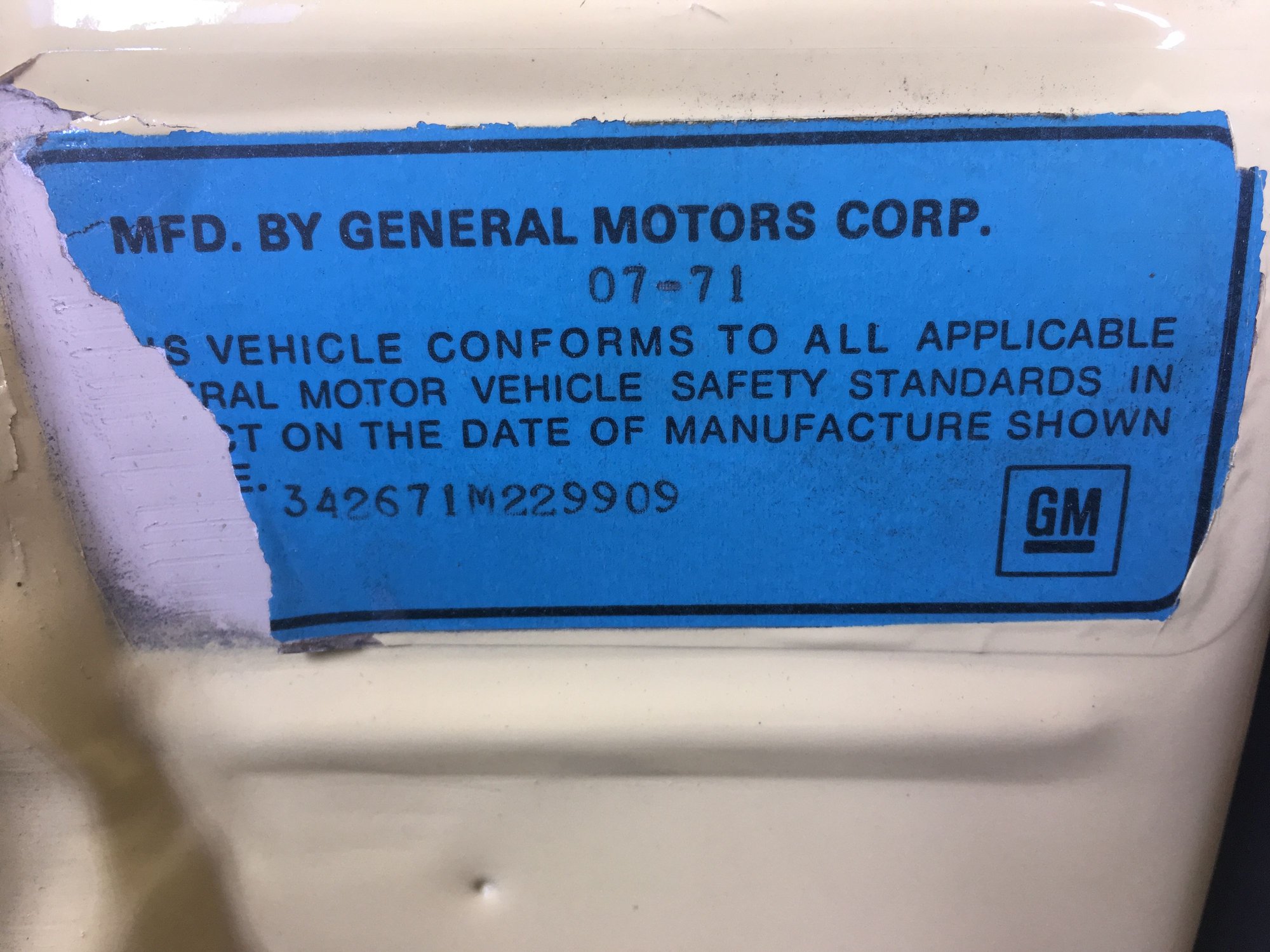

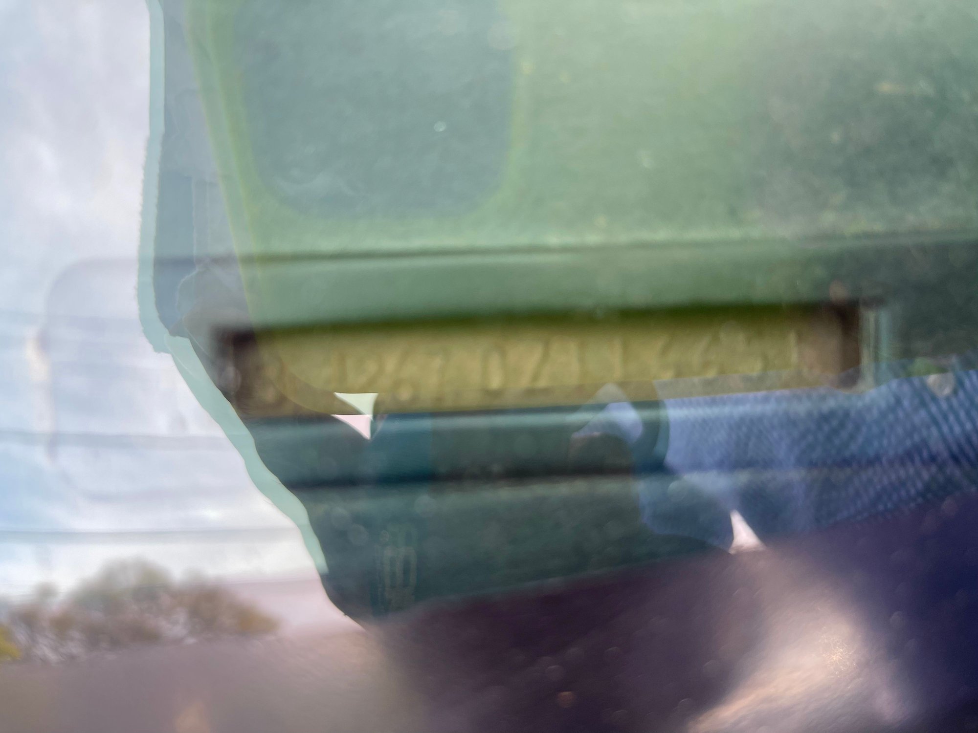

It’s being shipped to me by Wed but for now the VIN I photographed is attached. What other locations do I need to check? At this point I have to use the VIN to register unless the other areas come back with something different.

Old May 16, 2022 | 07:54 PM
Posts: 26,019
On my phone so I can’t see the image clearly as it’s modestly blurred. I’d have to view it on my PC monitor. Others can probably view it faster than me.
The VIN located on the title is the VIN you have to use to register the vehicle. The title VIN needs to match the VIN plate on the dash. If they do not match, you have an issue which requires further attention.
I’ll take some other photos after I get it… but the VIN plate as mentioned another gent and myself decoded it today to be 342670Z….
Old May 16, 2022 | 08:17 PM
Posts: 26,019
Here are both my driver's side door and dash VIN number placards. Mine is a 1971 CS convertible. Your VIN is identified as a 1970 CS convertible built in Fremont (Z), California. Mine contains the letter "M" (built in Lansing, MI).
3=Oldsmobile
42=Series (Cutlass Supreme)
67=Convertible
0=Model Year (1970)
Z=Fremont
Old May 16, 2022 | 08:26 PM
Posts: 26,019
I guess the important question has been answered - your vehicle is a 1970 CS convertible built in Fremont, CA. The Cowl Tag and/or the driver's door placard can assist regarding the actual build date of the vehicle. As has been suggested already, numerous parts/items are interchangeable between model years. In 1971 crumple/collapsible/ridged front fenders were mandatory - they are identified by raised ridges on the inside (top) of the fenders. However, those fenders began to be built in 1970 and 1970 vehicles were produced w/ the ridged fenders mandatory in the 1971 model year. Depending on how deep you believe you want to go on addressing authenticity of 1970 or 1971 parts/items, you could begin your own investigation(s) regarding engine, transmission, rear end, etc. But again, your VIN validates 1970 CS convertible.

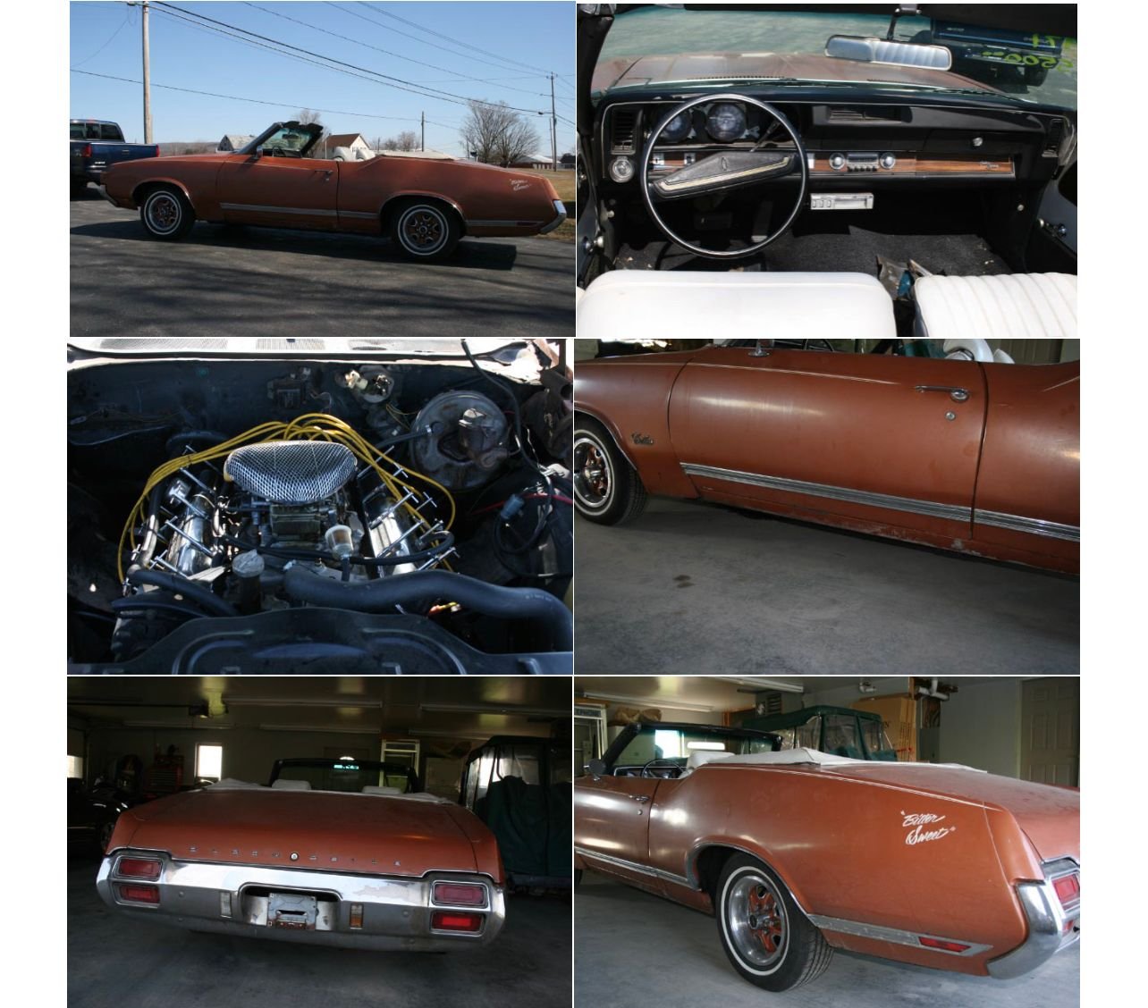

3=Oldsmobile
67=Convertible
0=Model Year (1970)
Z=Fremont
I’ll check the door location after delivery.

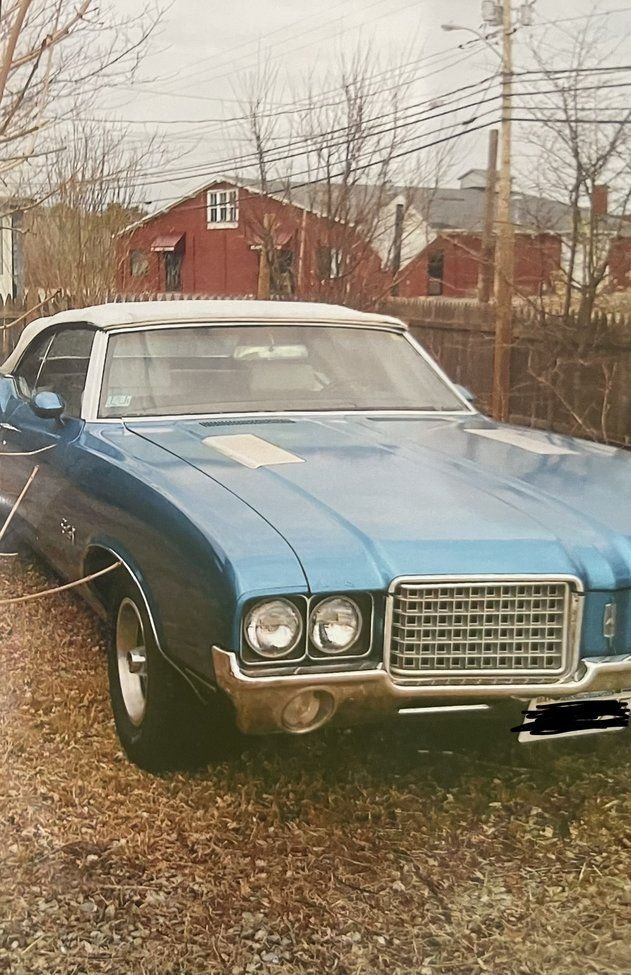

We agreed yes the VIN indicates it should be a 1970… but as mentioned, the front grill/hood and front/rear bumpers and the bucket seats align with the 1971… which is why I asked if in 1970 you could get those options. One theory is that there was an issue and depending on time and sourcing the front clip replaced and that to be consistent, the rear bumper as well.
pic is from the guys photo album before colors were changed.

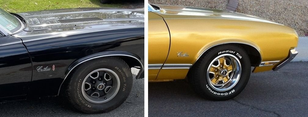

BTW, just for added clarity, these are the type fenders (crash/crunch/collapsible/ridged) mandatory in 1971. They began producing them in 1970, depending on build date of your vehicle, it's possible a 1970 CS could have been built w/ these style fenders. The 1970 model year fenders would have normally not contained the ridges.
That could be the explanation! You definitely

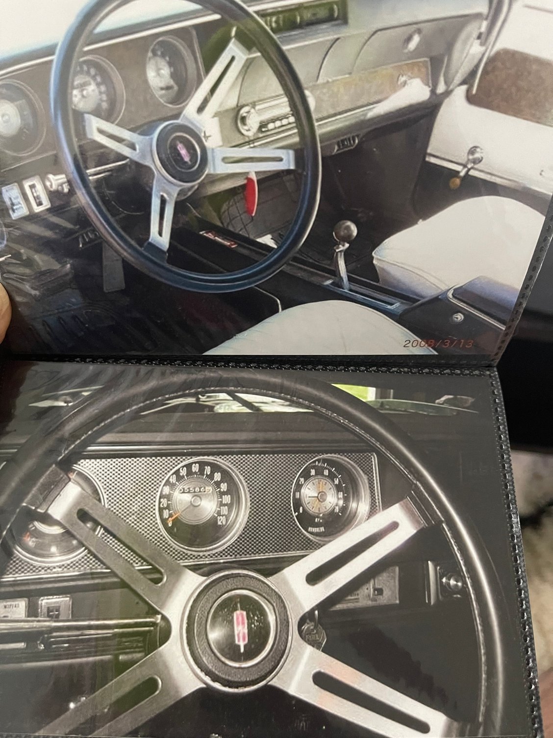

1970 only mirror on the door. Does it have burl wood grain detail in the interior? I also noticed grills and headlight bezel are 72. What taillights does it have? My guess is it’s an original 1970 restored with incorrect parts.

Hood is correct for 71 or 72 Cutlass S or 442, not Cutlass Supreme. Bumper is 71 or 72.
It has 1971/1972 bumper. The interior was burlwood. Here are photos from his album… glad I didn’t let him keep it! He was obsessed with black and blacked out most of the interior and bumpers. LoL. But it looks nice!

Burl is correct for 1970. Bumper is 71/72 and taillights are 71
I can certify you knowing your stuff because there is the “S” symbol on the fender which leads me to believe the entire front clip was replaced with that of a 71/72 S. The seller mentioned something but wasn’t clear & he wasn’t an true olds enthusiast and originally got the car from a sibling prior to the “blacked out” look

Old May 16, 2022 | 09:42 PM
Posts: 15,409
The VIN clearly shows it is a 1970, and the front end has 1972 parts (grilles and headlight surrounds), so this is obviously a "repaired" vehicle using the parts from a donor car. There is no way it is a 1970 with 1971 parts from the factory, since those are 1972 parts.
Note that the core support is differfent between the 1971 and 1972 models due to the grille differences, so lift the hood and take some pics and someone will be able to tell you if it's a 1971 or a 1972 core support (I suspect 1972 based on the parts I see in the picture).
Yes, it makes sense that the front clip was replaced with one from a 1972 S based on the grille and headlight surrounds.
Also note the 1970-1971 only, Supreme specific, wide lower side molding is missing, and the fender openings have the non-Supreme trim that goes all the way down to the bottoom of the fenders. The Supremes have shorter trim that ends at the wide lower side molding.
