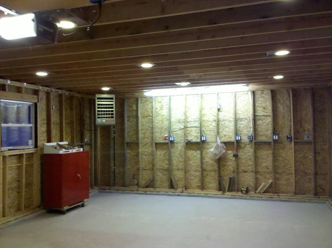

I have a 50,000 btu modine propane heater in a 20 x 30 garage that works great. Picture was taken when the garage was first built. I also use a dr infrared heater sometimes, just a lot easier and works really well up to 600 sq ft, it is 240 though.

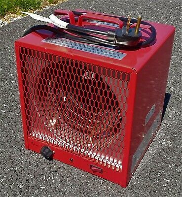

Thanks for everyone's input , I bought a Newair 656 240 electric garage heater (plug in - I already have a Mig welder outlet) . Plan on getting a 120v forced air garage also . I will warm the garage with a propane salamander I already have and shut it down and see if I can keep the garage at a reasonable temp , using the salamander as needed ...

That new air is similar to my dimplex, the NA is 19k btus the dimplex is 13.5k btus.
i do the same if its cold, blast the propane for 20m then run the electric.
it helps alot if your space is insulated.
No way that’s a real car guy garage!!! Never seen one that clean, or empty!!!

Posts: 26,014
Matt -
You may have missed the statement:

Posts: 6,104
Matt -
I did miss that.
I’m guessing it didn’t take long to fill, probably less time than it took for you to wish you built a bigger garage!!
